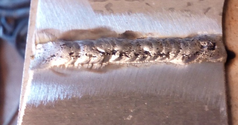

It’s the oxide layer I believe that can absorb moisture from the air. All metals sweat water when you heat them up. It’s not from the core it’s from the oxide layer on the surface.I'm wondering does keeping the filler in a damp atmosphere actually allow the metal to draw in moisture or does the moisture cause a surface reaction on the filler that affects the weld?
I'm not suggesting that the problem can't be mitigated by keeping rods in the warm, I just find it very hard to accept that a solid rod can fill with moisture.
A wipe with scotchbrite or stainless wire wool has always been good enough for me if I suspect a dirty rod, I notice that the filler is 5356 which has magnesium in it and is more prone to contamination if all the other parameters such as torch angle, gas flow, travel speed and current are not quite right, this is why I generally use a lens with ally,
It would be interesting to see if the same problem occurs with a 4043 filler

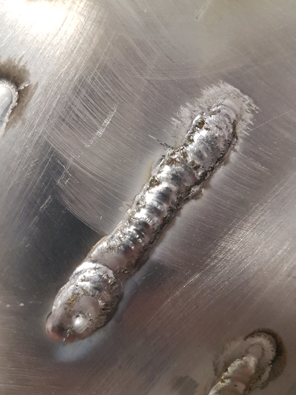

Well just went out and bought brand new 4043 and here's the result I've no idea what's going on, I can say I'm seeing the arc turn green as I'm feeding fillerView attachment 138546
Make sure that when welding the hot end of the filler stays within the gas shield.
A hot rod exposed to atmosphere will oxidise, then with the next dab of filler you shove that oxidation into the pool.
Also seeing a colour change as you feed filler suggests that you are touching down with the tungsten or touching the filler to the tungsten, post a picture of your tungsten after welding a short run.
You might also try running a bead without filler, if you still have contamination then it points to a torch or gas problem
im stabbing the filler into the leading edge of the pool quickly
i had suspicion that the bottle was contaminated when i got it first but managed to get it to weld good on stainless
Christ that’s looking a lot worse.Well just went out and bought brand new 4043 and here's the result I've no idea what's going on, I can say I'm seeing the arc turn green as I'm feeding fillerView attachment 138546
You’ve got a gas problemI've done bother extremes of argon to try clean it up but that weld would be around the flow your stating,
I'll check all the leads and and torch tomorrow and then do some stainless
