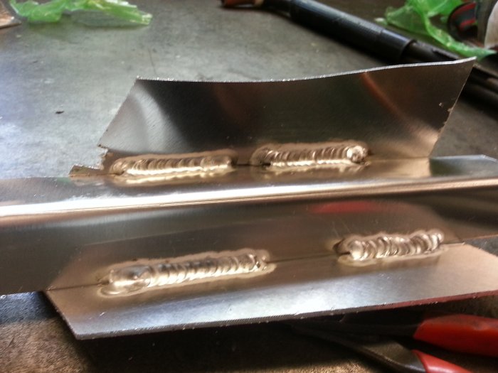

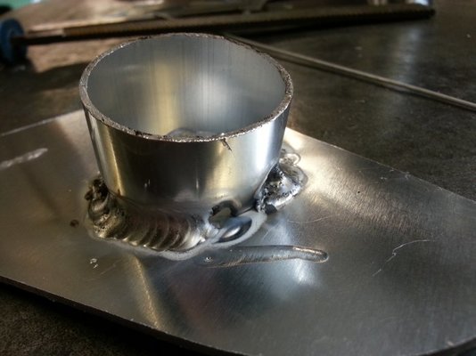

). Turns out my balance was set to max clean! I've switched towards the other end of the scale and now the tungsten keeps a small ball and the arc directs into the corner. Can manage autogenous tacks now. I think the tungsten was getting too hot before.
