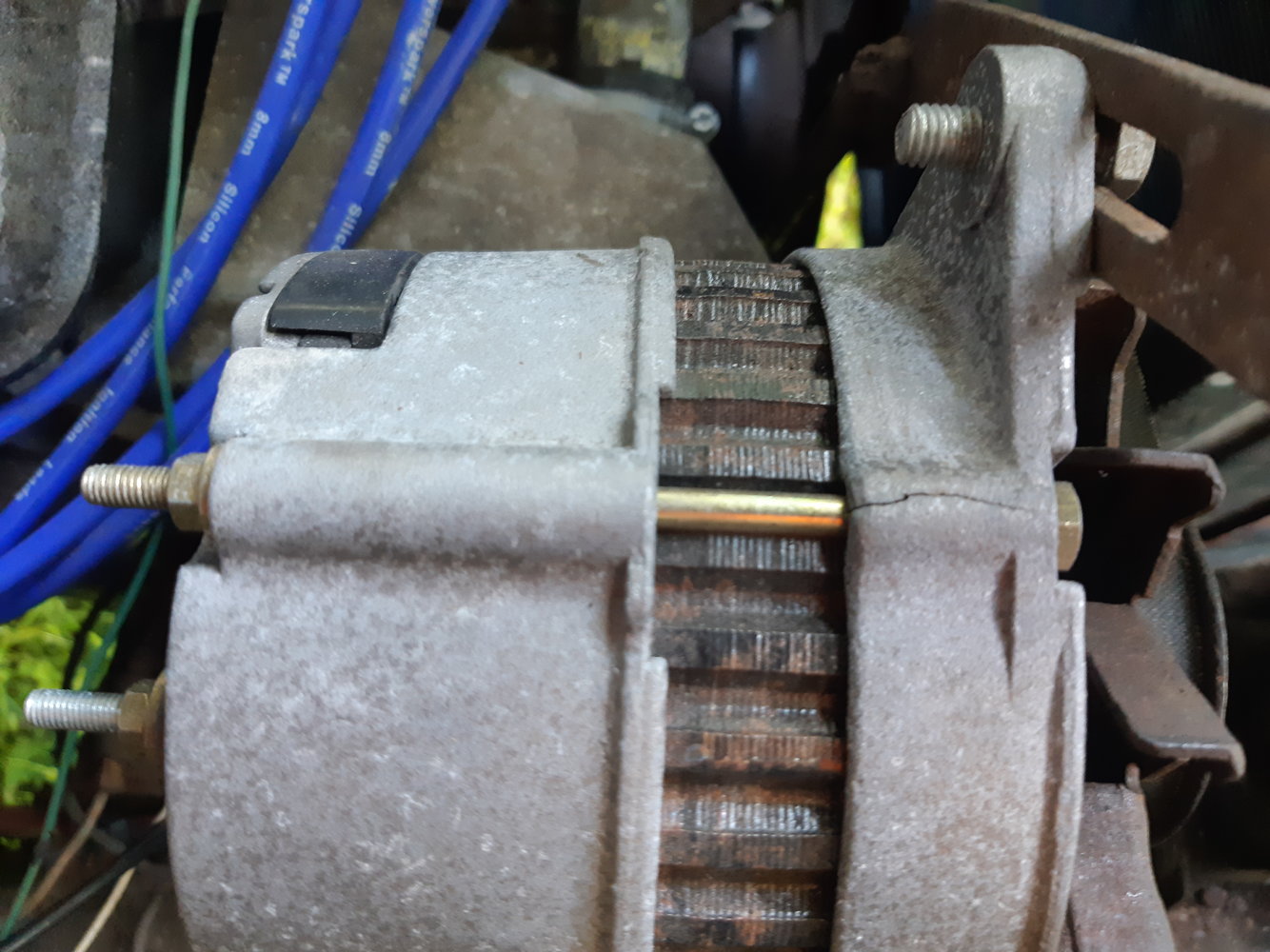

me neither even it it broke they and the other bolt come out they still need lots of bashing to seperate!I wouldn't touch that,
I'd keep an eye on it occasionally.
On a lot of alternators they make the bolt too long like that. So, on certain applications, you can use it as a binding post for an earth lead.With that much thread hanging out the end of the nut I’d wager that’s not an original fitment bolt.
Shouldn't there also be a washer under the head of the adjusting bolt, not that It'll make much difference to the crack mind.so pretty disappointed. landrover alternator is cracked. its only about 2yrs old. engine has had little use.
so any ideas od a permant semi perment fix.? new body . resin
