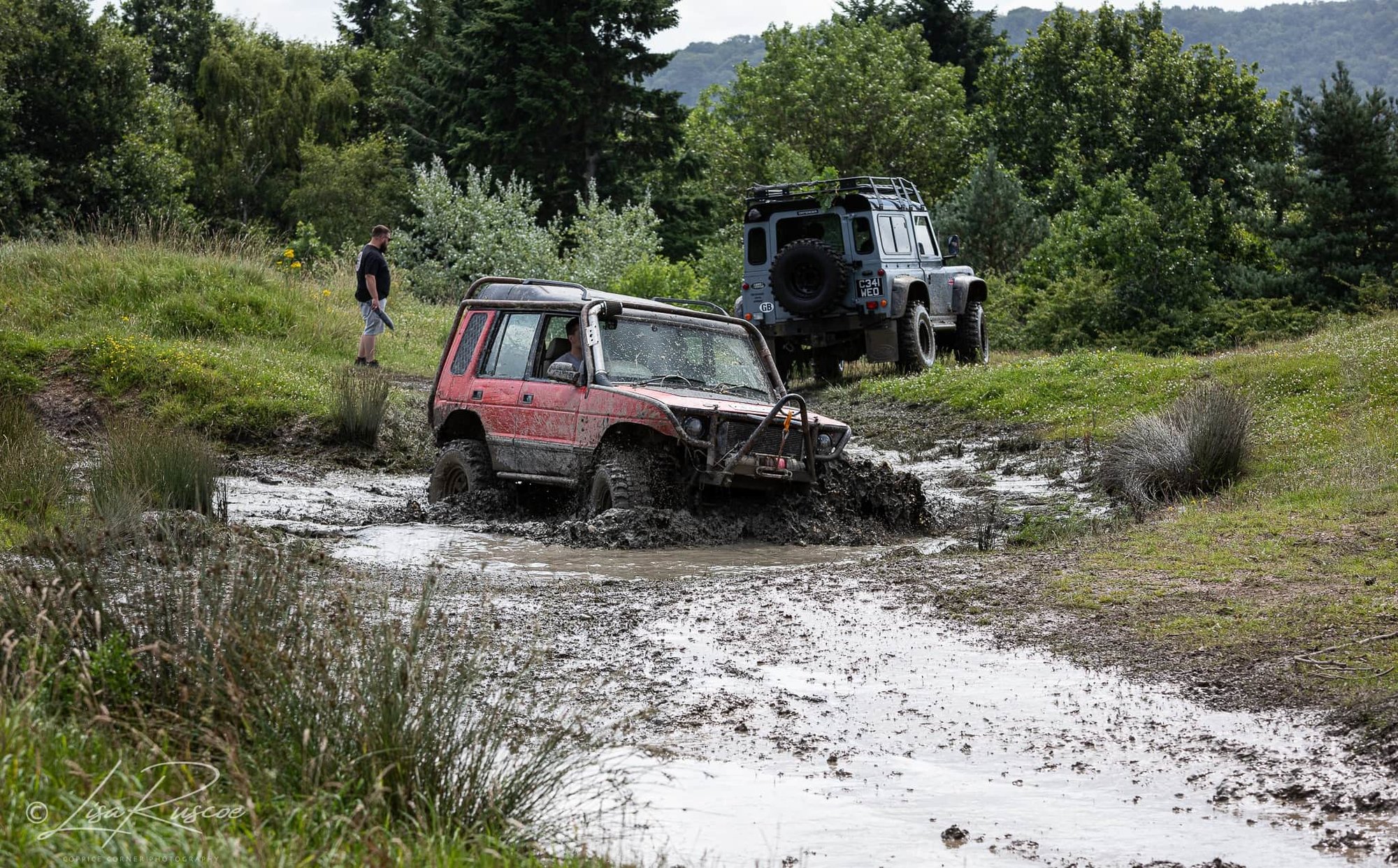

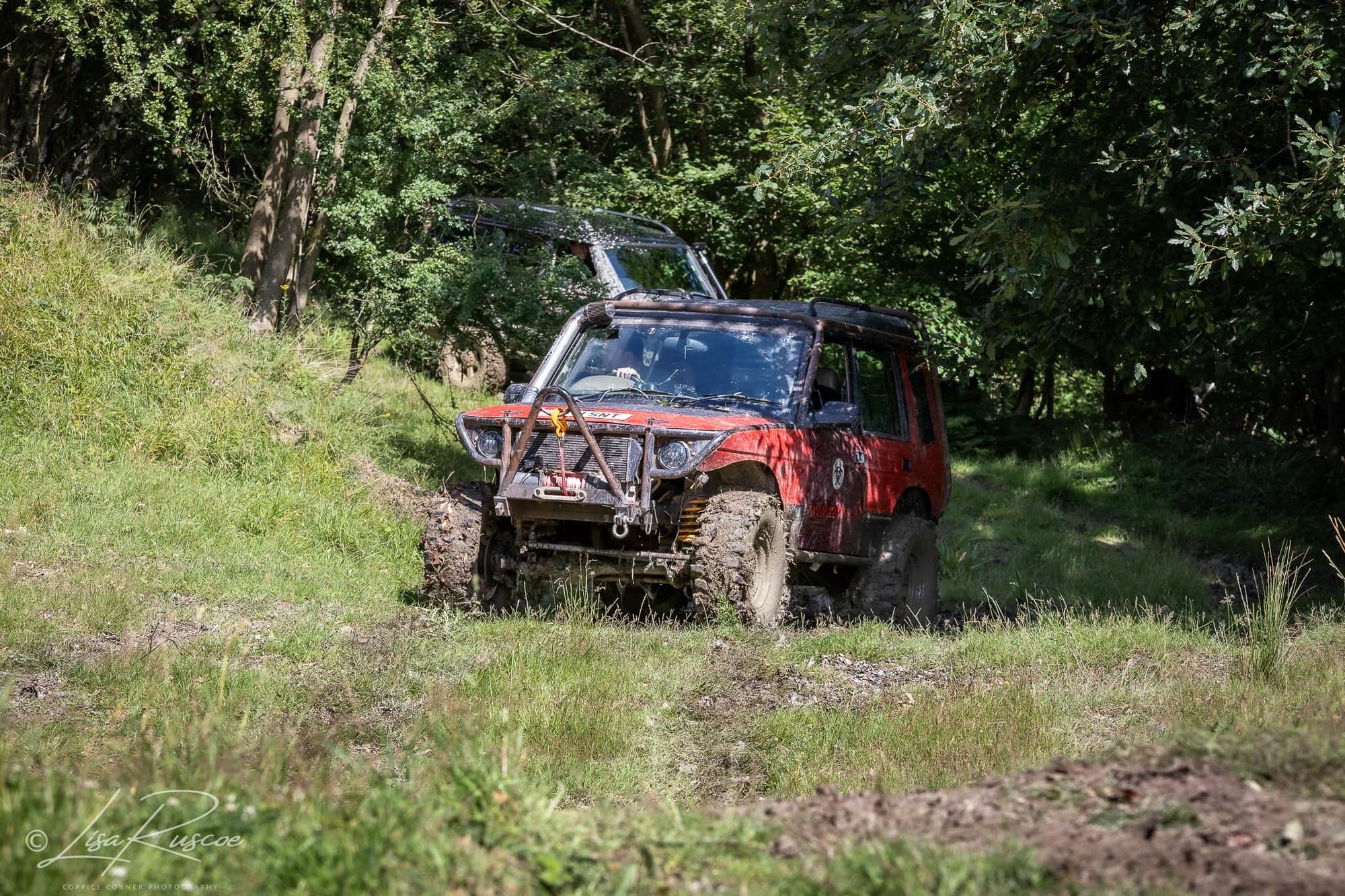

My welds have saved my life multiple times. The red disco in the pics is my comp truck. I winch challenge, so not racing in the normal sense but it's against the clock. My roll cage is Tig welded, my inlet system is Tig welded, and the tube work has been done by me. I've fabricated the adapter plates and mounts to fit the BMW m57 engine as well as the suspension mounts, my suspension links are also Tig welded. I drive this both to and from events every time.

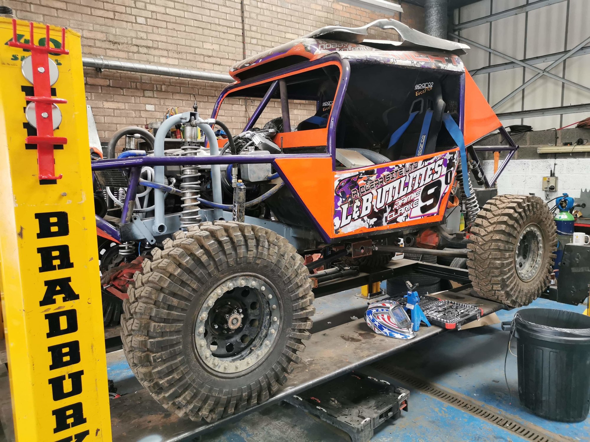

The orange bowler is a build I'm doing for a customer. It's an om606 fitted by me, mates to patrol transmission, with patrol axles on 4 link suspension front and rear, all welded by me with the Tig. All sitting on 37" tyres. I've again made the charge cooler system myself, exhaust myself and pretty much everything else has come from me on it as well.

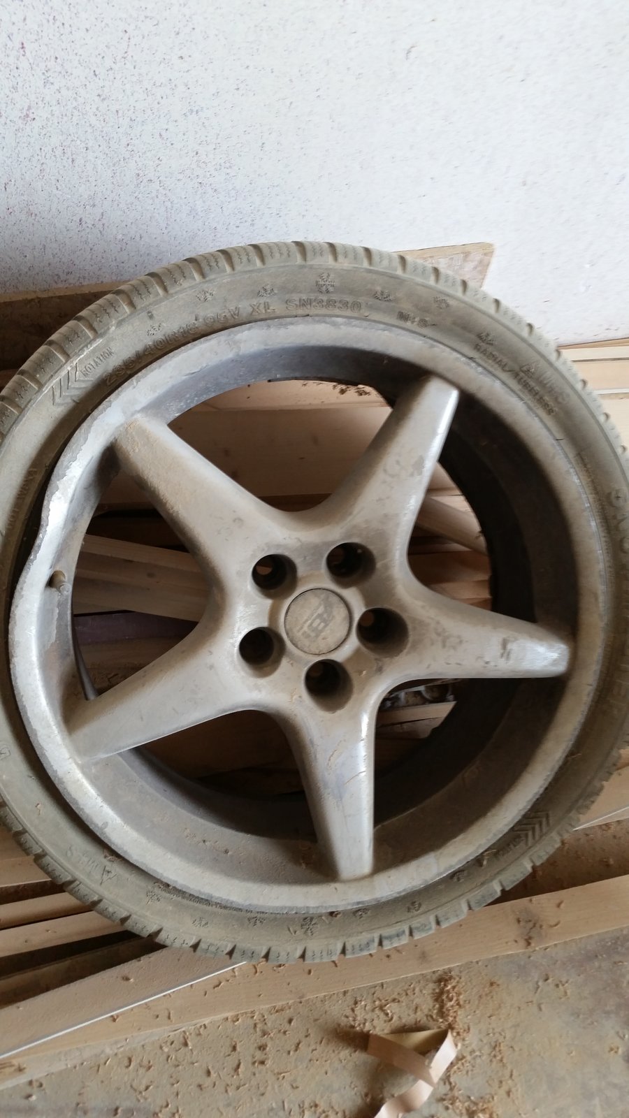

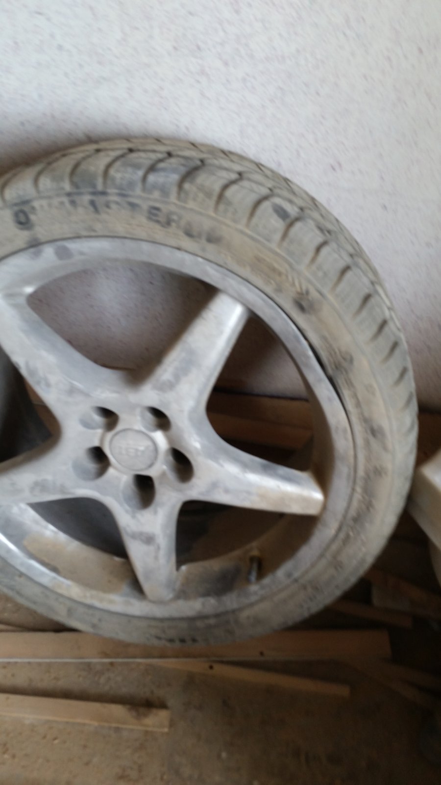

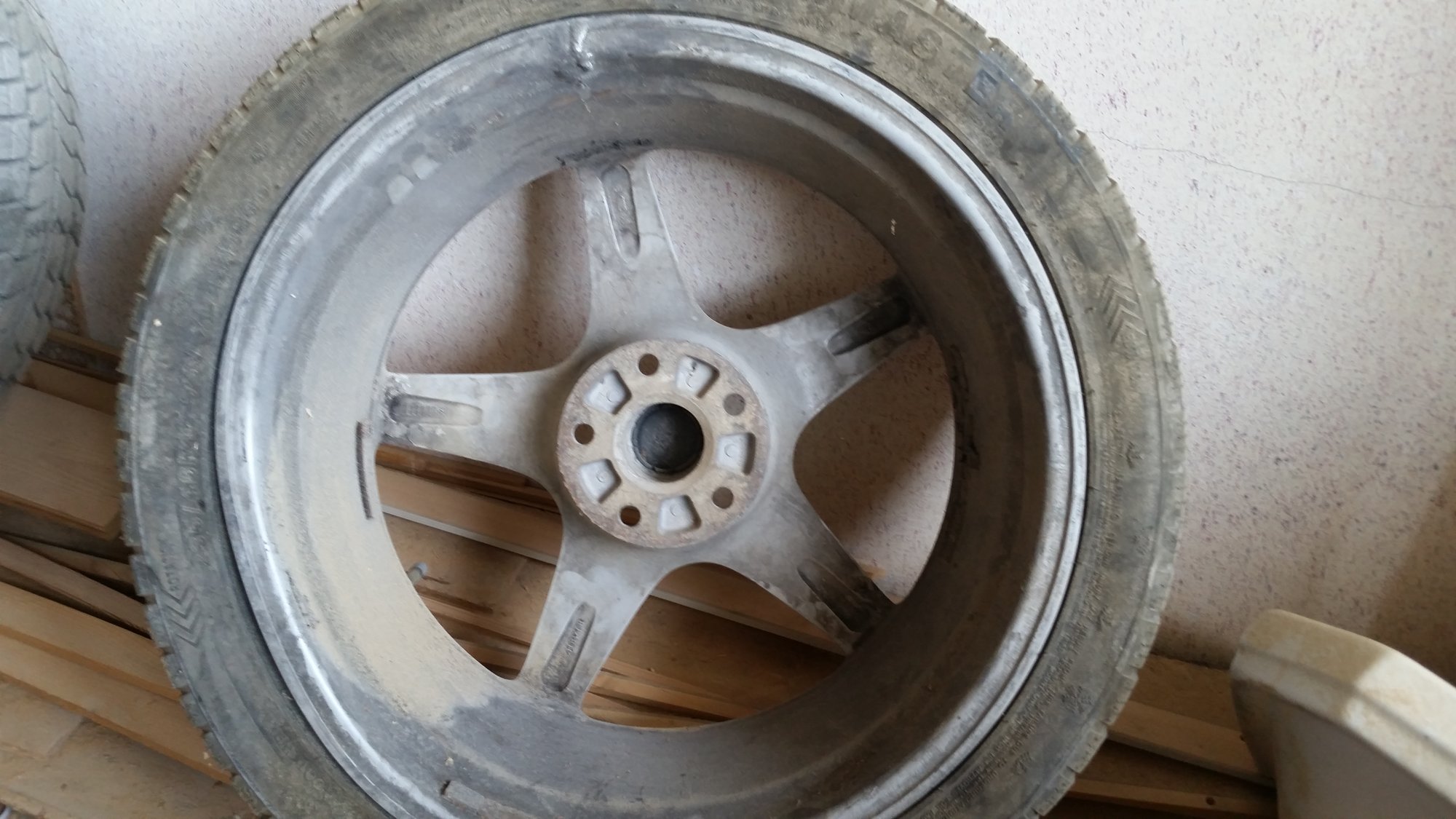

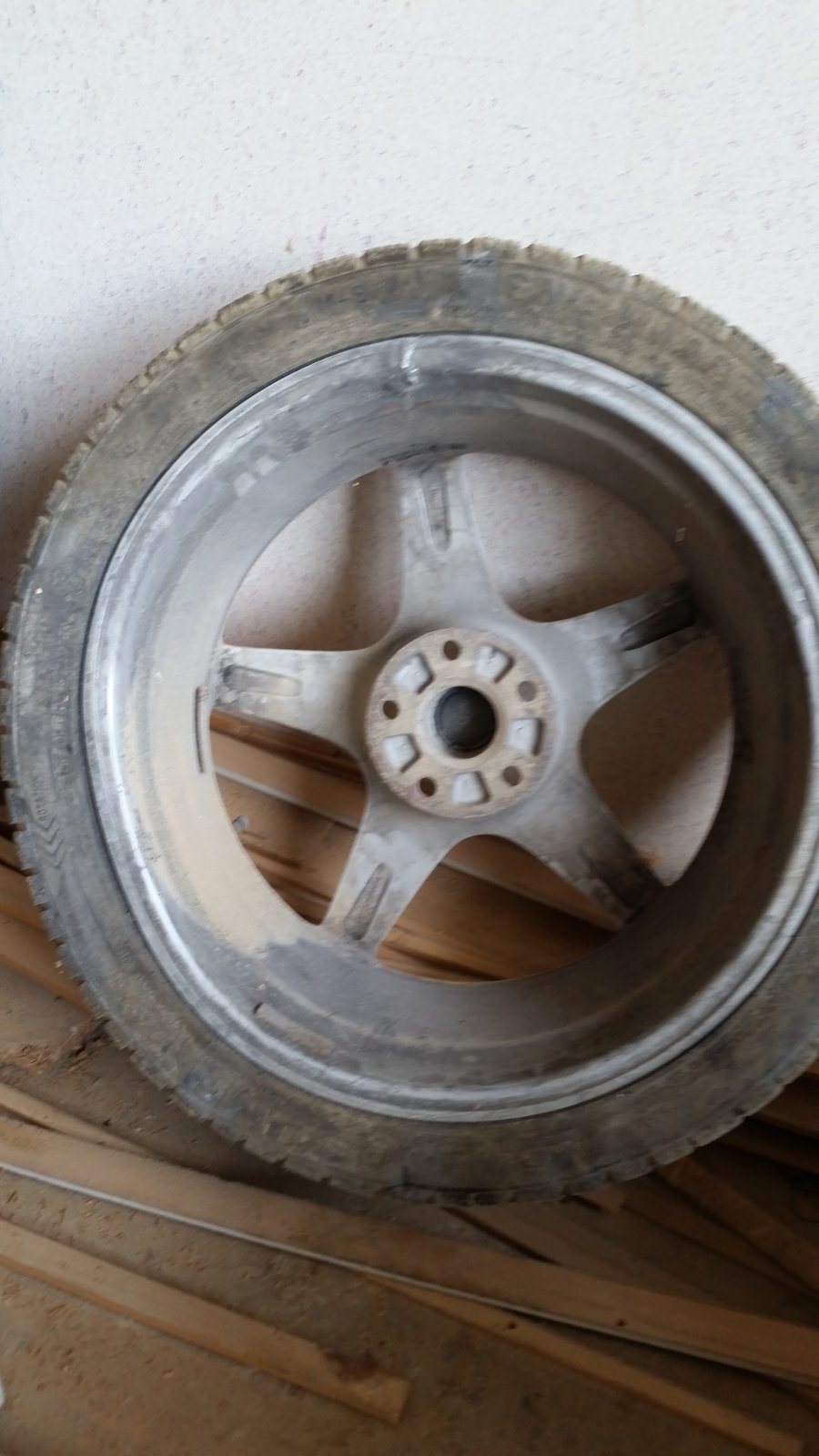

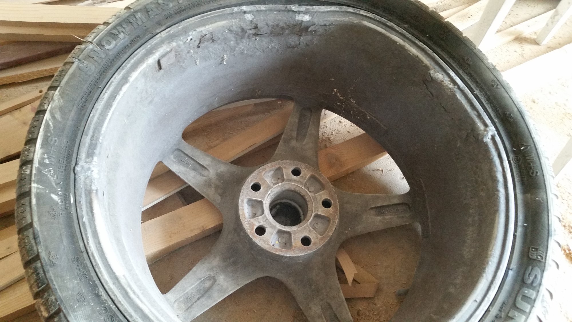

I've been asked to weld a few but declined as tempting as it is, if anything went wrong and a child was hurt I'd never forgive myself, the boss asked me to repair his which I reluctantly did the parwelder kept blowing fuses over 175 amps but realistically I needed more than 200 ampsIve been inside an alloy wheel manufacturing plant , and after seeing round and having the process explained to me ,,, no way on gods earth would I ever repair an alloy wheel for my self , let alone any one else . the heat treatment that goes into making alloy rims is beyond the comprehension of most folk , so to hit one with a welder and expect it to be a good safe and strong repair is just a tad optimistic at the best and totally fool hardy at the worst .
Seeing how prone those OEM BMW wheels are to buckling and snapping, I don't think the metallurgy or process is all that special for them... I know speedline, bbs and a couple other high end wheel manufacturers are a lot better,
but bmw wheels are made from cheese and they weld easy and repairs seem to last if done right... Just sayin.
Not that I'd put my name to a repair!
id weld my own![]()
But insurance companies will use parting your hair on the wrong side as a excuse not to pay so always beware
