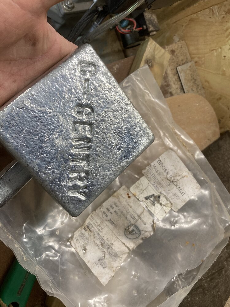

For the metallic zinc, I used an ~8mm slice cut off a cathodic protection anode that I had lying around (they are surprisingly pure) and just screwed this to a steel sheet roughly the same size.

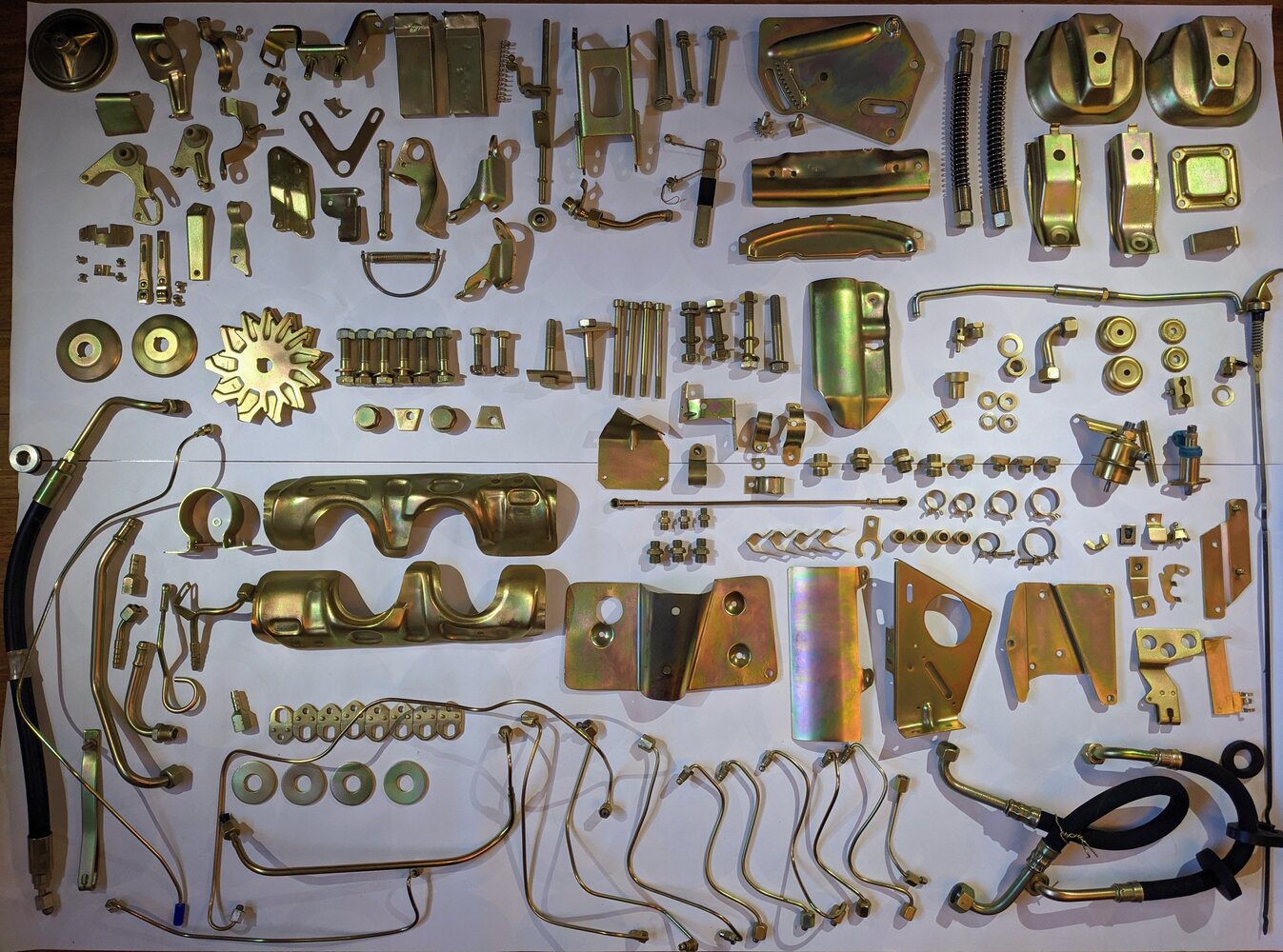

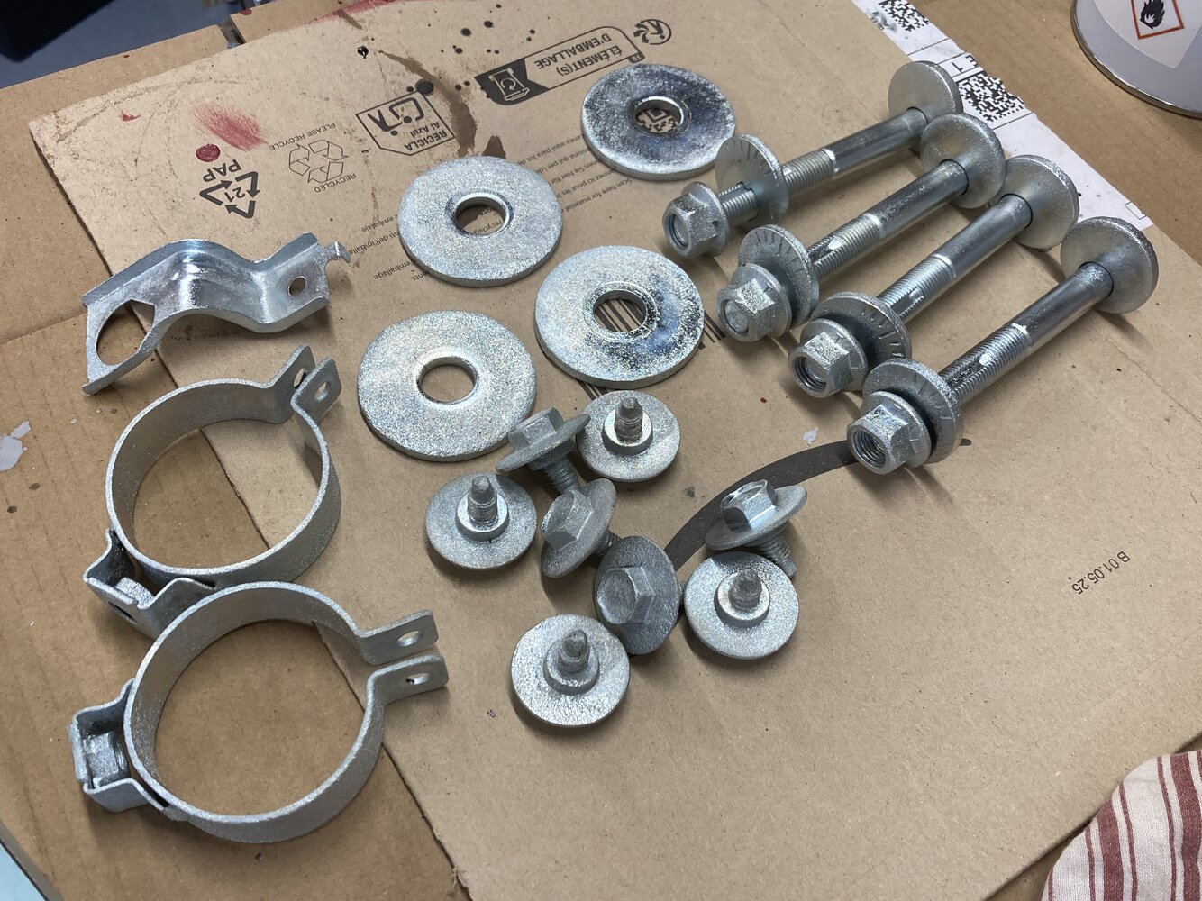

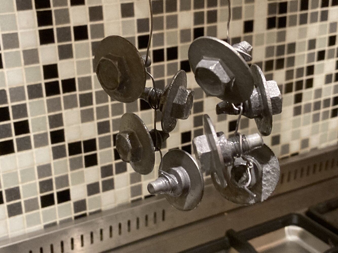

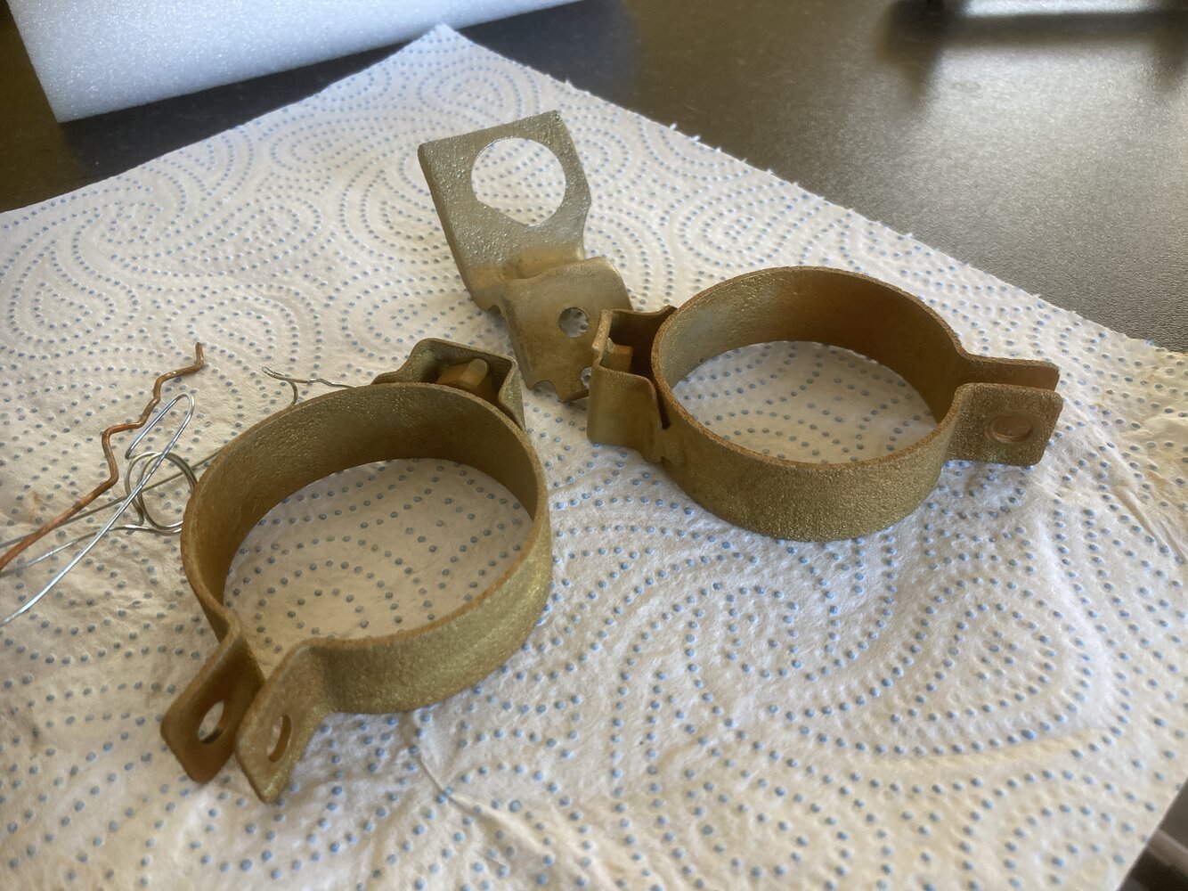

The stuff I wanted to plate was quite rusty - to the point of pitting. New fasteners are available, and would be the way to go for a proper restoration but the costs starts mounting up very quickly. I just wanted to put what I had back without the depressing sight of old, rusty fasteners on refurbished parts. The total cost of all the chemicals, including delivery was ~£50.
Rust was removed using the DIY evaporust mixture (citric acid / sodium hydroxide, etc.) and the parts wire brushed to shine them up a bit.
I degreased them using McKLords water based degreaser at about 5% (This stuff, but it was £11 / 5L a few months ago!) - beware, the neat stuff is VERY aggressive.
The parts were mounted onto steel wires and given a brief ~30 seconds - 1 minute dip in 10% hydrocloric acid (neat brick cleaner), then rinsed with tap water and transferred to the plating bath.

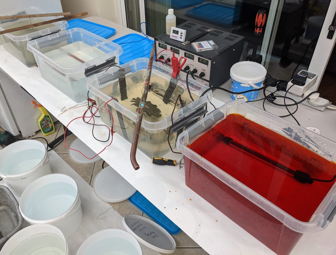

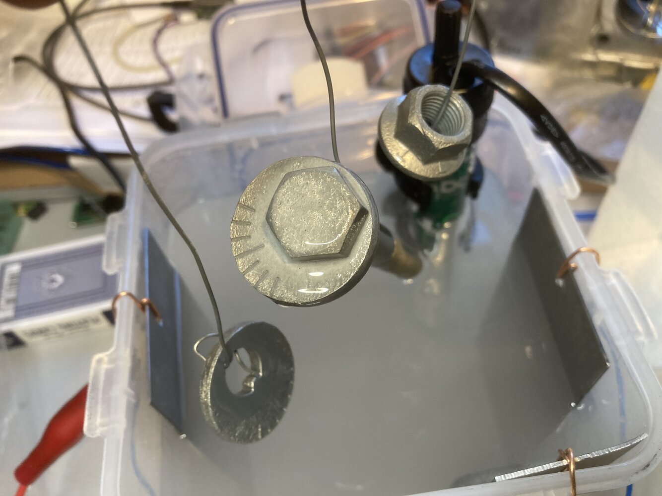

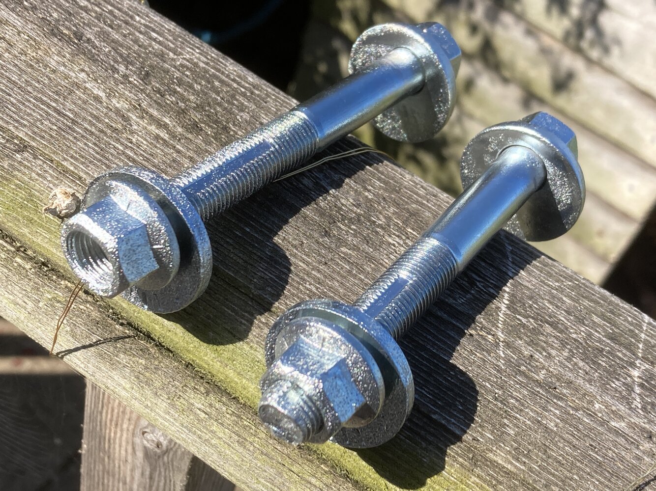

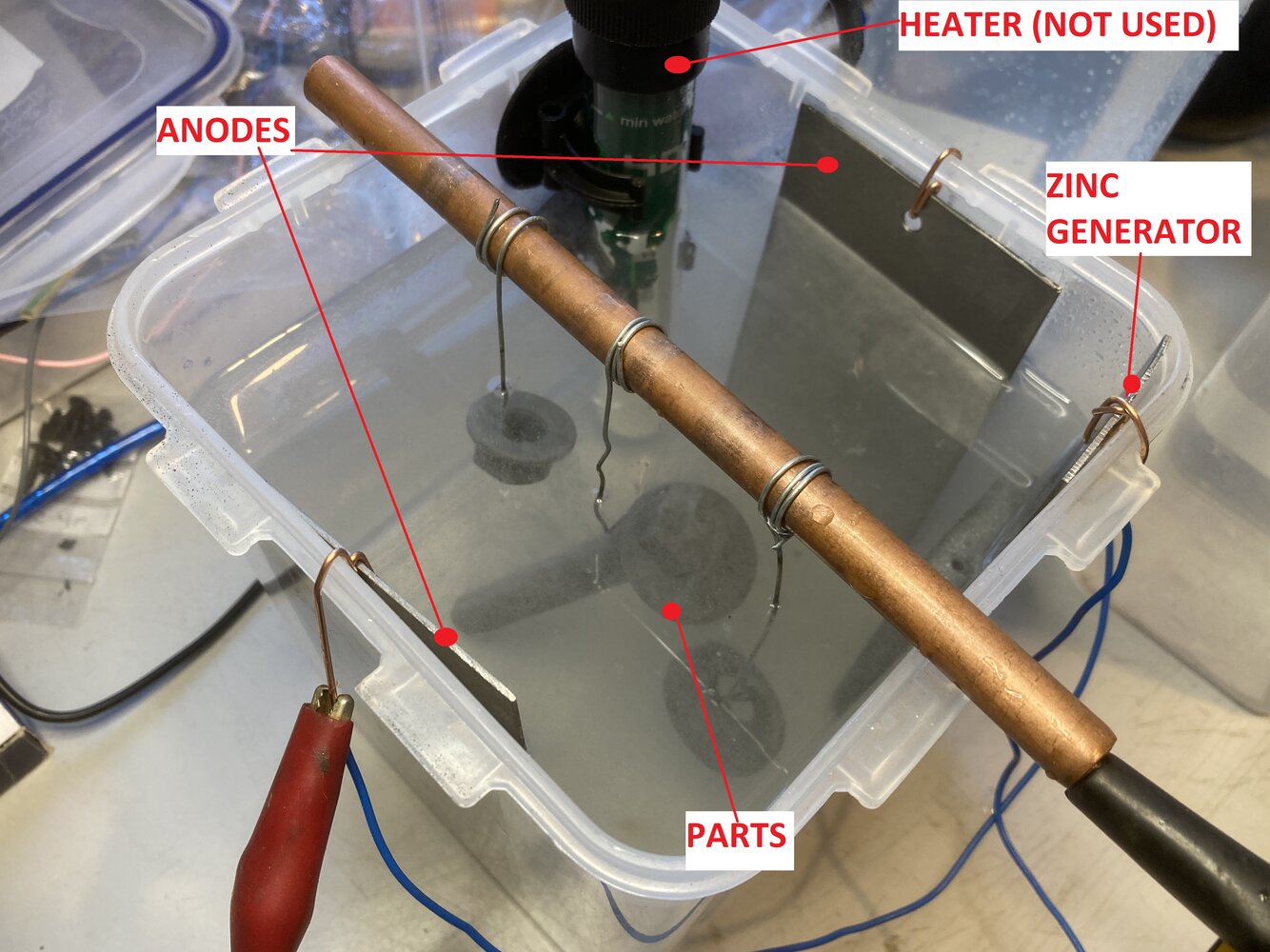

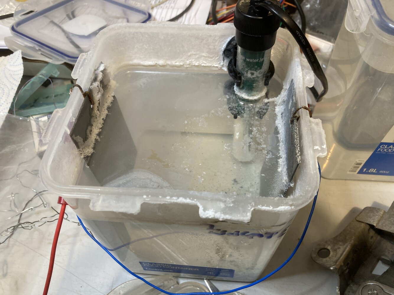

The anodes are just steel sheet (one either side of the bath); the zinc generator is steel sheet fastened to the slice of zinc with a steel screw. It looks like it is electrically connected in the photo, but it isn't - it's just hanging in the bath.
I did get a small heater, as I understand that the process needs to be at ~25°C to work, but I was doing this in the house, in the summer and temperature wasn't a problem, so the heater wasn't switched on.

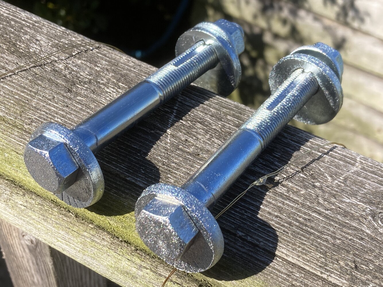

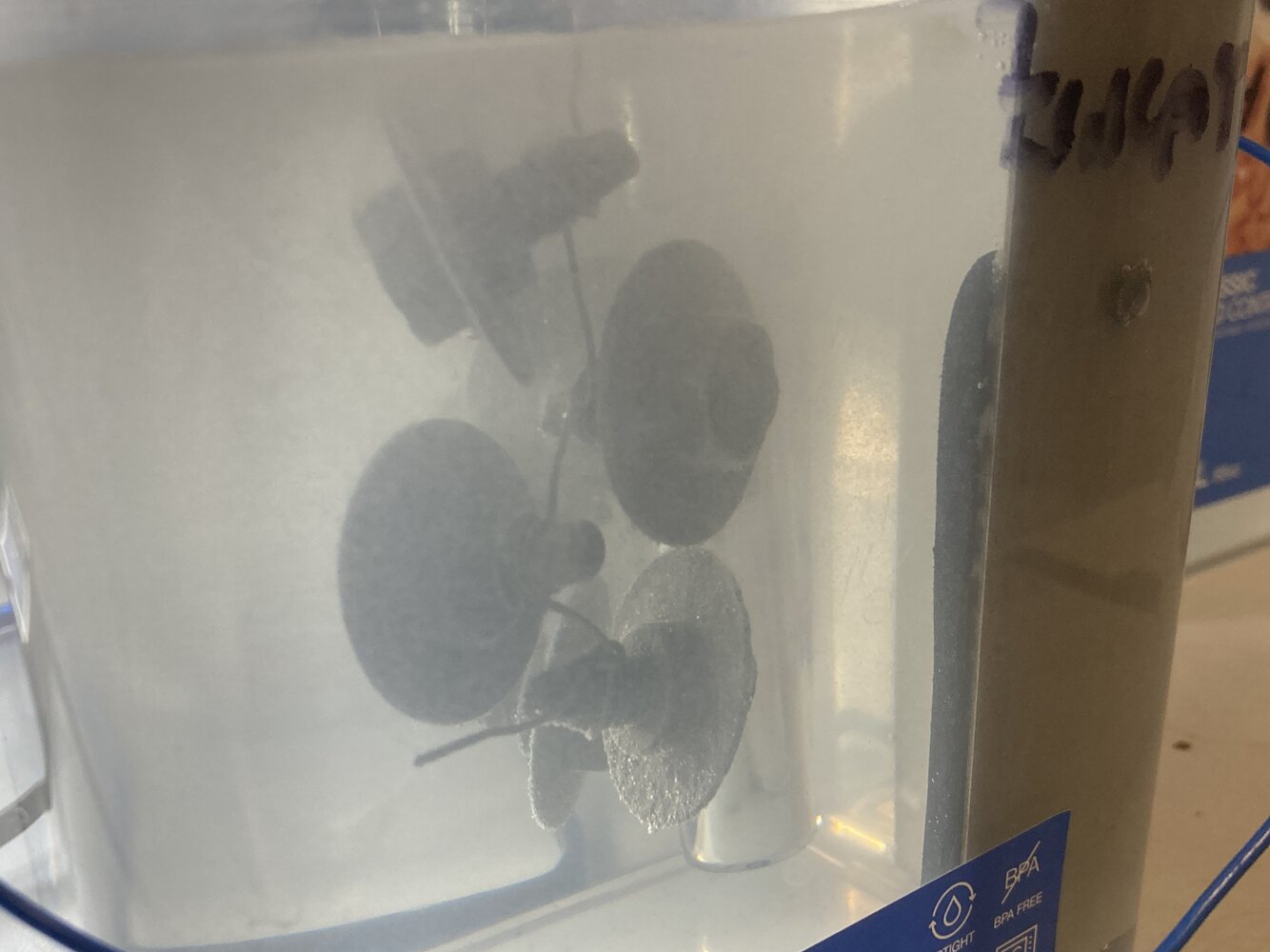

Voltage required is very low (about 2V). The plating current that I've used is 20mA / cm^2 (roughly 120mA / square inch), so about 1.25 Amps for the parts in the photo. 90 minutes at that current results in 13µm (1/2 thou) plating thickness (verified using before / after measurements with a micrometer).

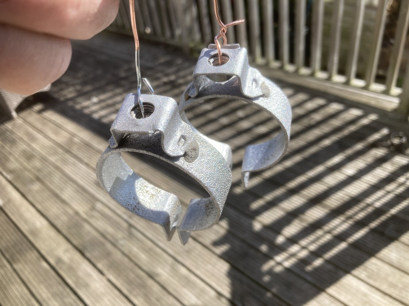

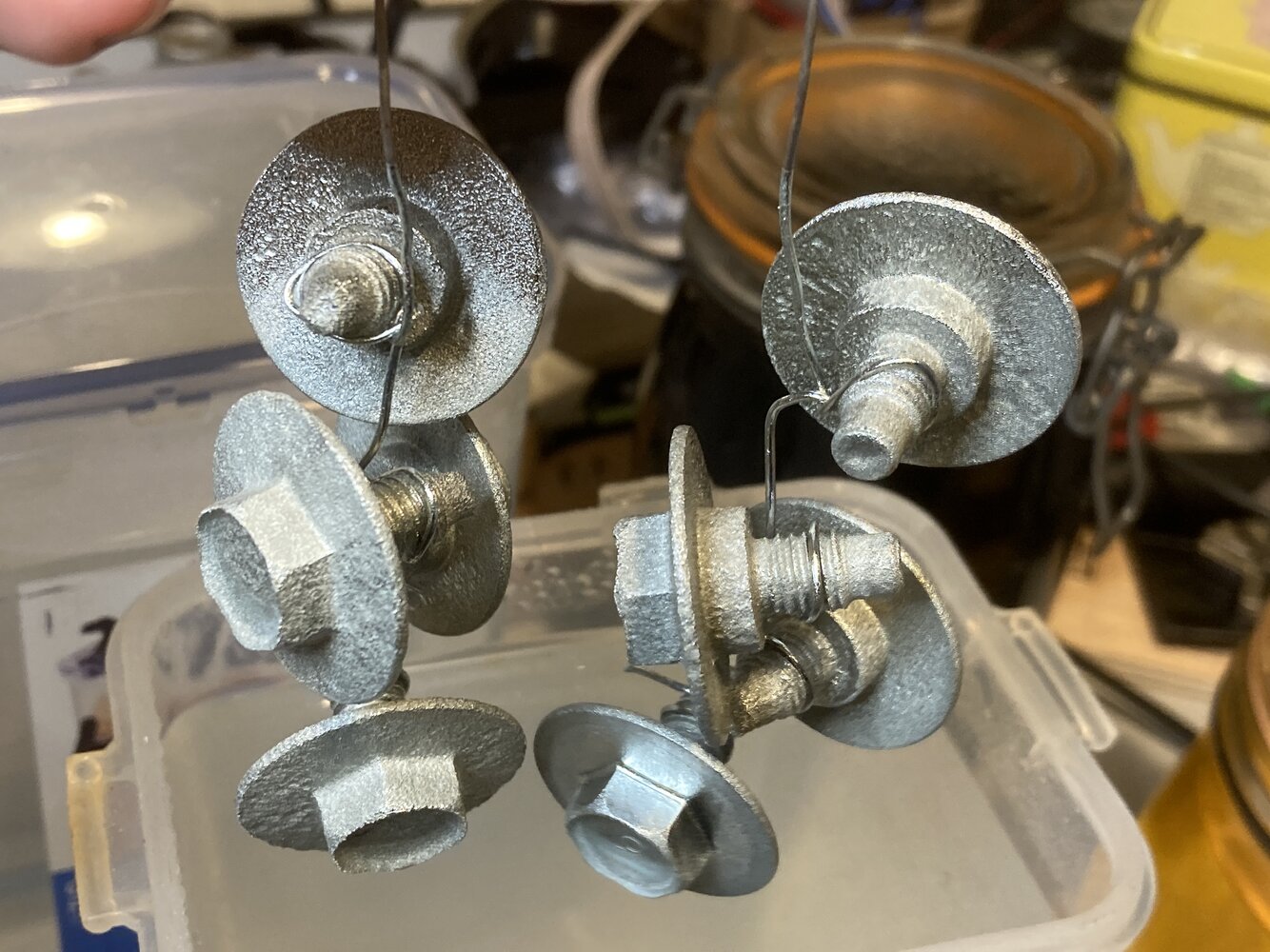

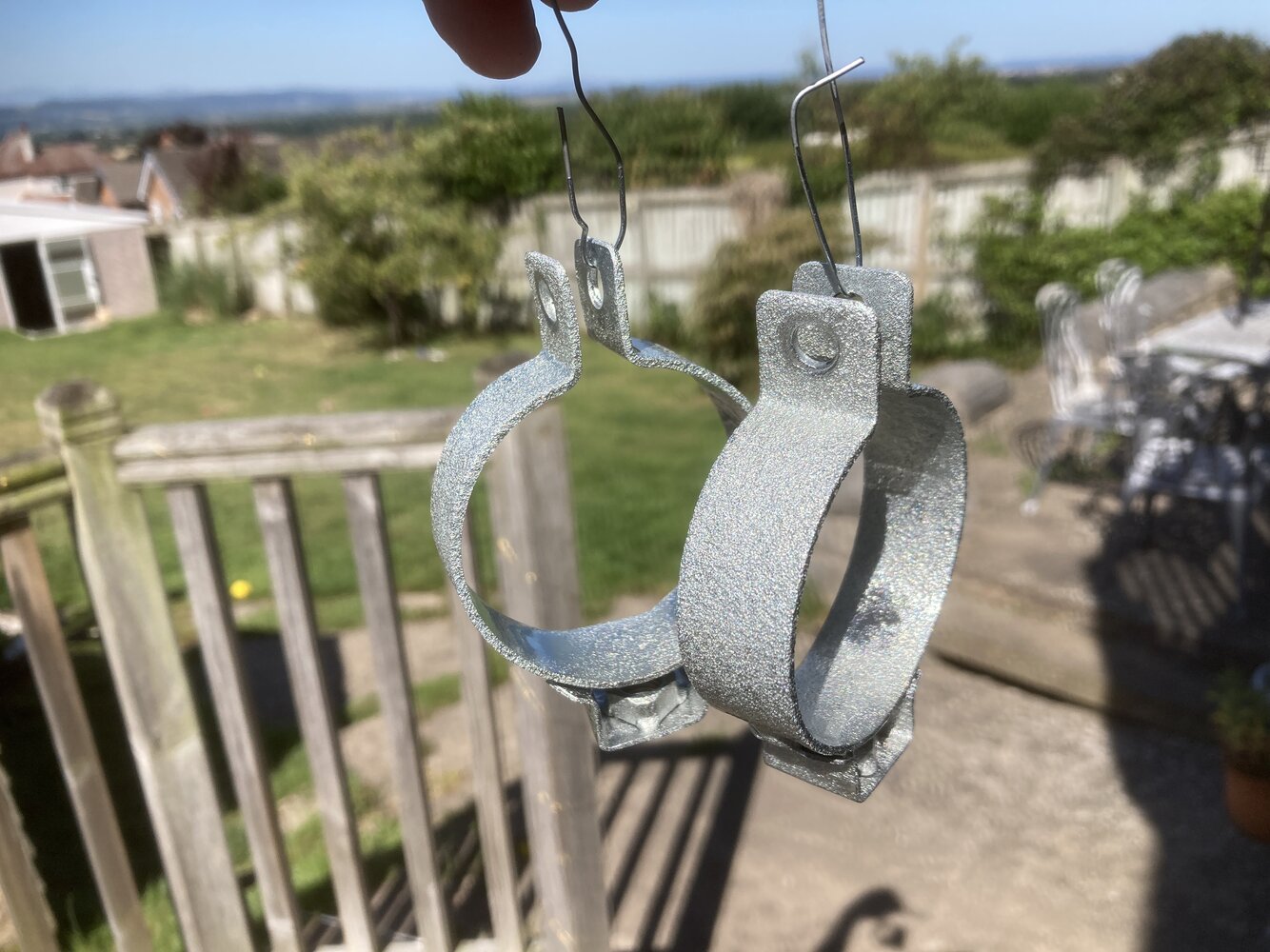

Immediately after plating, the parts look dull.

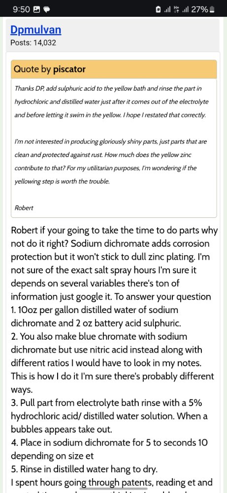

I give them a quick water rinse, then transfer to 2% hydrochloric acid (brick cleaner diluted 4:1) for a couple of minutes to clear off the brightener, then another quick rinse and swill them around in the passivating solution for ~30 seconds. This is when they really brighten up.
