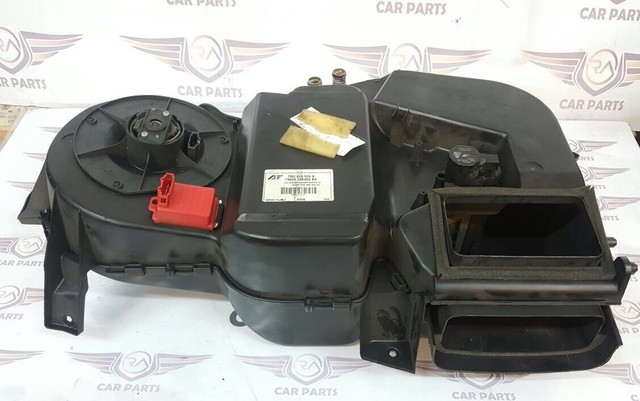

I have been thinking about your issue and I think what I would do is to clamp off the top and bottom hose and any bypass hoses to stop any of the coolant passing aimlessly through the main rad, that will then force the coolant through the matrix greatly increasing the chances of success it will ensure that the sealup is only traveling through the engine and heating circuit, actually you may only need half the container!. save the rest for a later day, after all all you require is a lot less than a thimble full to get where it is needed , the engine will get up to temp a LOT quicker and concentrate the sealer where it is needed, in this weather a heater on full will easily keep an engine cool enough at idle, with the heater motor blowing.
But it will also stop any sealup remaining in the rad as this is the main worry it blocking the rads narrow tubes after all you will just be wasting energy letting the water circulate where it is not required.
