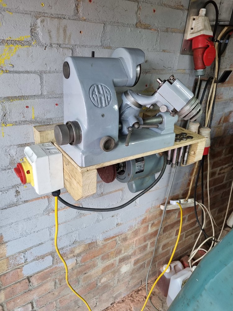

400v contactor, it will read about 2K ohms across the coil, see if 240v will hold the contacts in, most of the ones I have liberated from old equipment will.
