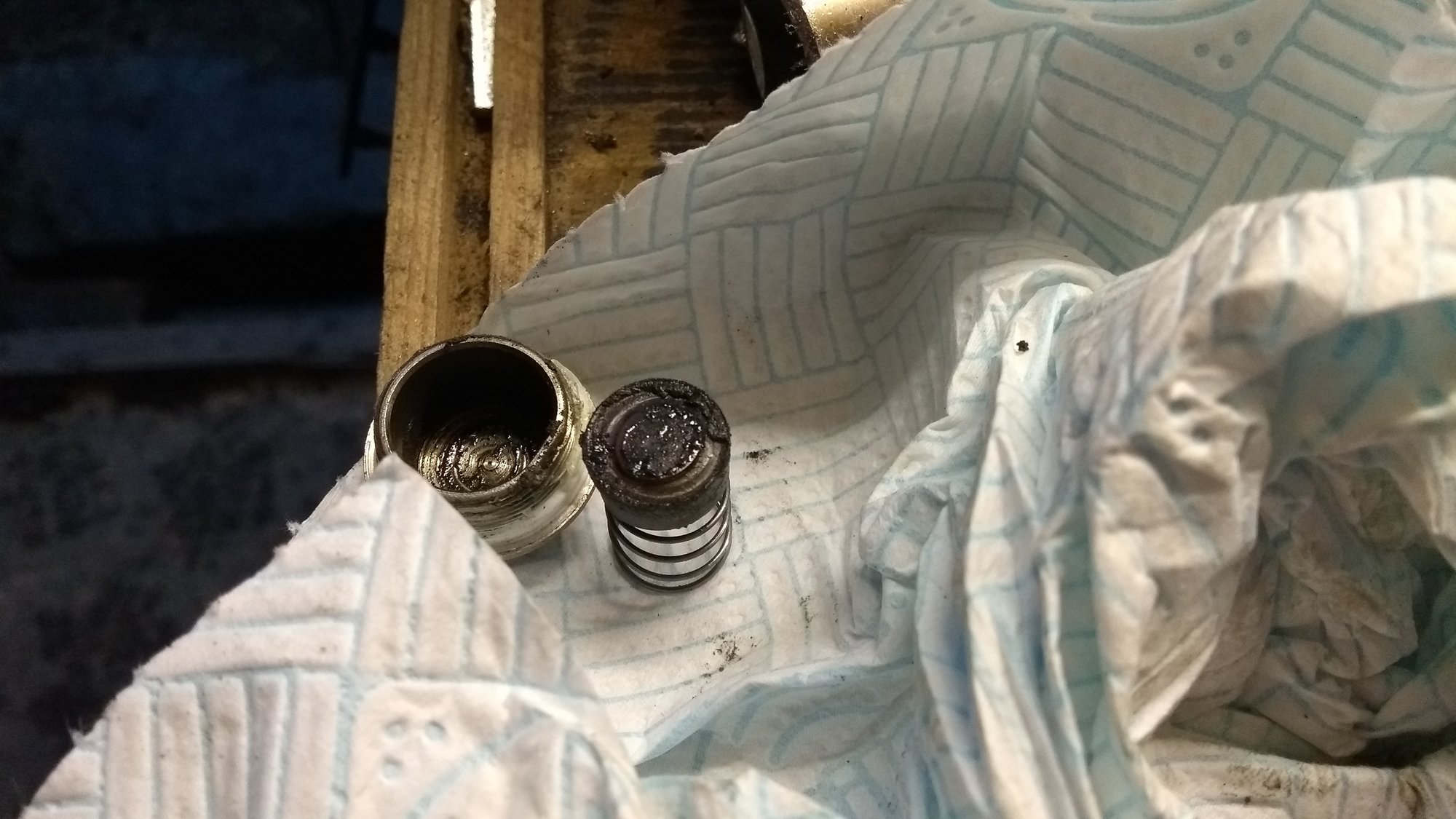

Cleaned up the nrv, which was very oily and grungy.

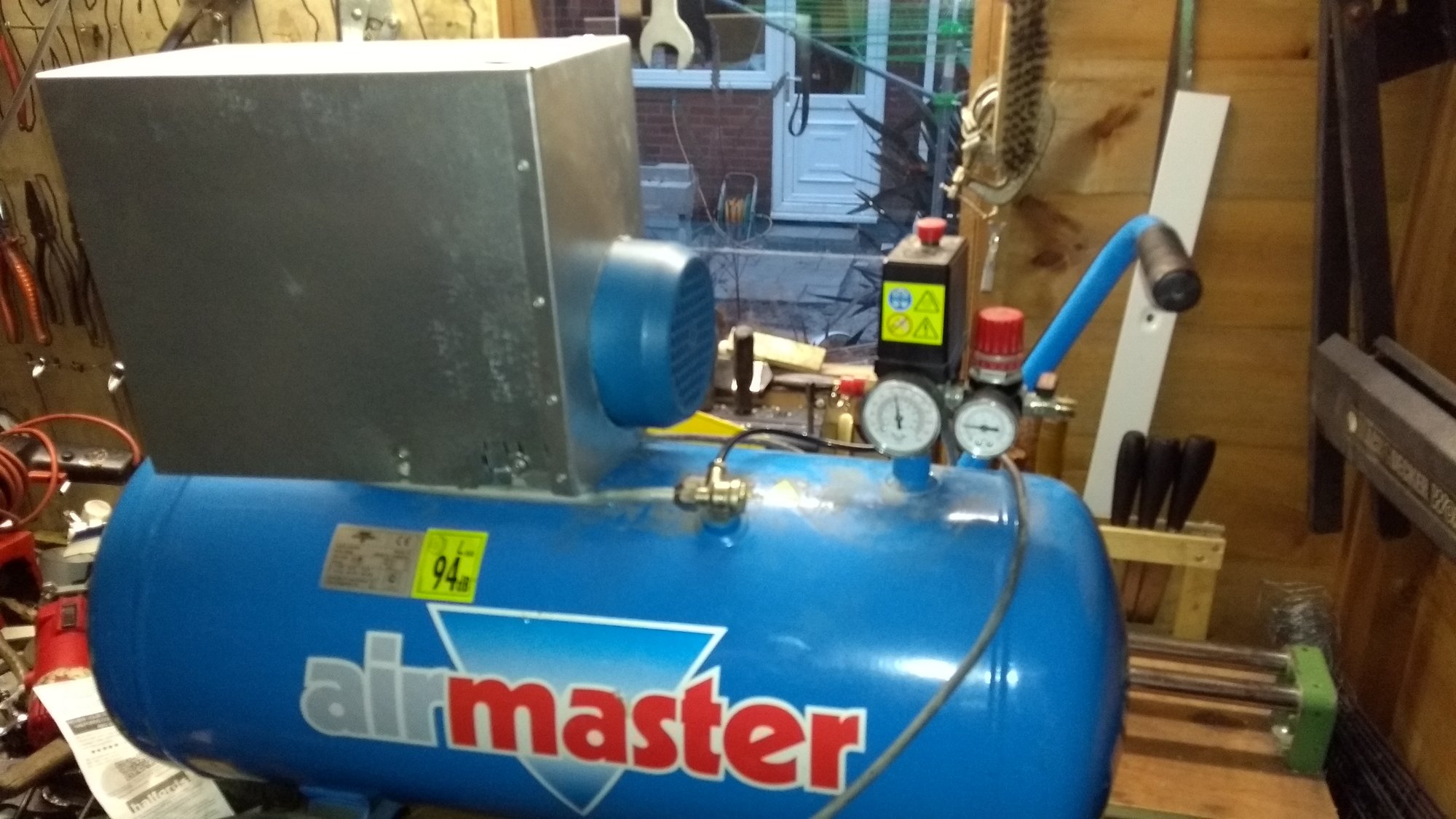

So next thing ,buy oil, get another impeller,make a shroud too replace plastic missing one fit missing airfilter and start spraying.

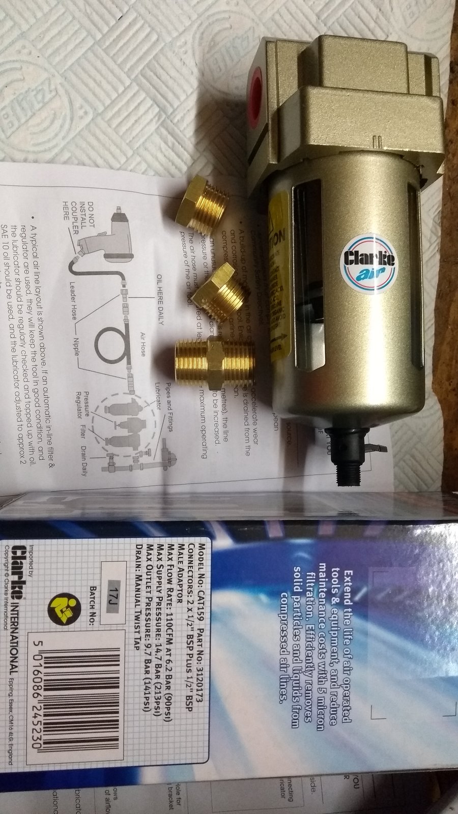

One more question,it hasn't got a oil/water filter, will one from Machine mart do , the type that screws on after the gauge.
Bearing in mind I am probably only going to spray one bumper and then mess about with an airbrush?

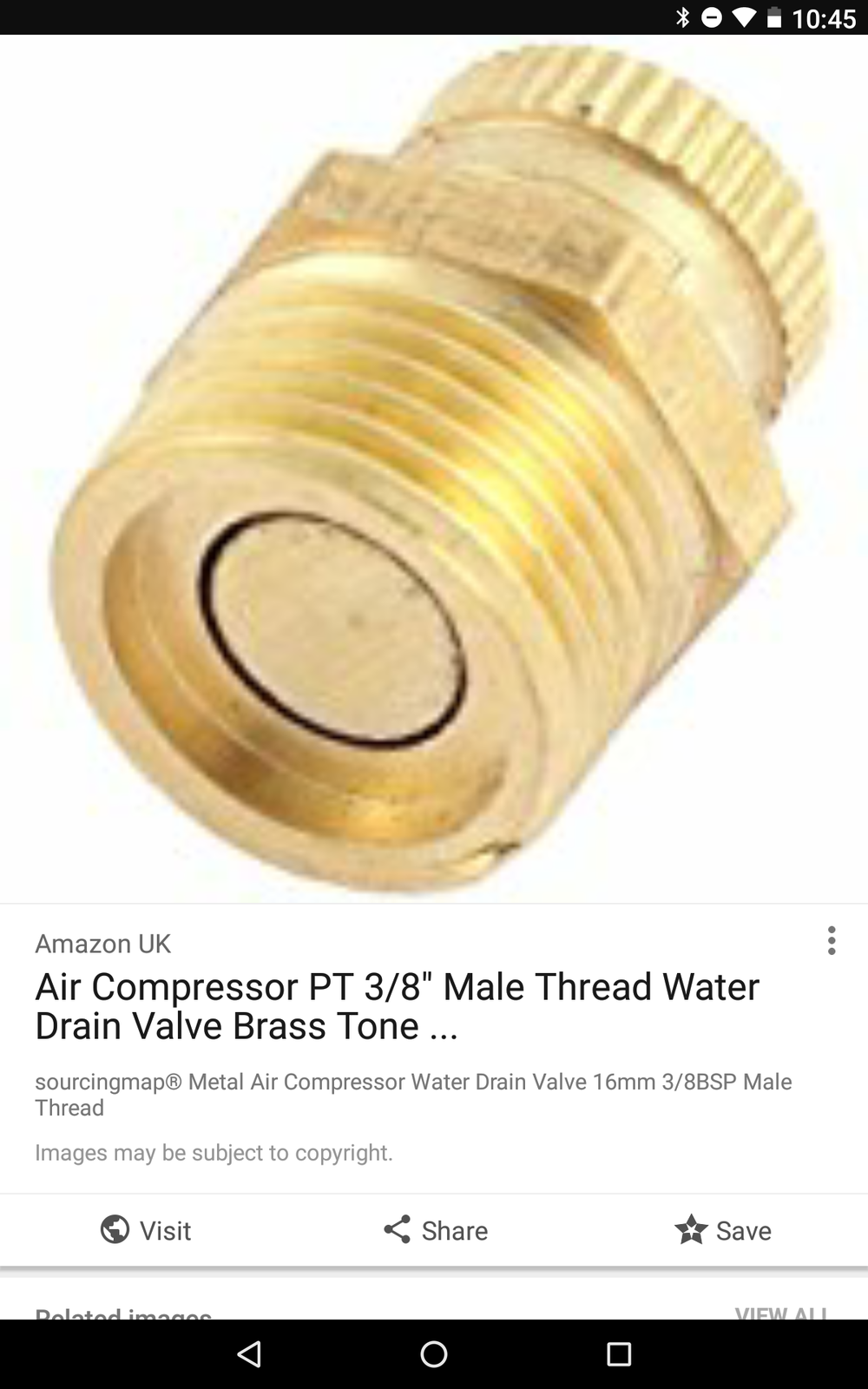

Fired it up but the bleed plug was leaking it stopped when I unscrewed it??? It was still leaking a bit until it built up pressure then stopped.
The brass drain cock underneath?Saved £20 then
What do you mean by the bleed plug?
On mine it's brass sump plug with a brass nurled bolt through it
I grovel too no one, even under pressure.Right, you referred separately to a drain plug so i thought you had two different things. The drain cock on mine turns clockwise to close, like a tap. One think I have done is to replace the drain cock with a hose tail and fit a ball valve to the end of a length of air hose, that way it's easier to operate and there's no more grovelling on the floor.
So is it ok to just get a machine mart water filter and maybe a small filter at the gun or is oil a problem as well?Do the water filters remove any oil from the system? Just wondering whether I need an oil, water combined one. Also is it worth having a small water filter in line just before the gun.
