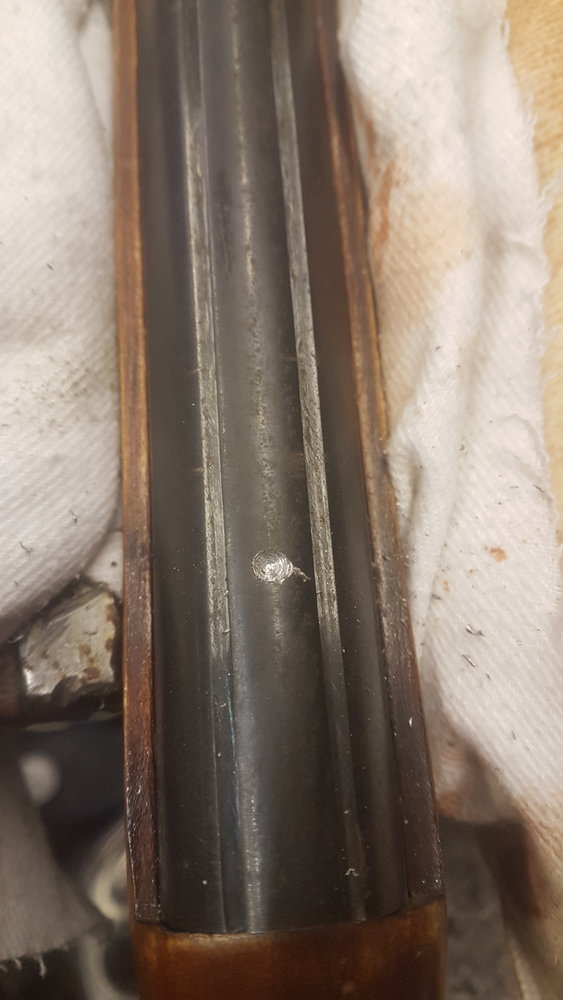

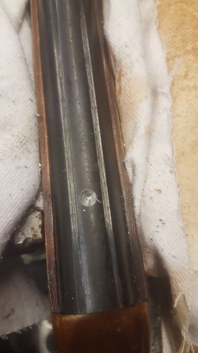

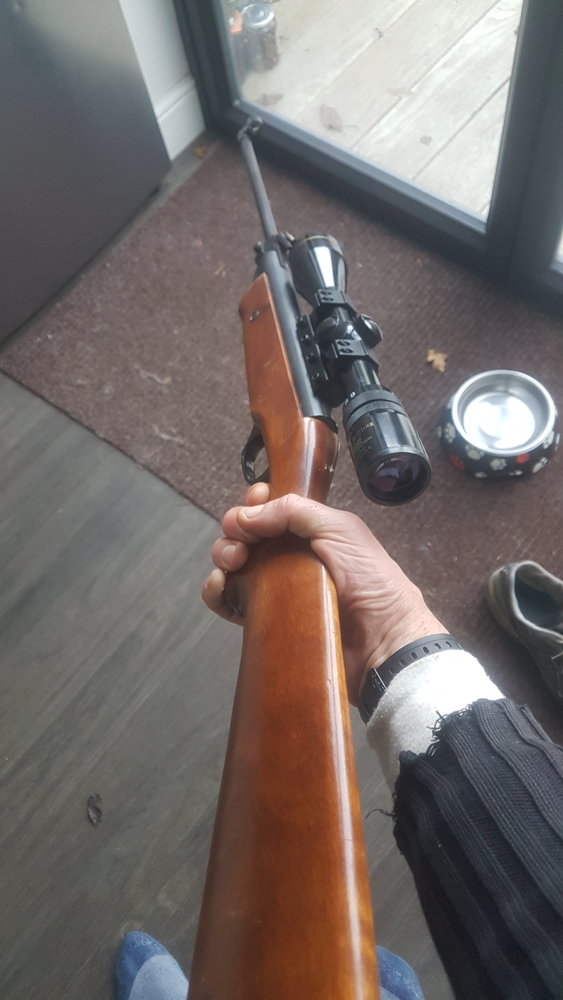

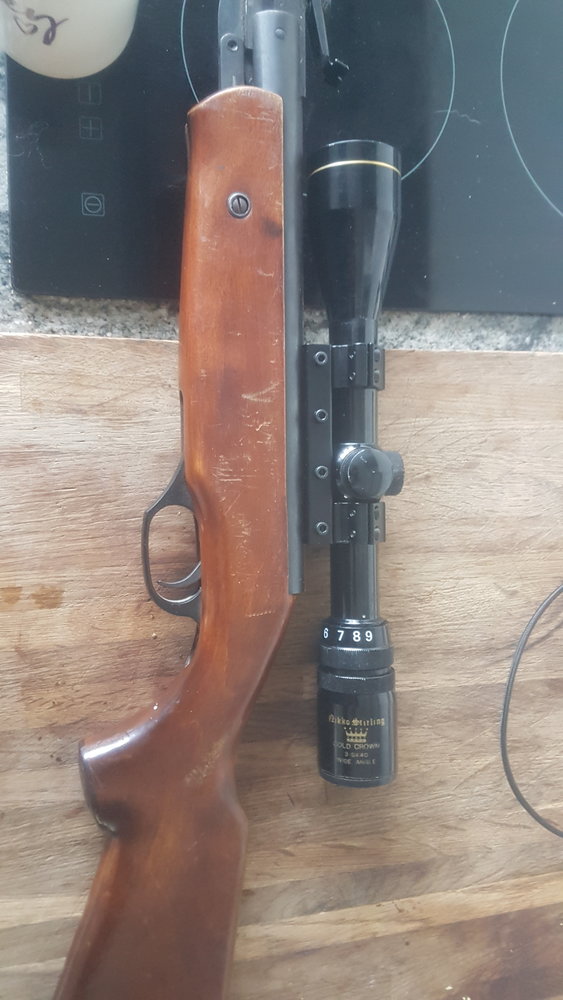

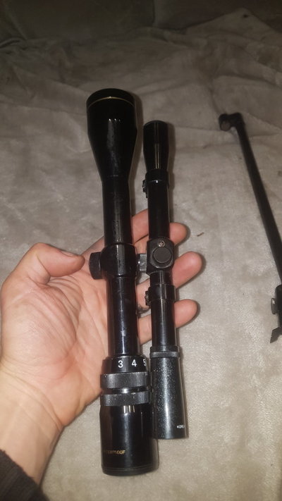

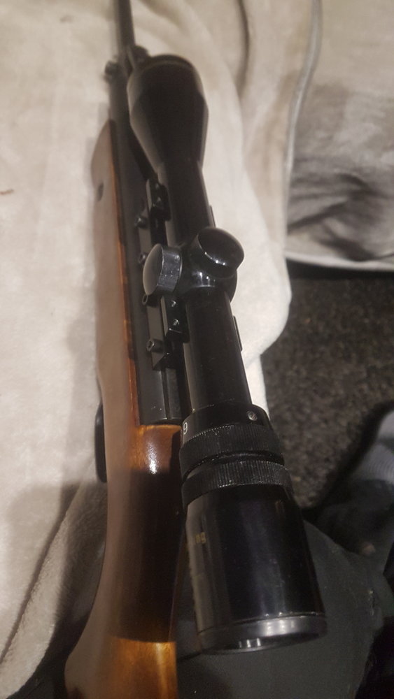

Yup,Looks like the scope needs turning 90* so that left turret is the elevation one

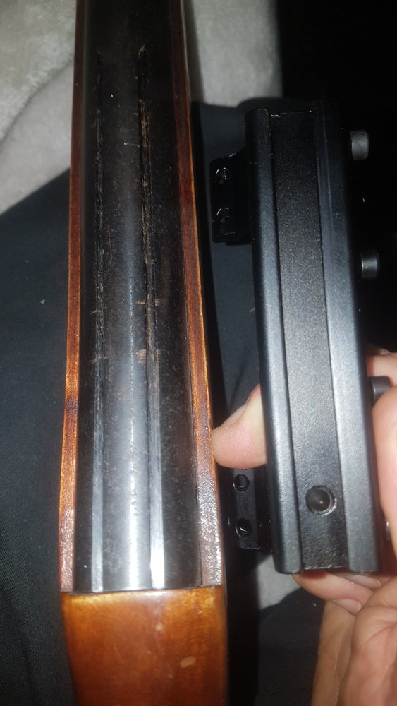

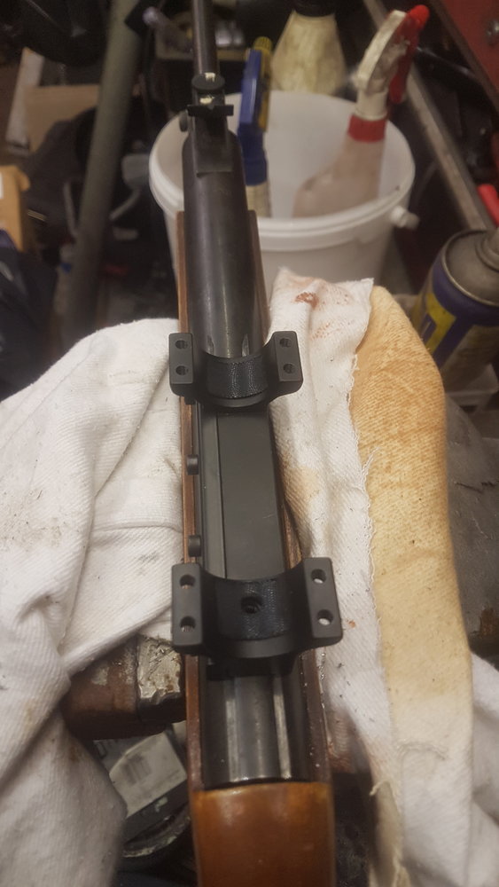

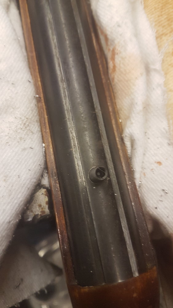

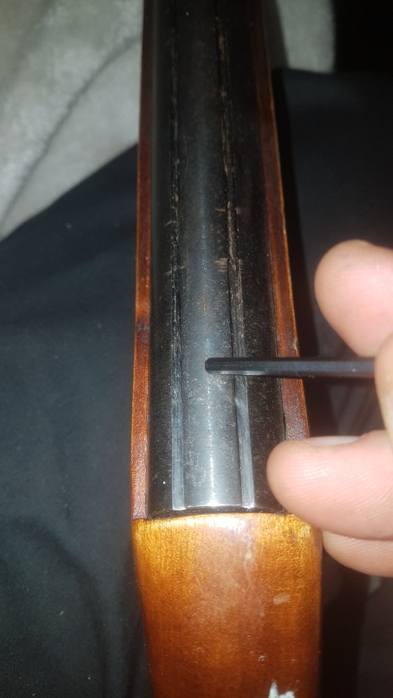

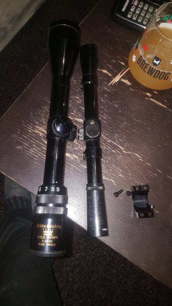

A springer, especially some of the cheaper options, will have more recoil than a .22lr. It will have two elements to the recoil, the first as the spring and piston go forward and the scecond, much sharper one as the piston stops dead as it hits the end of the cylinder. It's likely the second one is whats causing your scope to shift. As others have stated, those mounts aren't up to the job. I'm not familier with your rifle or the scope but if the dovetails are a standard size and the scope a standard diameter, a good enough pair of double screw mounts can be had for well under a tenner.
Sounds like you need a better scope designed for centrefire.
the scope is narrow actually, only .75" most mounts I can find are for 1" scopes
