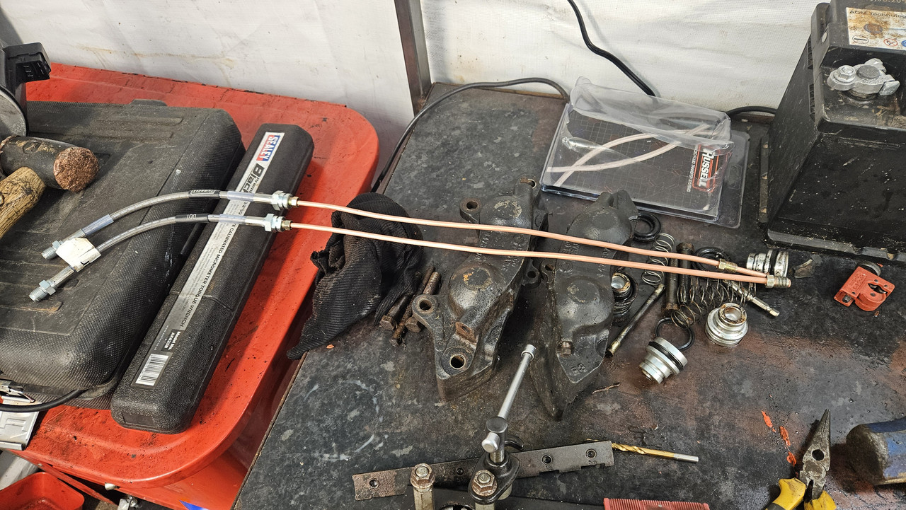

I made up the rear lines from new braided flexi to calipers. Again with copper i had.

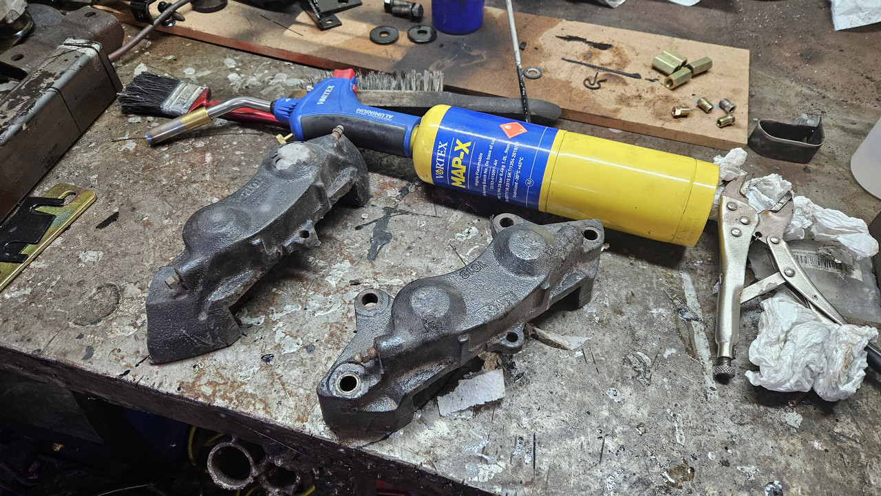

I have tried to clean back the calipers again to paint them but no luck, i need some decent paint stripper as heat and sand blasting is not doing it to well.

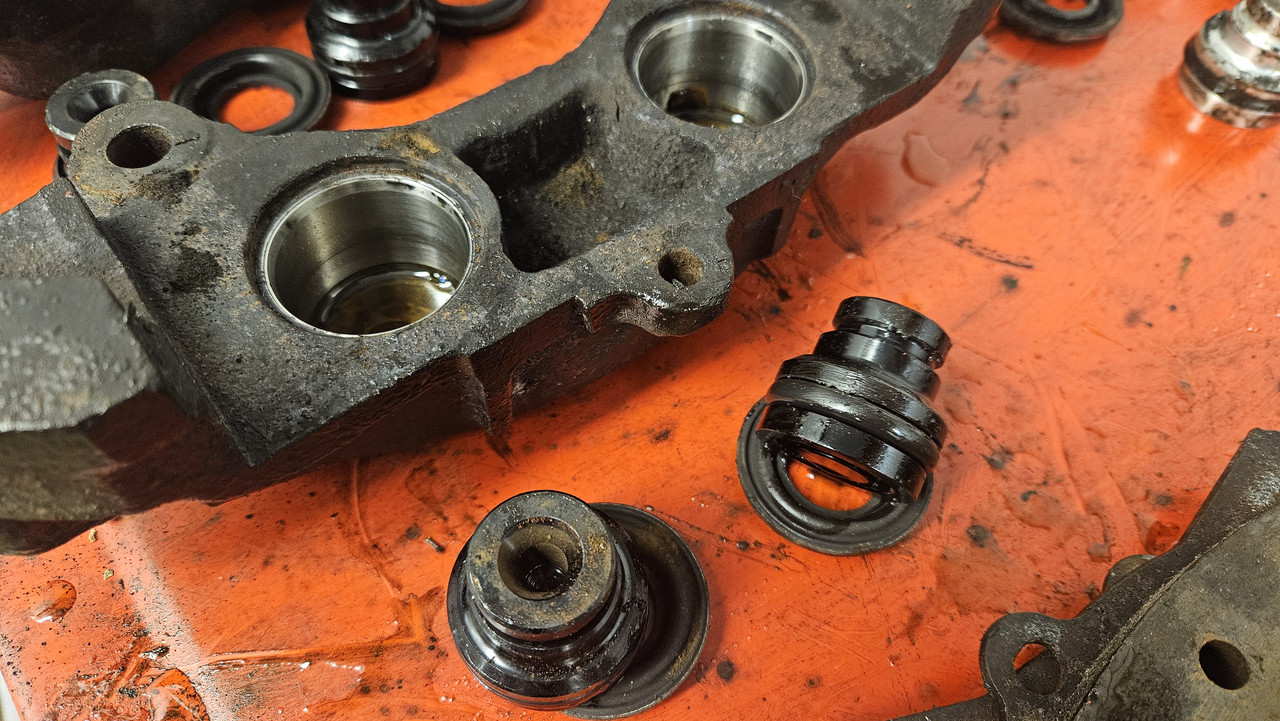

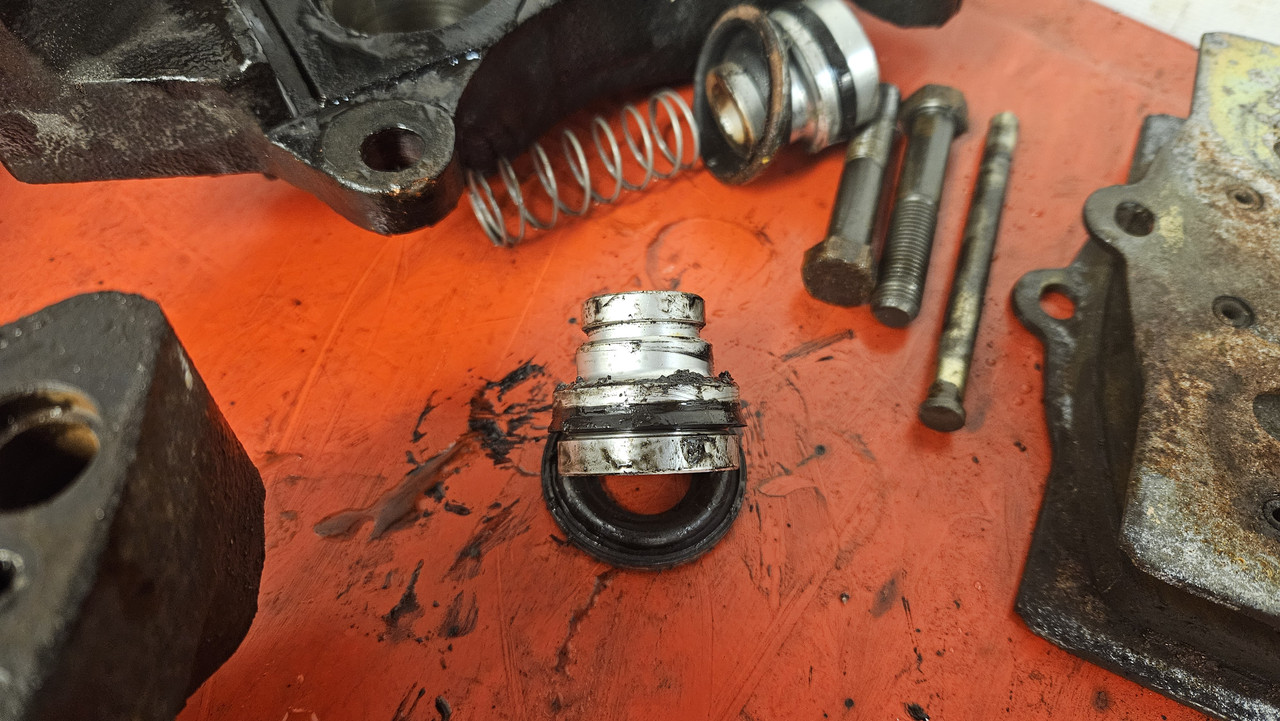

Also on removal and strip down of the rear calipers i notcied one side had old type Lip seal on the psitong, on the toher the uprated O ring seals. So today...or was it yesterday, i ordered another O ring set.
O ring
Lip/Umbrella seal.

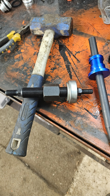

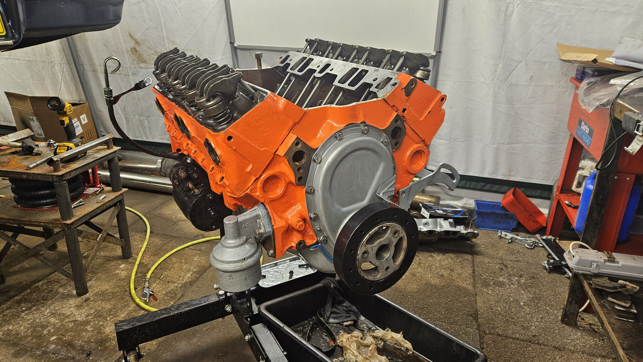

i was going to make these tools, but the tenner each i didnt want to faff about making them
One is the oil primer and the other black threaded bar is to fit the Harmoinc balancer.

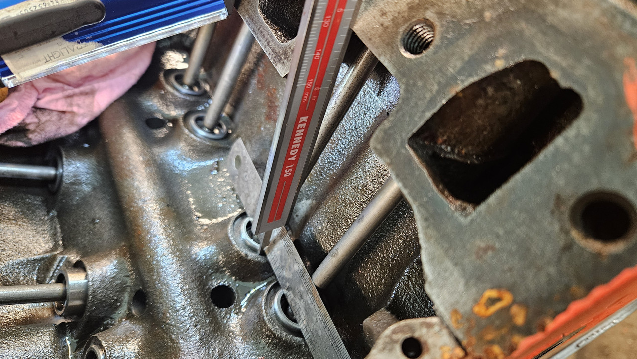

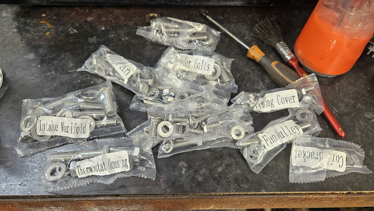

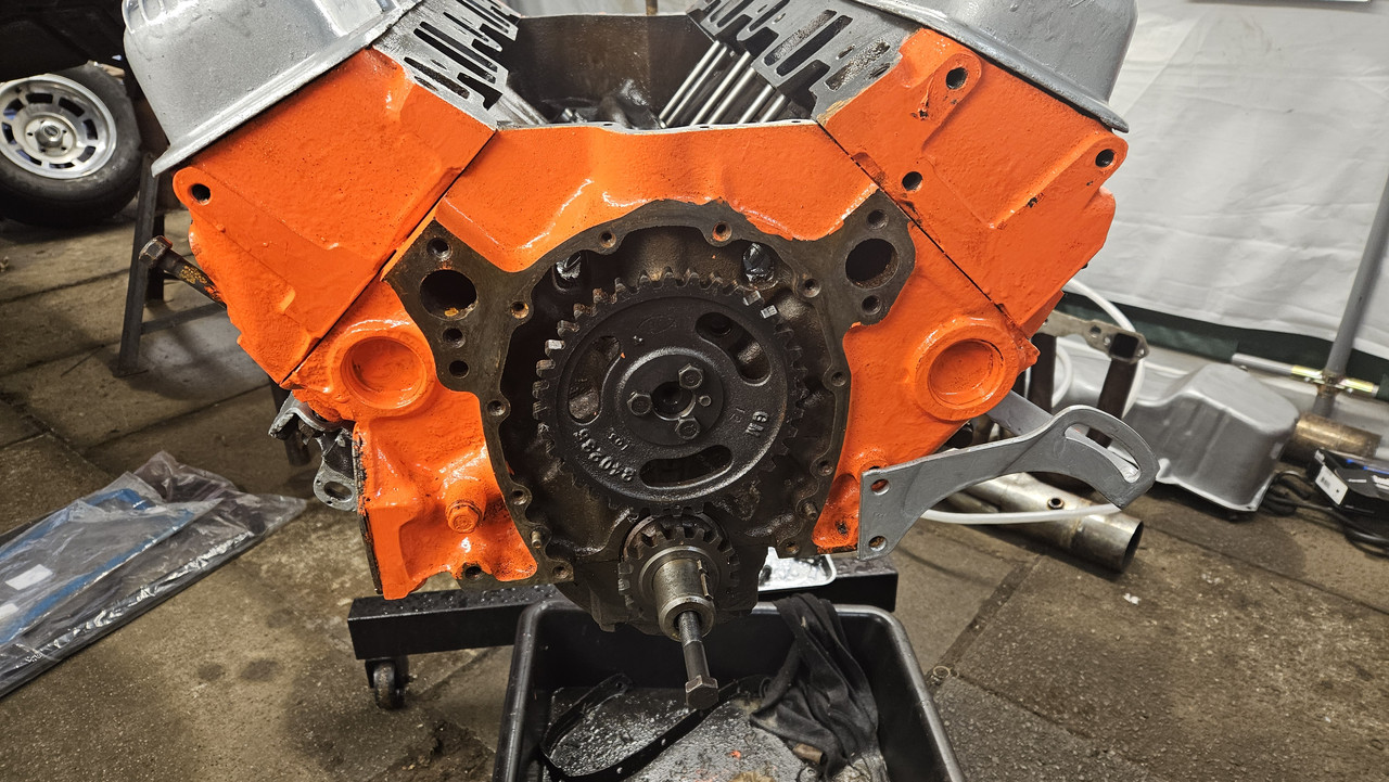

Got the gubbin needed. I got a cheap set of bolts, these will only be used for the Ancilleries though, not the heads etc 304 SS so i used thread lock and got some new RTV.

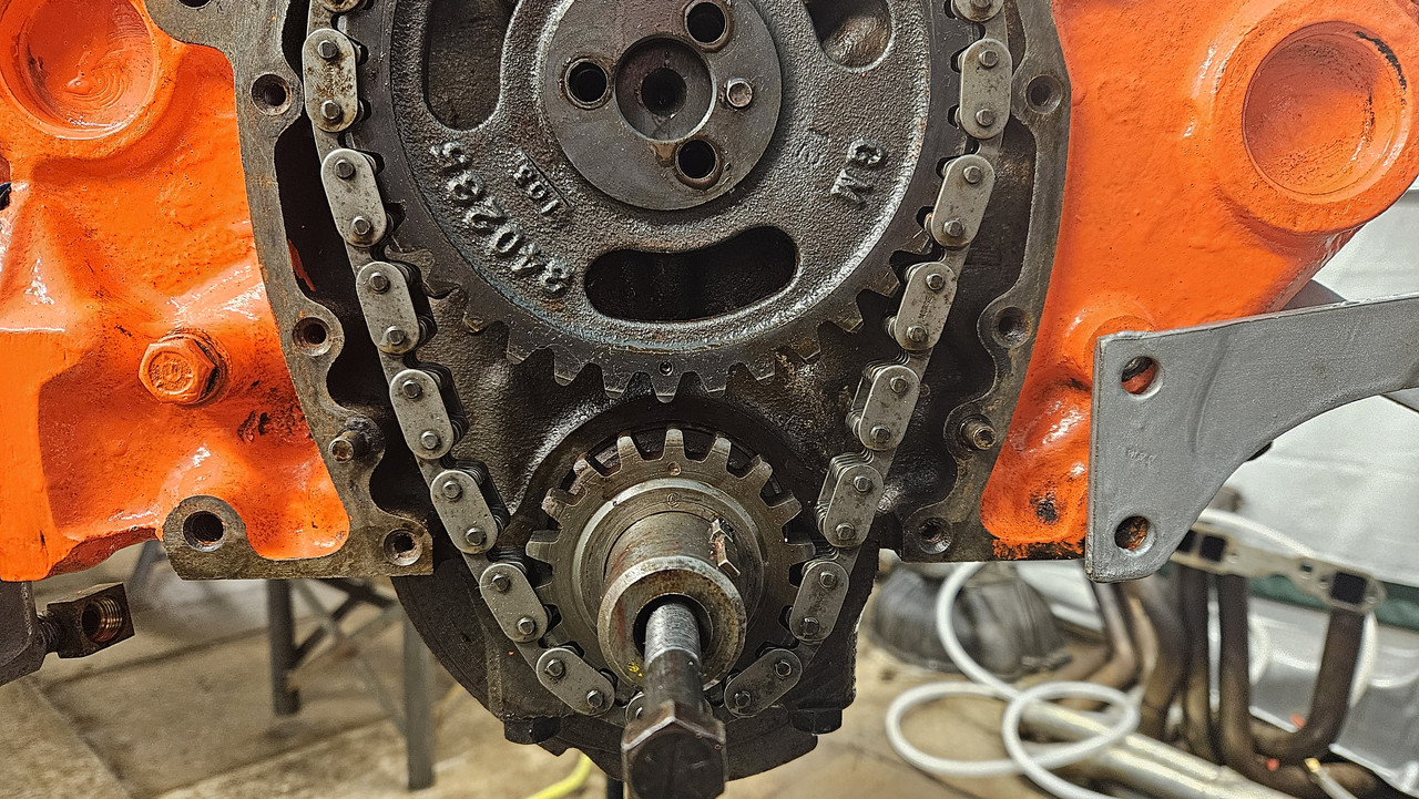

Join the dots and in a bit ill show how i timed it up.
Tool worked great. didnt snap, well if used correctly it shouldnt really.
