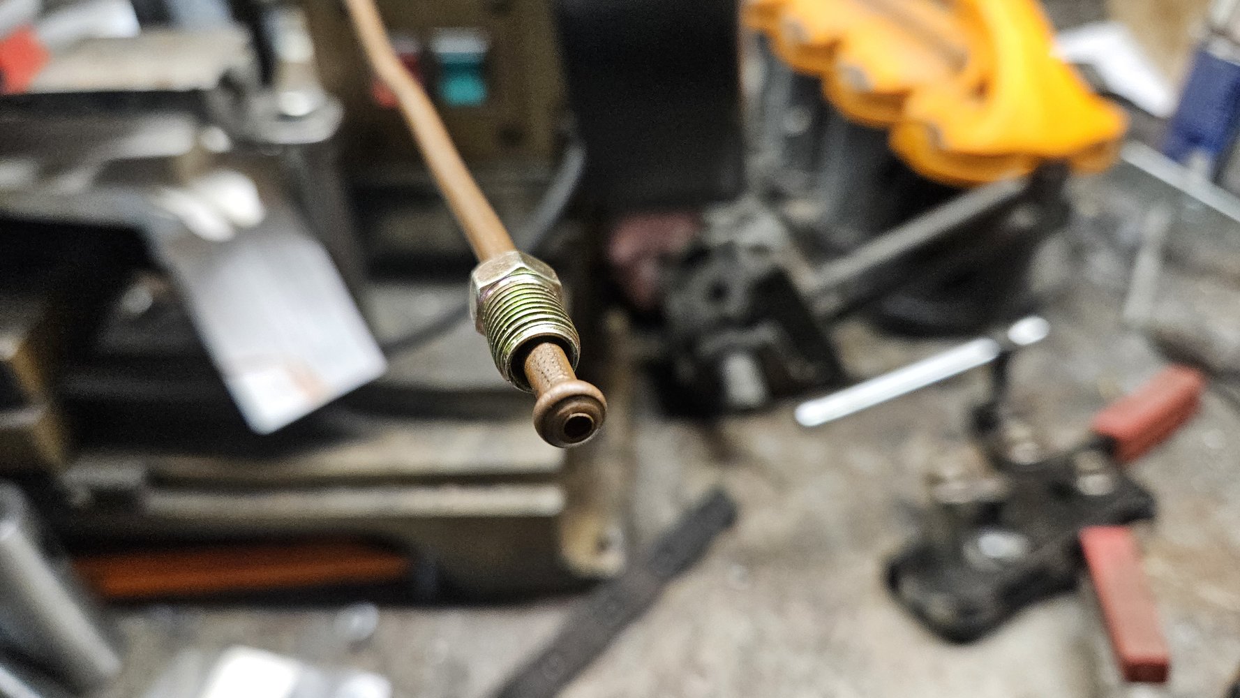

Yes I did.Some may of noticed a the flare, it was a Bubble flare, which is not used on American vehicles as they use Double flare. I am glad i put stuff up as on another place i was told its not good and will not work. Again told by an experienced car restorer i can use a Bubble flare as it will contact more to make a better seal.
So this morning i made a Double flare which i will do to the rest.
Good thing all i need to do is put the Bubble flared pipe back in the tool and Double flare it.
Its copper.Yes I did.
But didn't post anything, figured the car was changed to Uk standards or sumthin'
Is that copper or the new copper nickle type stuff ?
