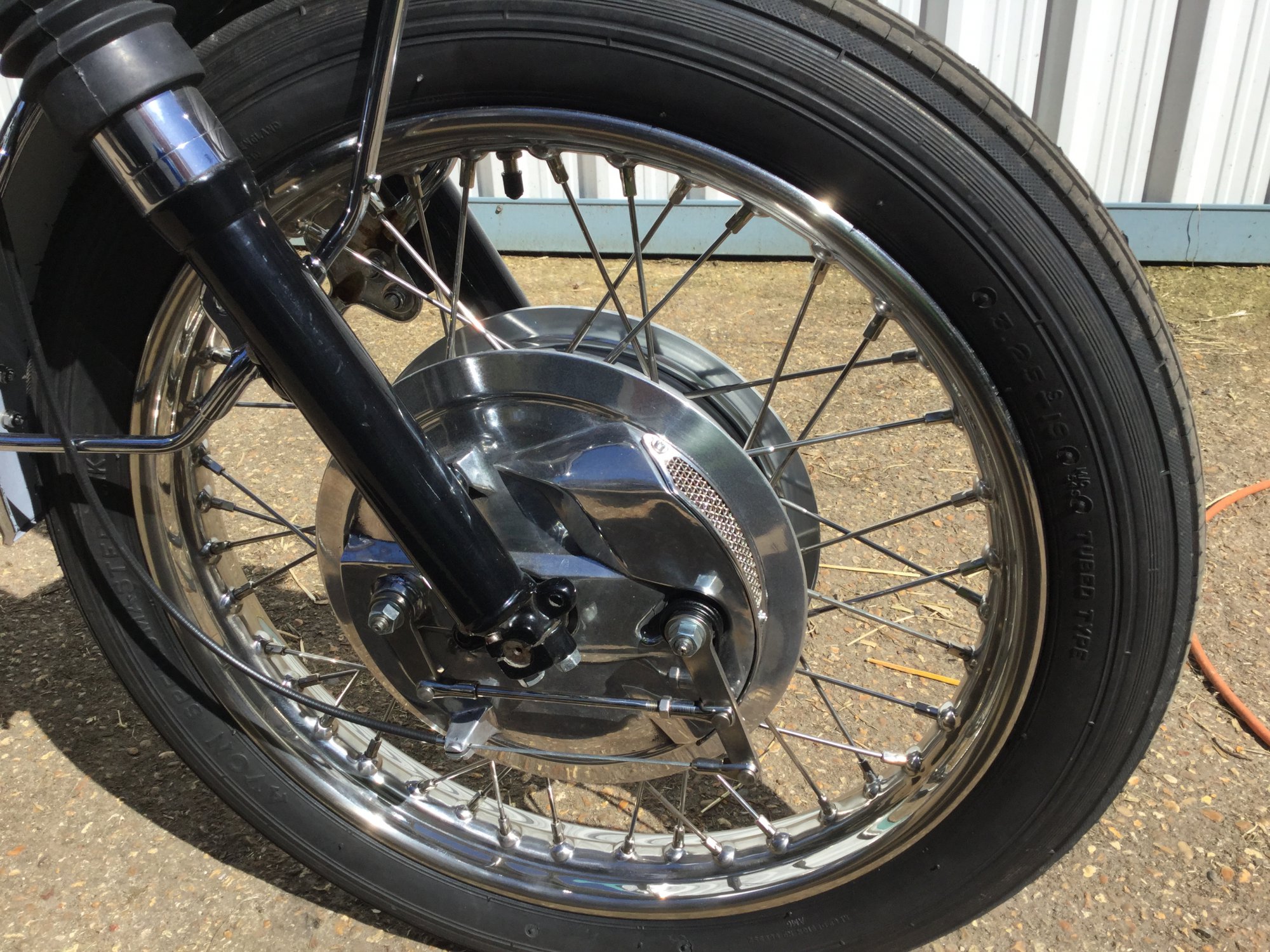

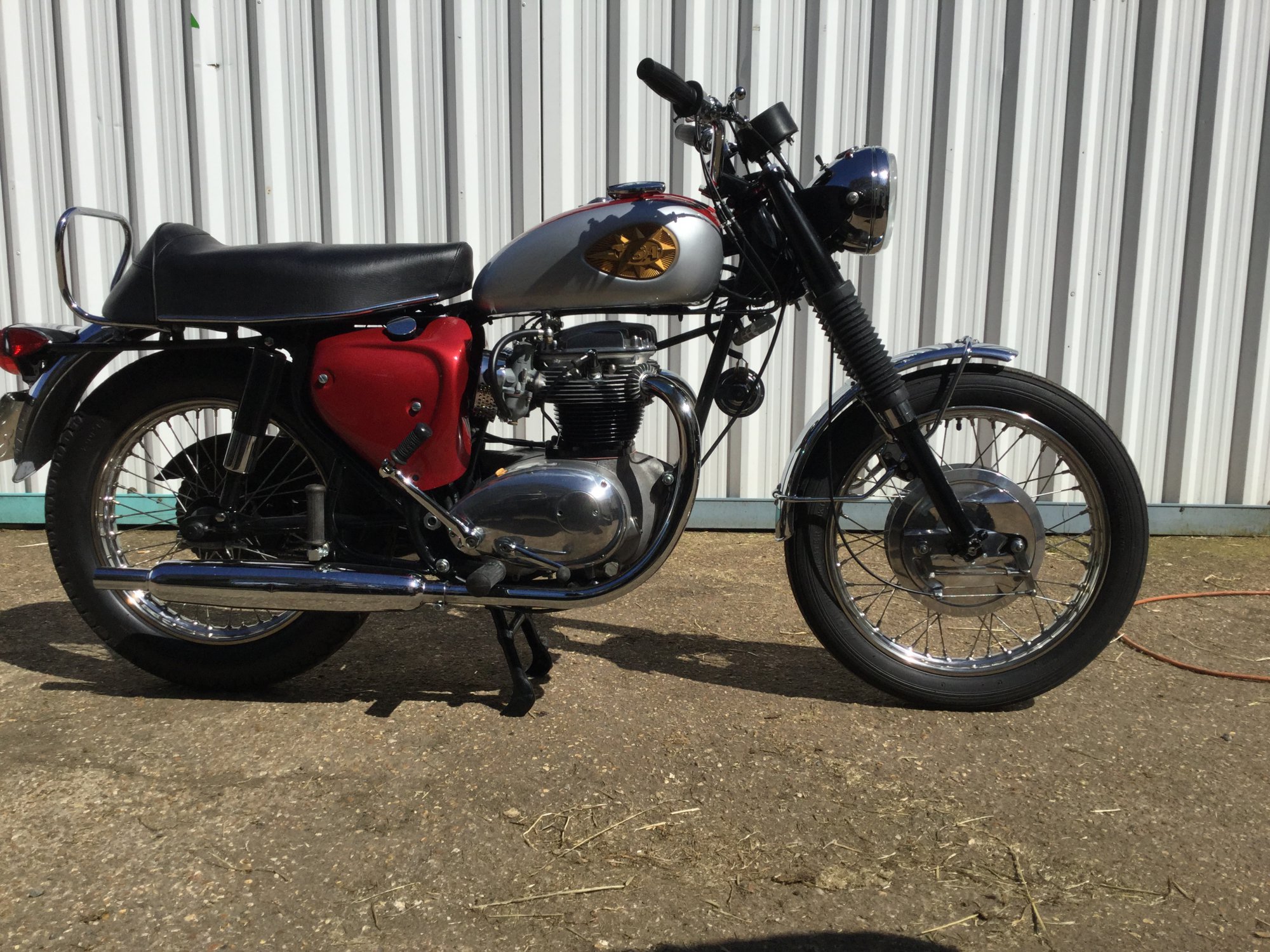

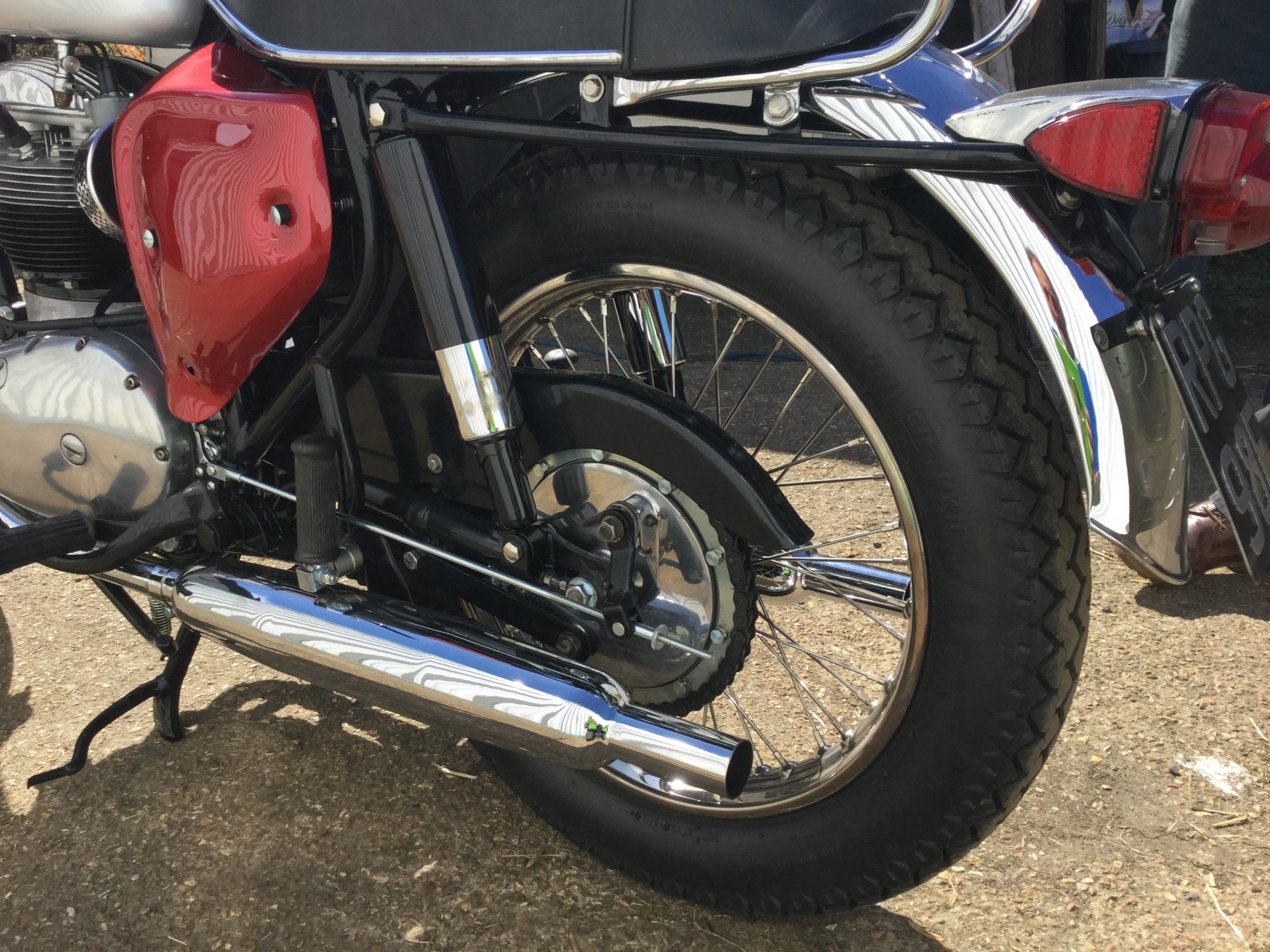

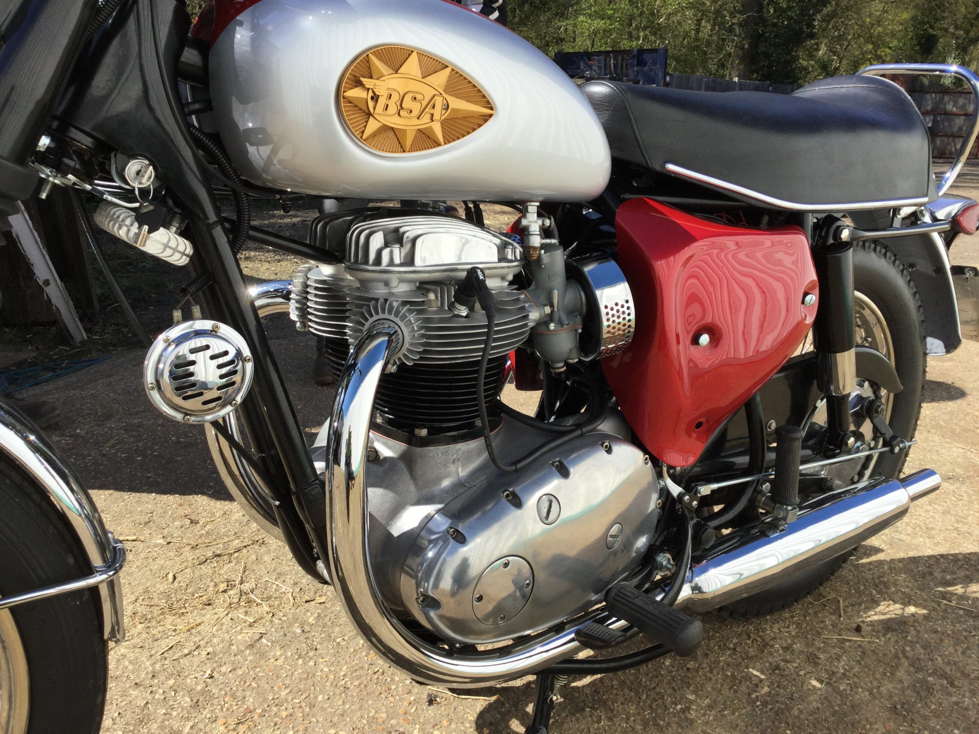

In my long gone biking days I always wanted a BSA but seemed to have ended up with owning nothing but Triumphs. Sorry for the derail but a few snaps of a Beeza one of the lads that worked here restored.
Very nice!!
Is that a Spitfire thought Rocket Goldies were pre unit?Cannot resist uploading this. Anyone know the dealers ?
