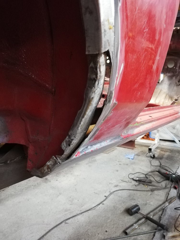

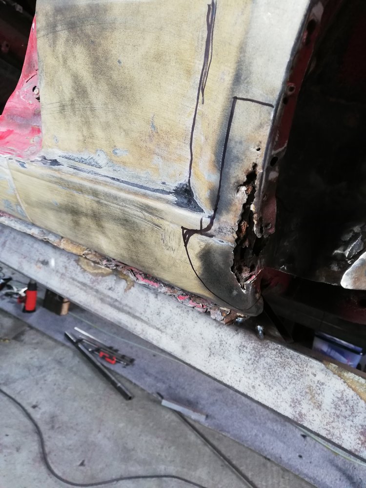

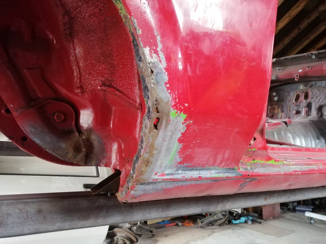

Speaking of welding panels, here's the leading edges of the rear wheelarches:
View attachment 277082View attachment 277083

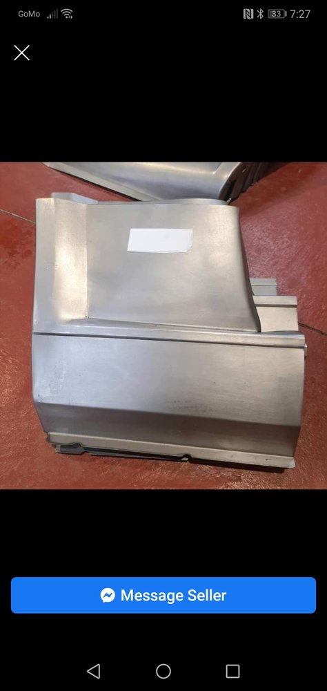

There's repair sections available at the moment:
.... but I'm thinking that I'd prefer to fab the small bit that I require... View attachment 277084

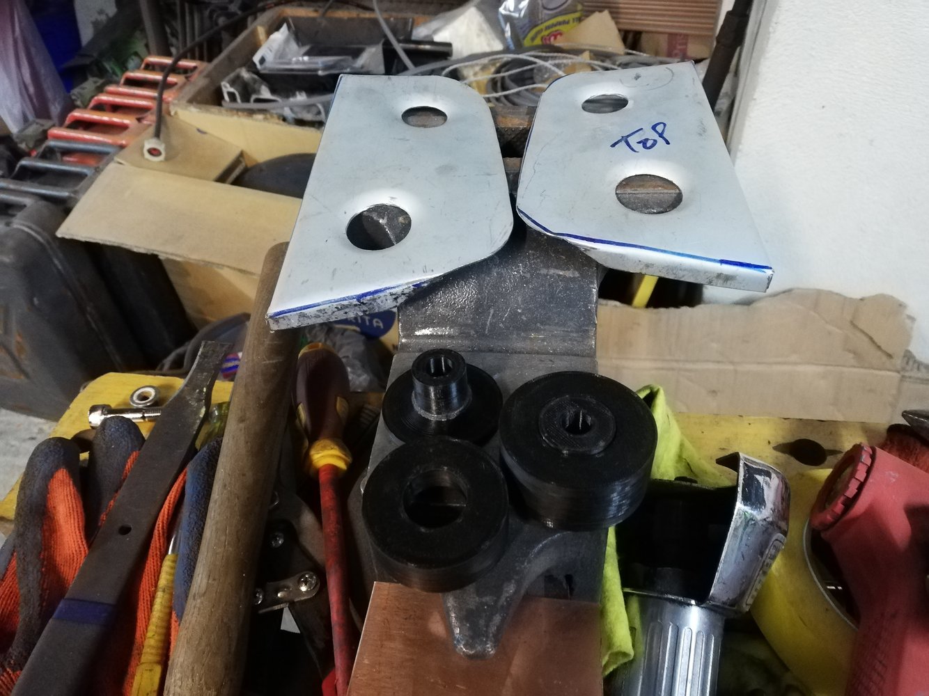

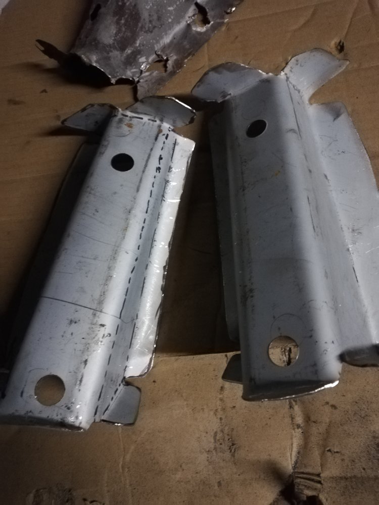

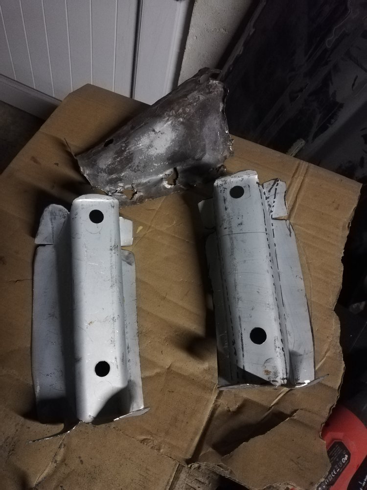

And here's two strengthening gussets for between the front strut towers and the bulkhead...
Good shout will add it to the to the shopping basket
Those repair piece don't look that hot, I'm certain you will do a better job starting from scratch.

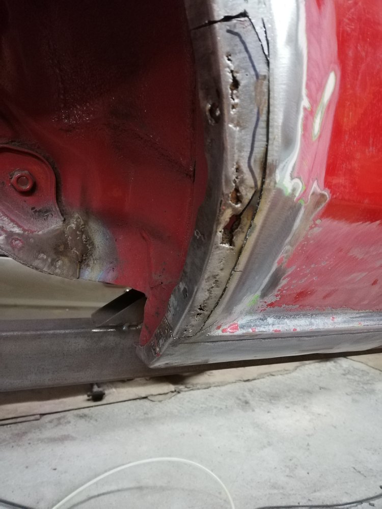

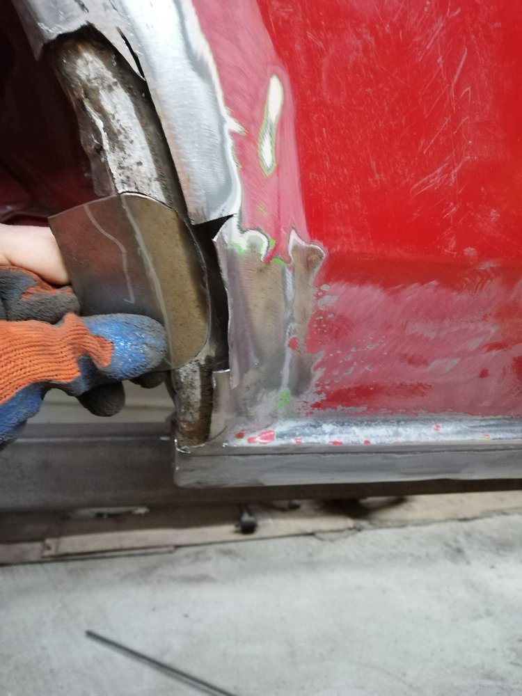

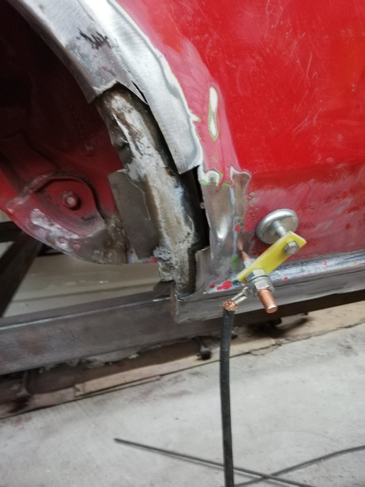

What was the body panel l like here? Did you cut it out to get to the inner arch or was that goosed also?
) shows the corrosion on the outer panel... it was actually worse than the inner...The top of my archs are similar to this so I'm wondering if you did it for the access or because nobody wants to weld upside down
Also the little flap of extra material you welded in is that copying something that was there already or is this to allow you to weld up to the edle of the material with less risk of blow through?
