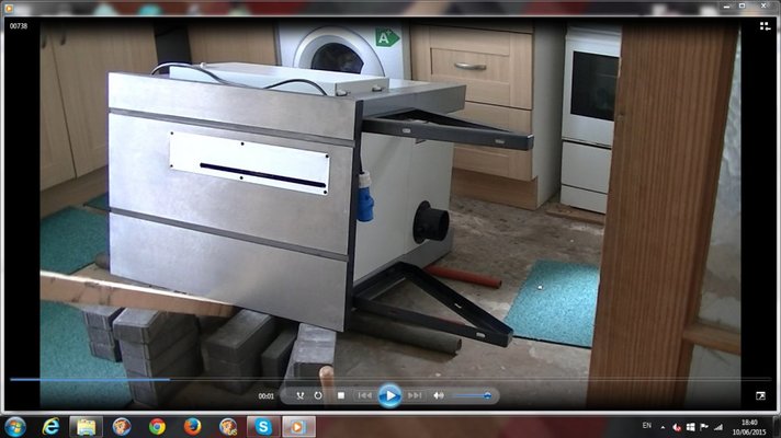

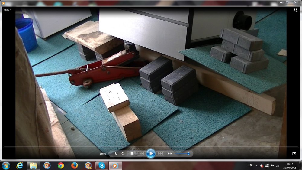

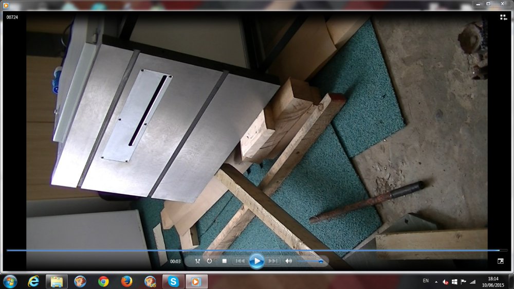

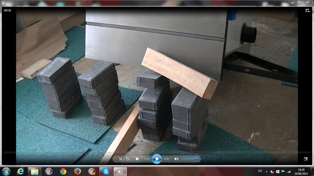

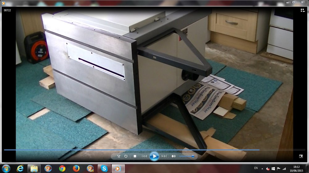

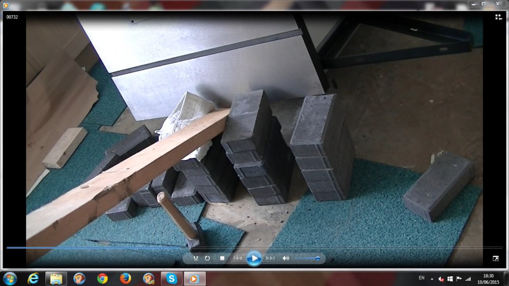

Yes, I think I have enough clear space above the hoist.Do you have the celing height to do this? remember the hoist hook will be above the machine and higher than the highest point of the machine as a result.
Its quite often problematic to use a engine hoist to assemble things like this in low (non industrial) celing buildings.
), than the lifting itself. It will try to throw you over if you allow it to gain any notable momentum, so have someone there just to hold it and steady its pace, if possible, else just counter for the fact that it will happen if you're alone, by slowing your pace and arresting its movement, once you get to the point where you feel it becoming light.
