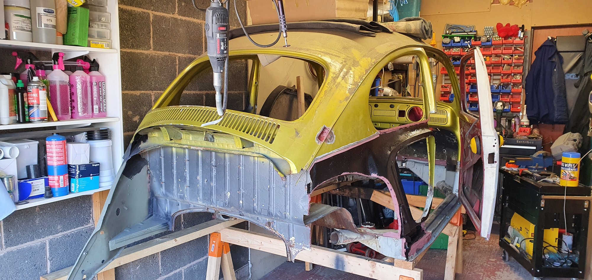

I too went the way of zinc primer as a temporary fix until I was finished welding with the intention of stripping it off before coating with a 2k epoxy primer. If I was to do it again I would etch it with phosphoric acid until the clean metal has a coppery hue (looks like flashed rust). this protects the underlying metal and provides a `key` for any subsequent coatings to adhere to. There will be differing opinions on this, but at the end of the day its up to you to make an informed judgement
