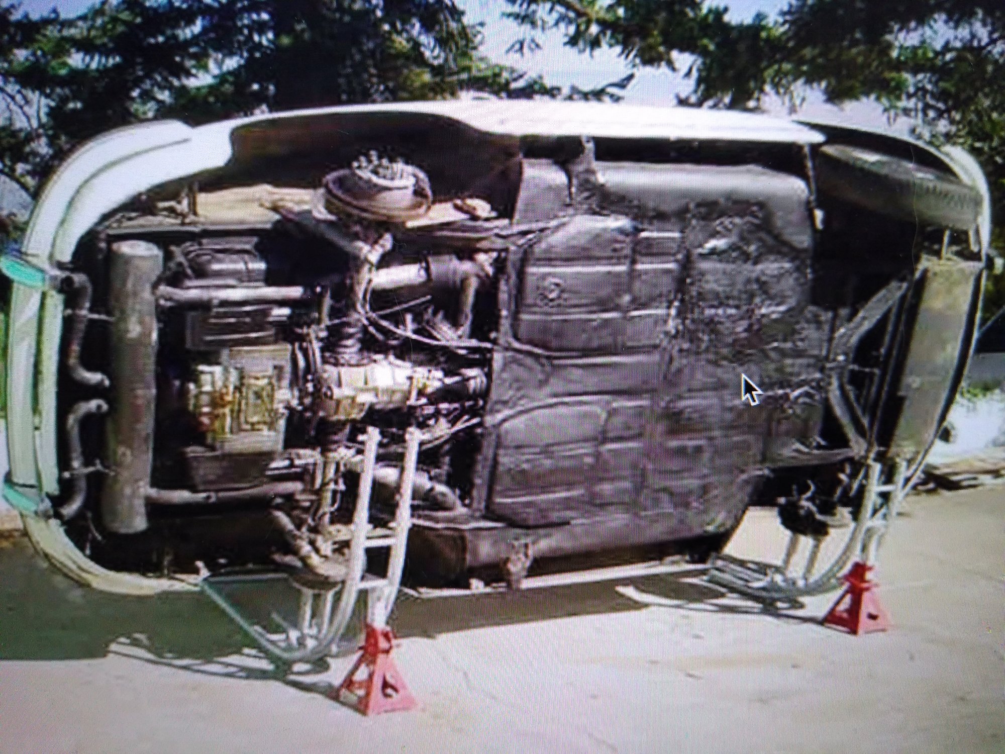

    Make sure you know where the fuel tank and fuel lines are....personally I prefer the tank to be removed if my body has to be under the car. A lot can be done laying next to the car....but sometimes thats not possible and you have to think if things go wrong how quick can you get out.
    Have you thought about rolling the car.....thats what I'm doing with my next project using a roll over jig.
    As minimutly says....fire earwigs are no fun at all. When I did it I used leather aprons to cover my body....still wasn't fund hence the rollover jig next time.

    or roll it onto it's side onto a couple of matresssssss remove door mirror and battery first, with care that can work, especially with a free car!

    I don't have access to a roll over jig, although the matress idea actually seems decent! I may consider it.

    I’ve done it and it works great. Not tried on a ka though. They are pretty fragile when new I think. Hers was not that old at the time and full of rust.
    the other thing I’ve done is got a truck up high with a loadall and put big concrete blocks under the wheels. Not sure what you’re set up is but it’s about using what you have and thinking laterally.

    Wheels on or off? Not sure if I'm being silly or not but since the Ka has steelies I'm scared I'll warp the wheels by tipping it over like that haha. Probably just being silly.

    Thinking about the stresses and margins for the driving loads, rolling the car to 45° is not going to hurt anything; They used to put a tyre down and roll the rally Minis until the door frame rested on the tyre. Just saw an R4 rolled up against a wall with a big cushin between the roof and the wall, along with a load of jack stands to hold it up. Was at about 45° and obviously much easier to get at the underside.
    The shock of hitting a curb with a wheel is multiples of gently rolling it up on them.
    Oh, just remembered.. A French bloke drove a Simca 1000 most of the way round France on two wheels, used a ramp to get it up, after that it was like driving a bike:laughing: car was not modded IIRR

    This is what I bought...they can be had for £200 on fleabay (search for rollover jig or tilter)...when you've done just resell it for £200.
    This is a generic picture off the web....but they all work in the same way.
    The last 2 cars I did lying on my back....just getting too old for it now so decided to try something different.
