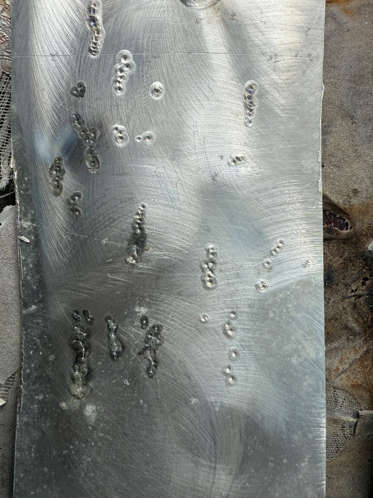

From what I research when trying to weld aluminium in AC torch is in positive terminal and opposite to DC. This what I’m trying to do with the torch being in positive terminal however my arc will strike but won’t establish and hold.With Tig, torch goes to negative and clamp goes to positive. Doesn't matter if using AC or DC, you use it that way.
You need to do better research I am afraid.From what I research when trying to weld aluminium in AC torch is in positive terminal and opposite to DC. This what I’m trying to do with the torch being in positive terminal however my arc will strike but won’t establish and hold.
Where have you read this? I did a lot of research before buying a tig welder at the start of this year and i never found anything that said you should change torch connections for AC, everything i found told me to set it torch negative and leave it alone.From what I research when trying to weld aluminium in AC torch is in positive terminal and opposite to DC. This what I’m trying to do with the torch being in positive terminal however my arc will strike but won’t establish and hold.
Definitely need to do better research, I think you've got mig and tig confused. Mig welding aluminium with DC is possible when the electrode is connected to +positive and the earth clamp is -negative. Tig is always electrode negative and clamp positive.From what I research when trying to weld aluminium in AC torch is in positive terminal and opposite to DC
Where is your HF coming from the welder or a HF add-on unit???From what I research when trying to weld aluminium in AC torch is in positive terminal and opposite to DC. This what I’m trying to do with the torch being in positive terminal however my arc will strike but won’t establish and hold.
