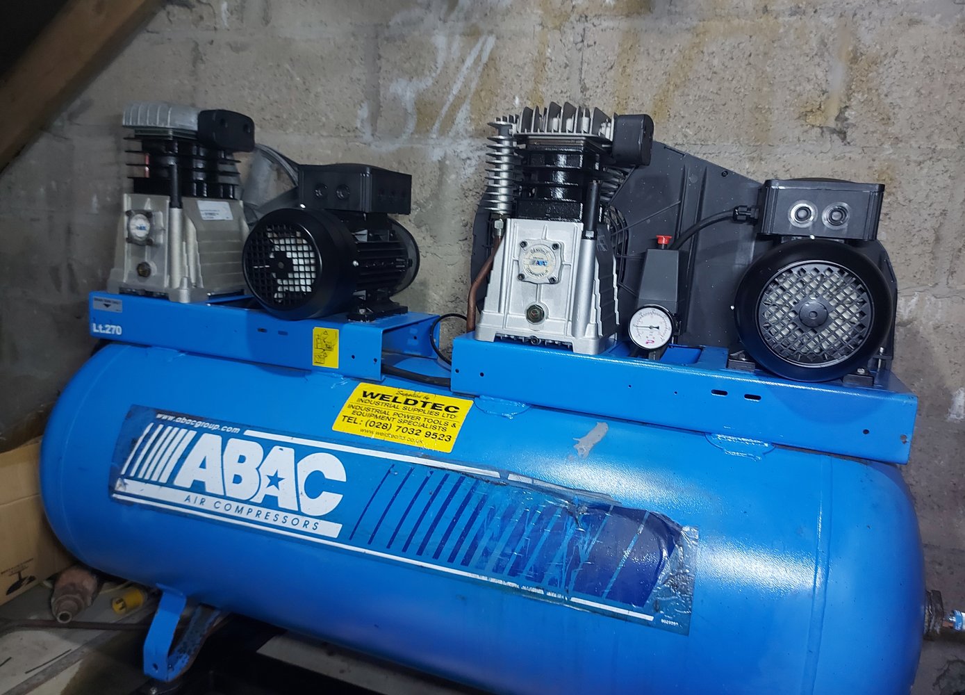

The new NRVs may be here tomorrow according to the tracking.
I did clean up the old ptfe (tape and liquid turned cement like) on the pipe fittings.
This way there is no risk of the new valves getting contaminated by debris.
I will use a few wraps of PTFE tape over the olives themselves before assembly to ensure 100% seal. No liquid sealers will be used due to high risk of downstream contamination.
