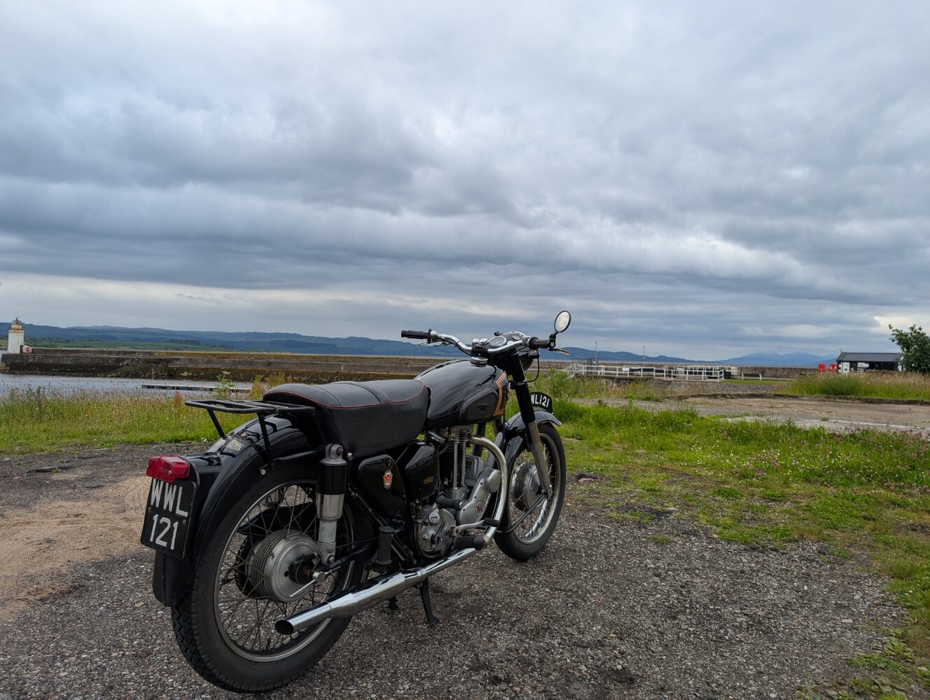

Matchless finally got electrics and headlamp back together, fired up first kick, hopefully a run tomorrow:

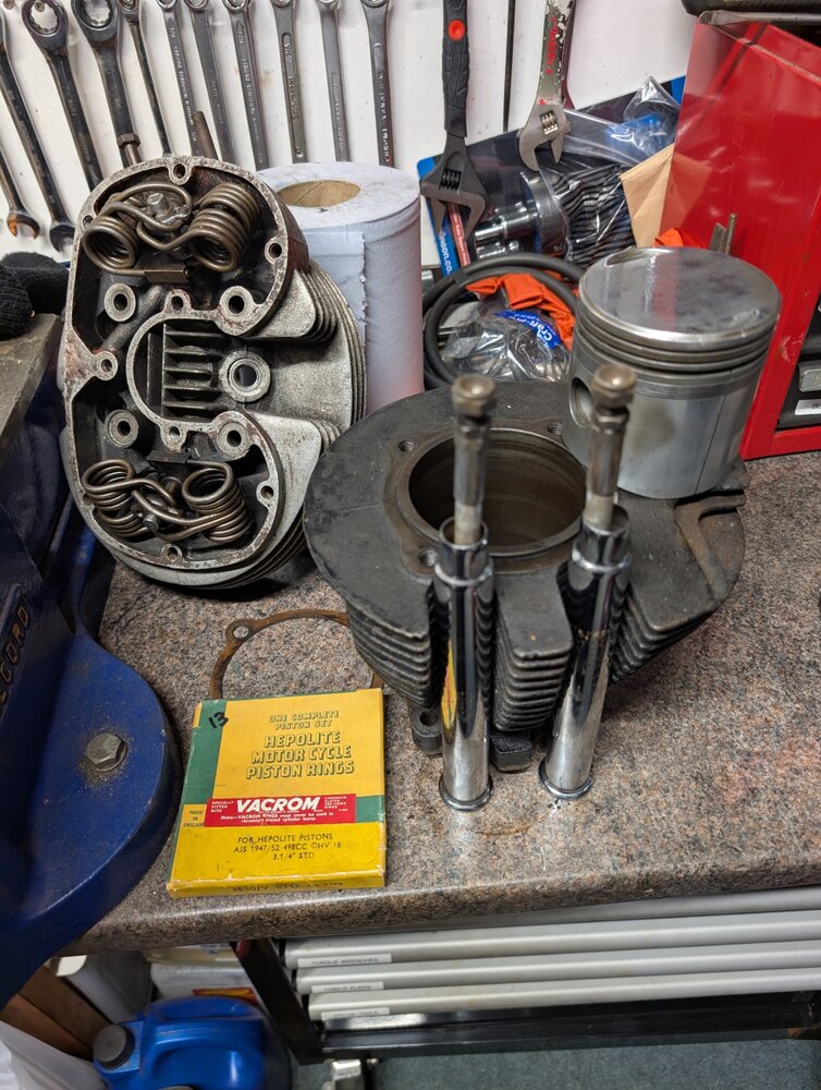

v twin here . its been done already need 2 sets of cases i can weld them
AJS and Matchless 1950's singles are selling for peanuts now: £1800 to £2500 for a roadworthy solid bike, matching numbers make little difference provided same engine. The 500 and 350 crankcases are identical so just for a capacity conversion the numbers would not change.Firstly, I know nothing of proper classic bikes, what about the impact on a matching numbers original bike? At what point does this work start increasing the value over a nice original bike?
Nice work by the way.
There was a drag bike like that. I saw it at Santa Pod in the late 80s. A fairly common upgrade I believe.I saw a bike in a magazine years back, a Harley '45 with Matchless heads and barrels.

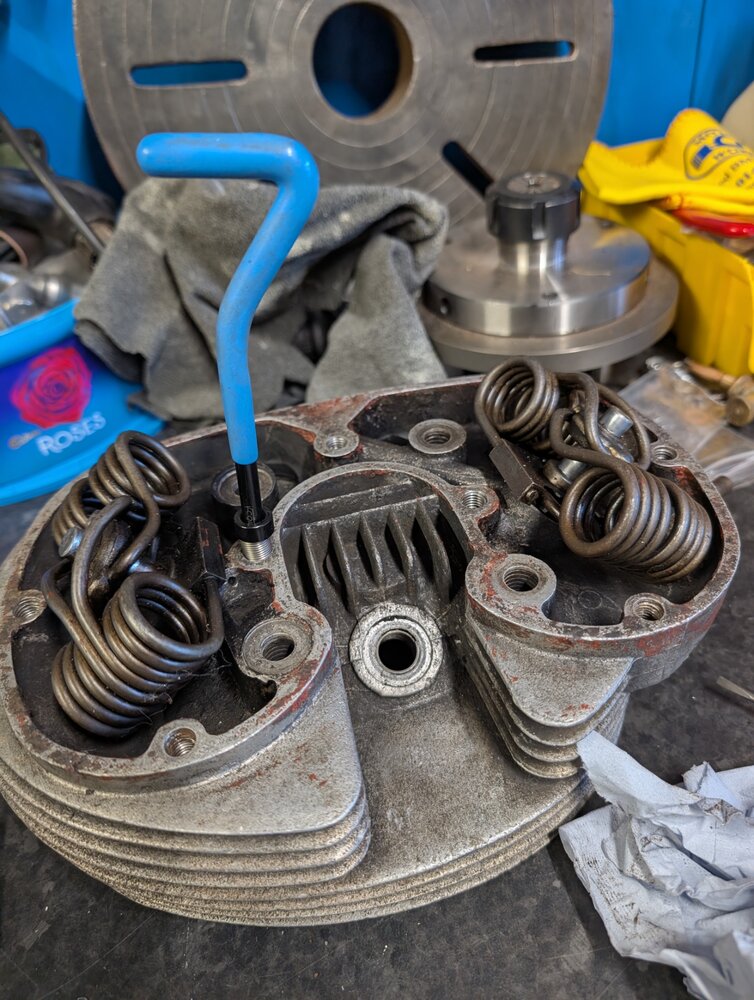

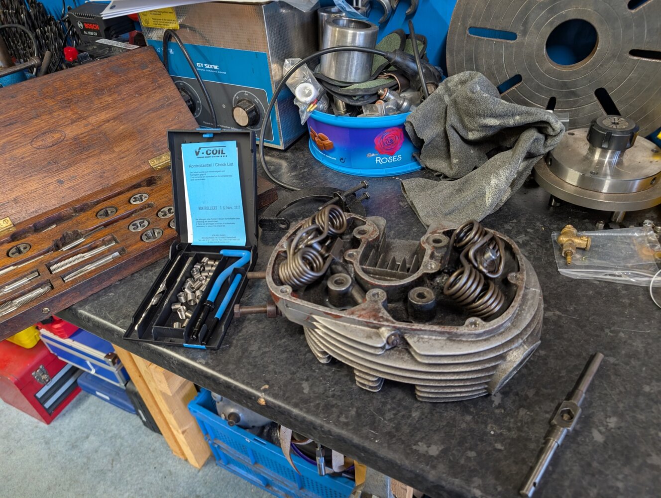

Decided I would start the clean up of the head this afternoon:

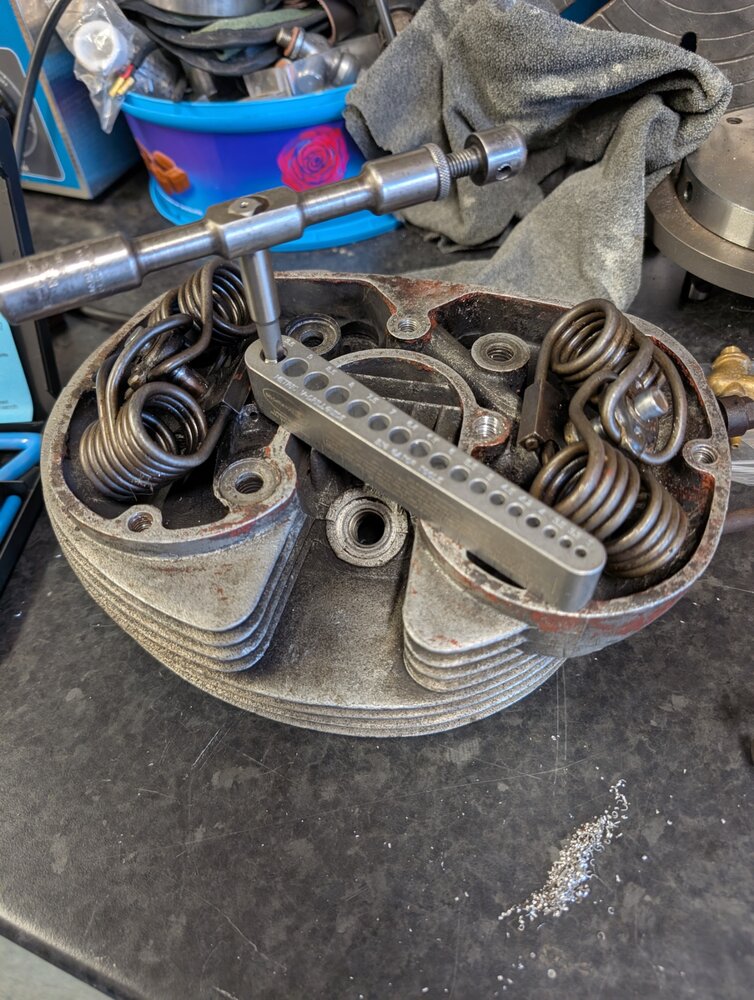

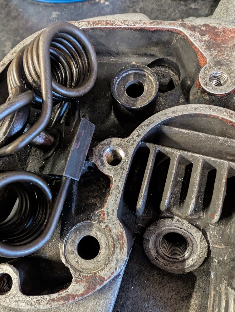

First I cleaned up all the rockerbox mounting threads: 5/16 BSF tap only to find 2 were stripped, so out with the helicoils:
Used a guide to ensure threads are square to mounting face
I keep a supply of most BSF size helicoils

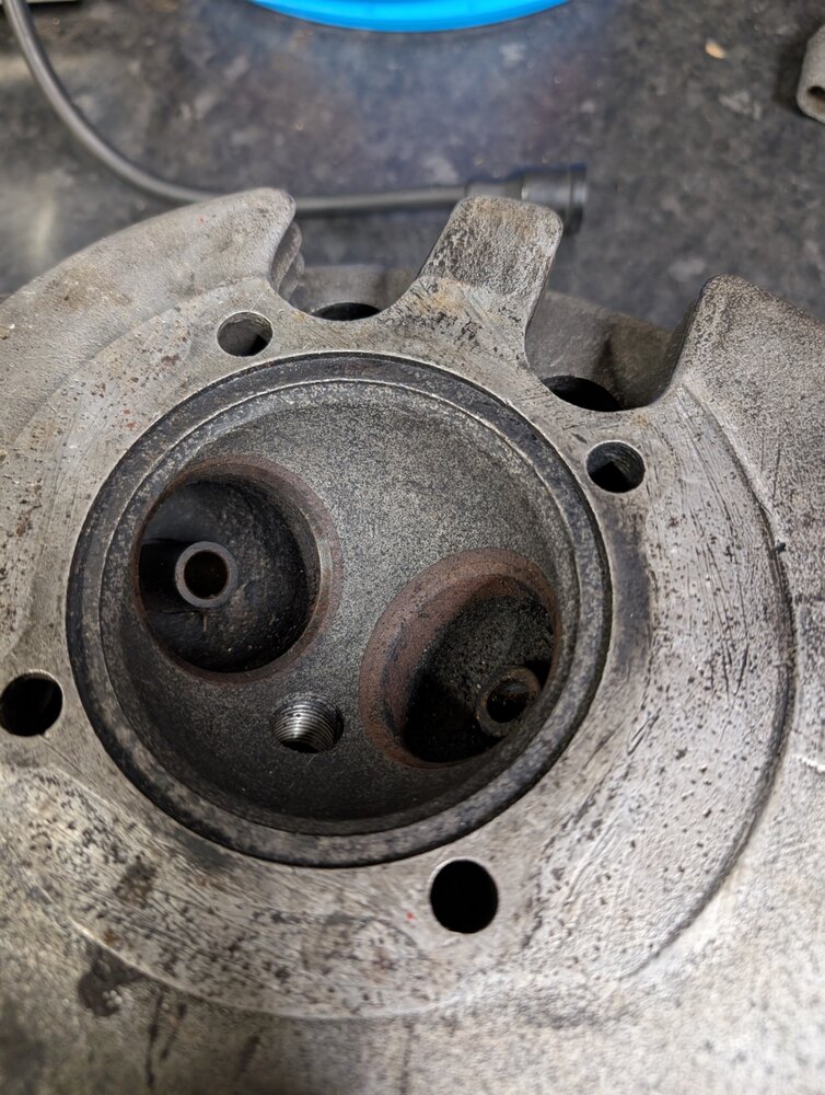

and done, I can see someone has done the spark plug thread already

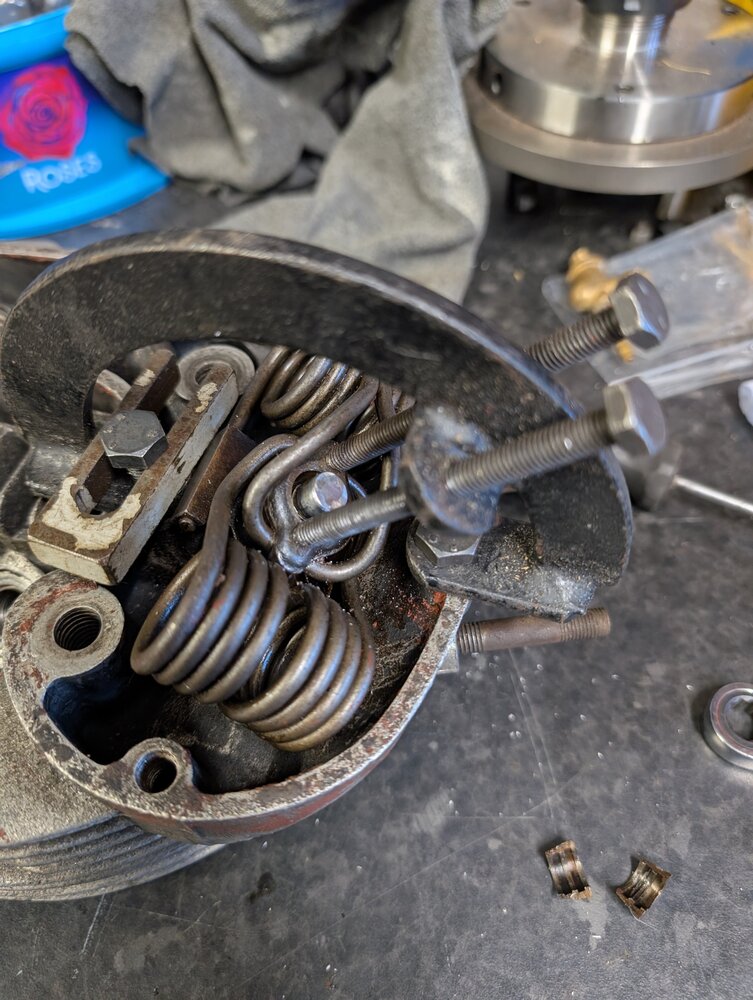

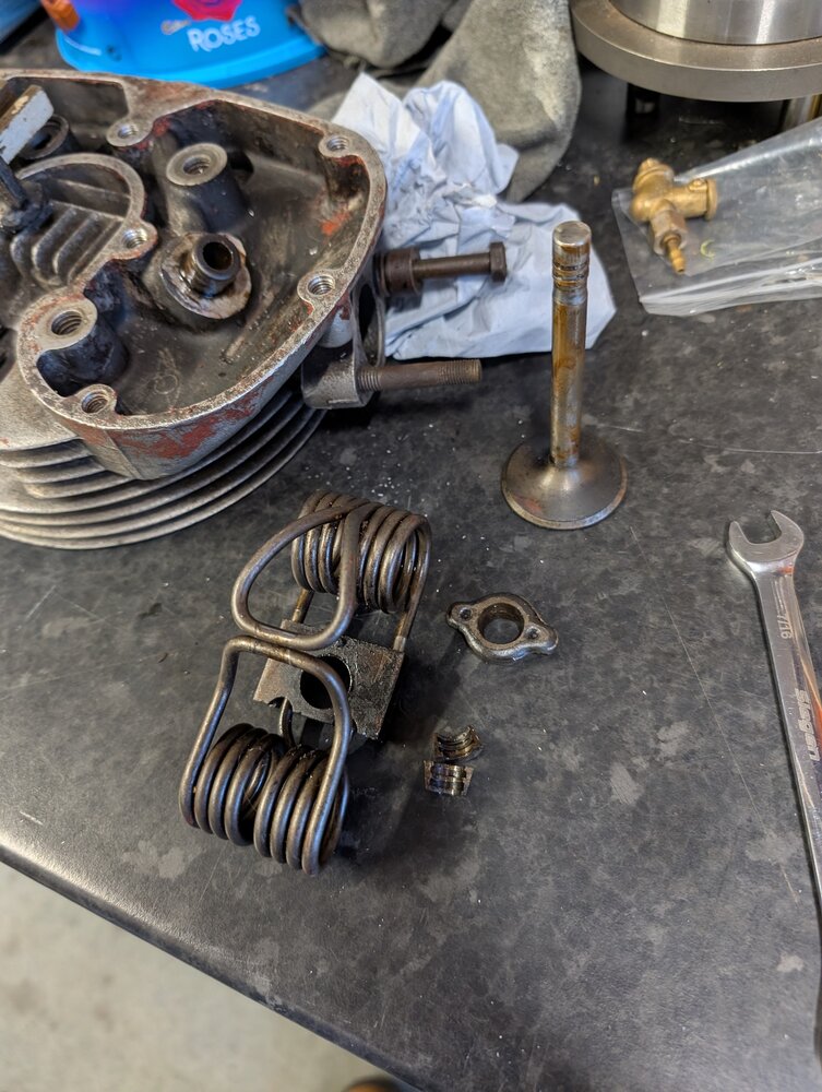

I use the repaired threads for mounting the valve spring compressor, do not think many if any modern engines use hairpin valve springs.
the tool makes it an easy job, valves and guides seem very good
Ducati always did, but I don't know about the modern ones?
IIRC it was in a very small 2 seat sports car type of thing.Didn't Excelsior make a three cylinder two stroke as well?
Originally they used them from the mid 30's as more reliable, offer better exhaust valve cooling and better at high rpm for race bikes, also do not suffer from resonant frequencies.. Only used in the heavyweight singles and race bikes, the twins used conventional coil springs. By the late 50's metallurgy had improved and coil springs were cheaper to accommodate.Hadn’t realised those AMC SINGLES used hairpin springs,do the twins aswell?
