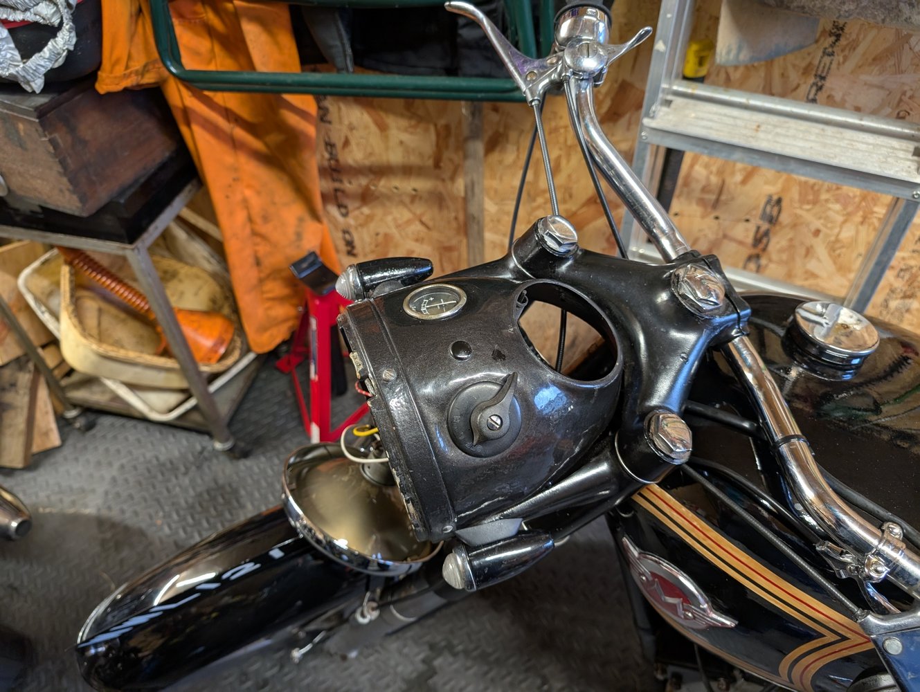

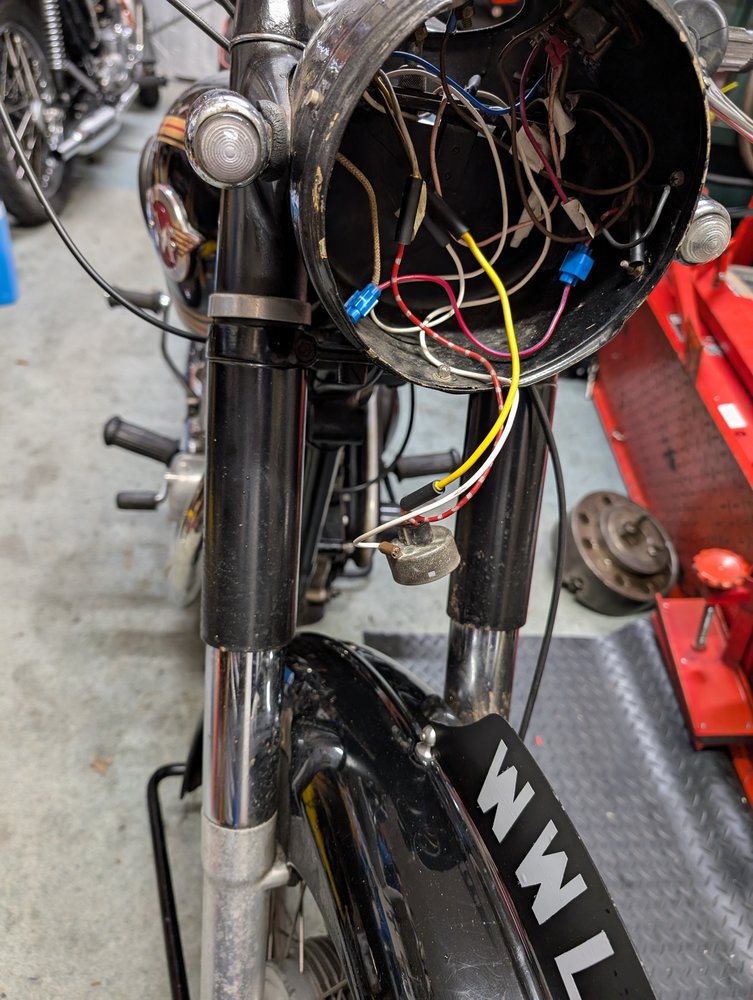

Absolutely, they were in the bin last night.I'd get rid of the scotchlock connectors in the headlamp shell, they are usually a source of future problems.

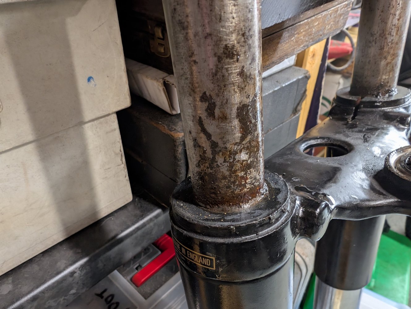

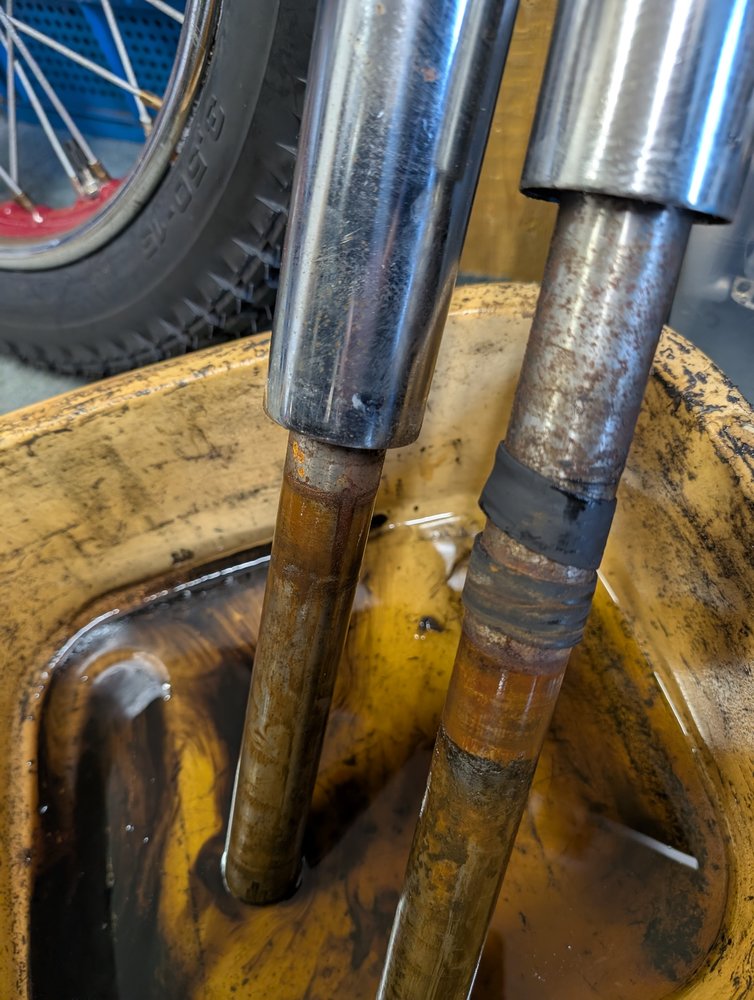

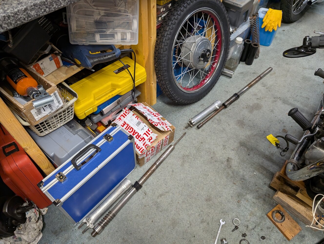

The springs are external to the stanchion and removed so sitting at the end of the stroke, its the part from above the seal travel up that is rusty. So hopefully they can be reused.Wow!

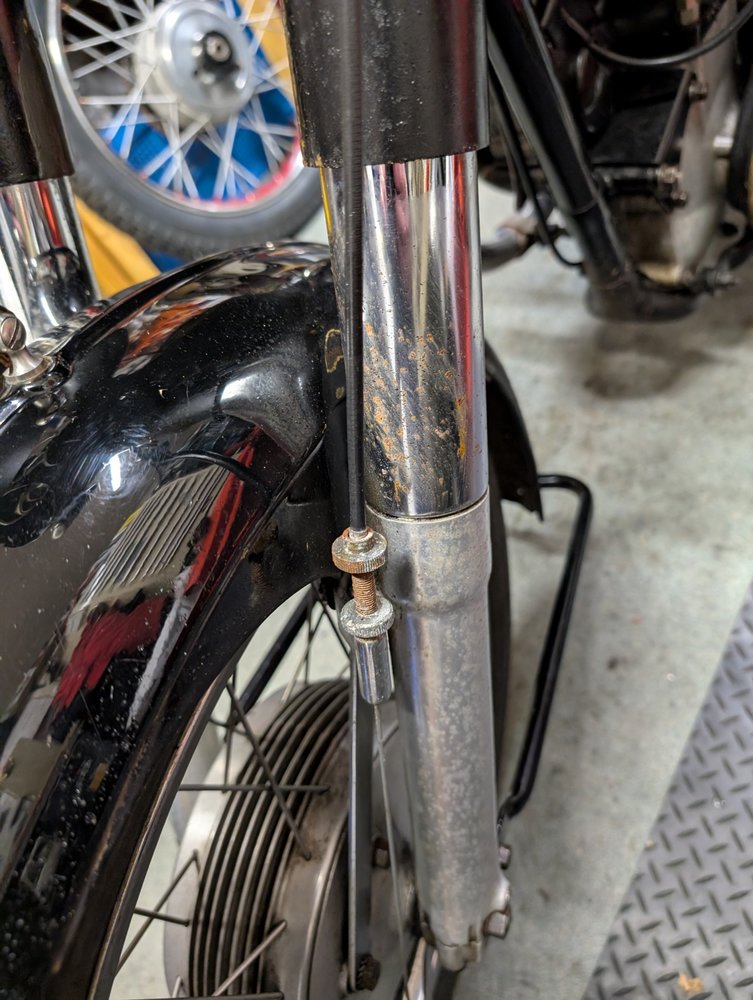

I'm surprised they didn't go down and stay down when riding.

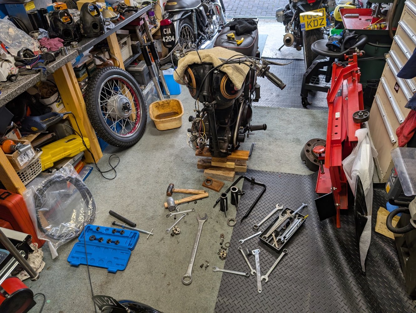

Yes, but it's in good hands!Bike looking a bit sorry for itself for now:

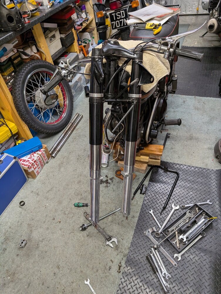

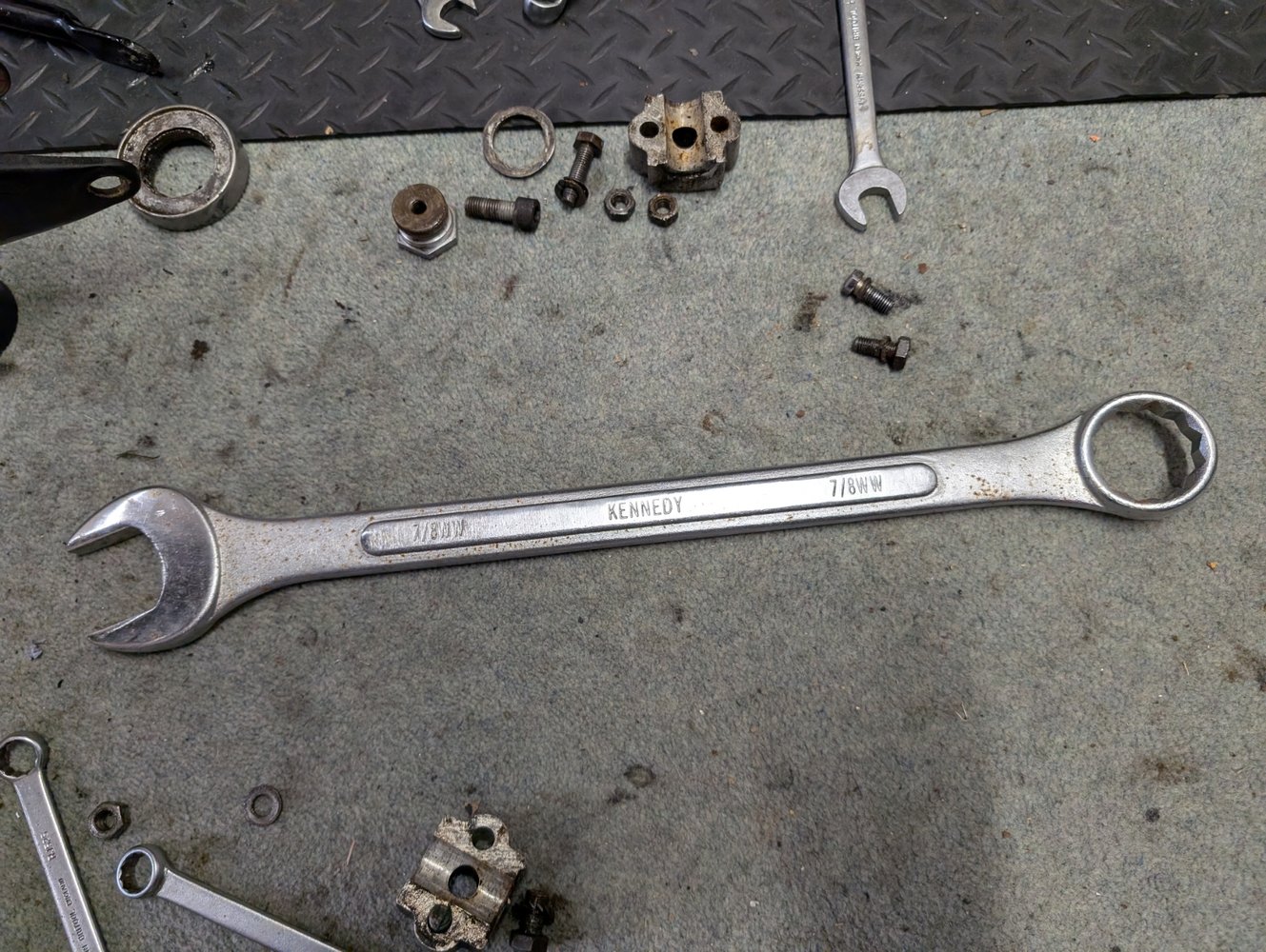

Greasing the hidden sections was something that i always did.Forks now dismantled, needed to drop the lower yoke to access the rusty stanchion, so out with the big Whitworth spanners.
can see the problem:
Wire brush then penetrating oil:
There was plenty oil in them and it was clean.
Why folk don't grease the fork stanchions prior to assembly!
Me tooGreasing the hidden sections was something that i always did.

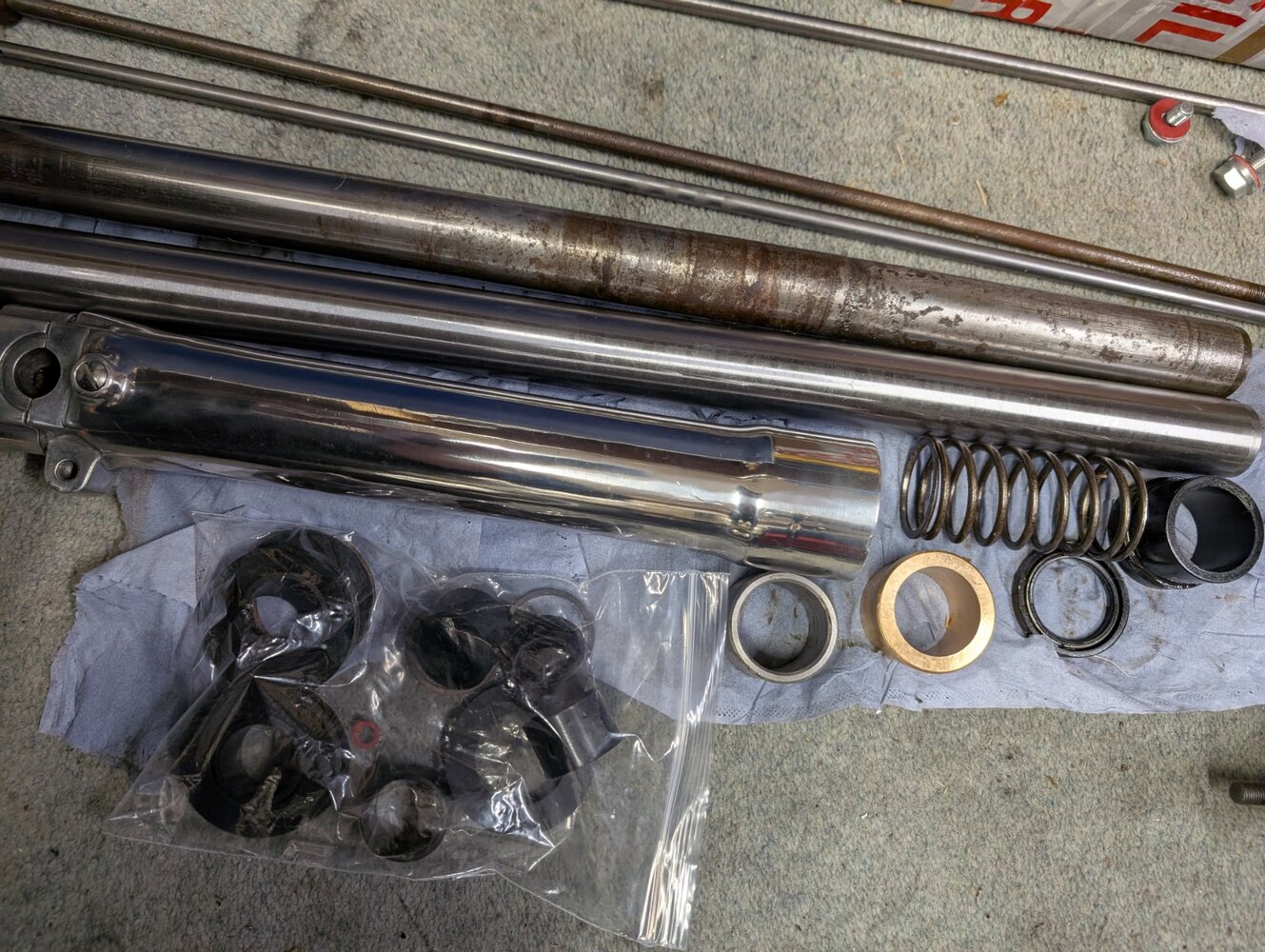

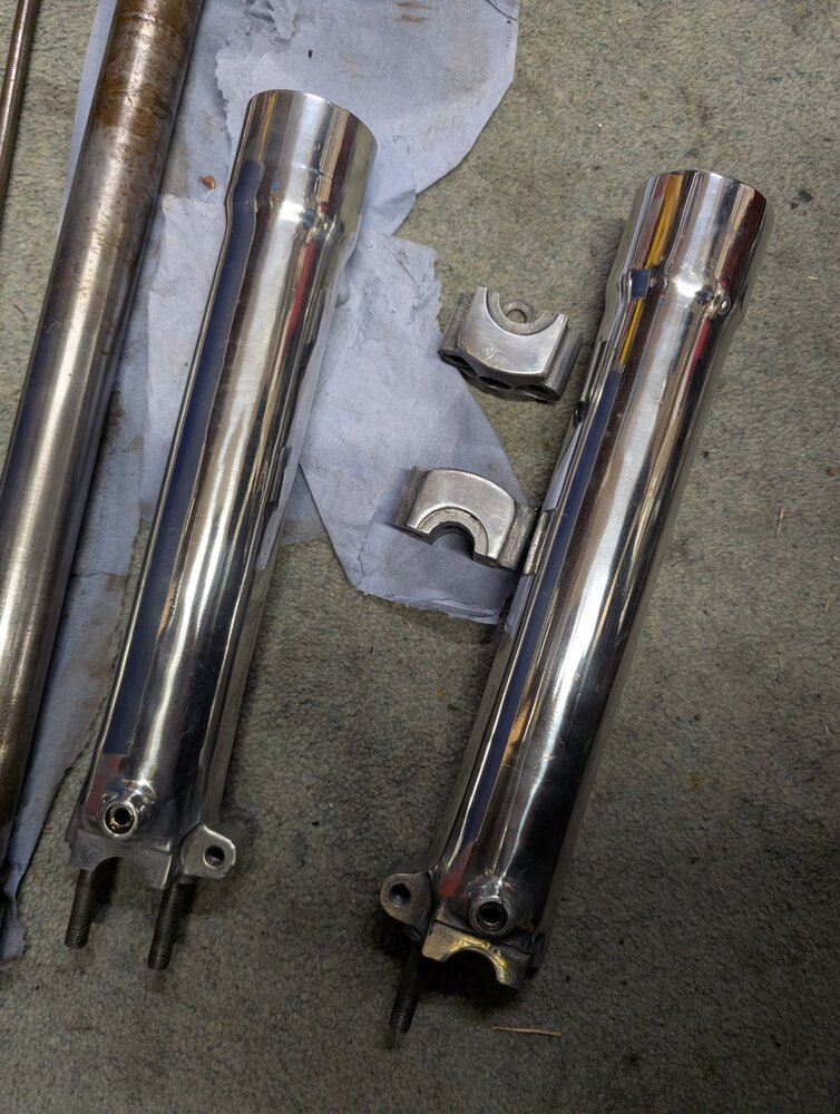

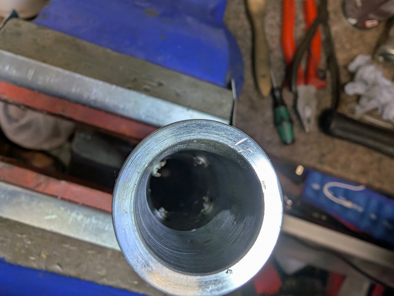

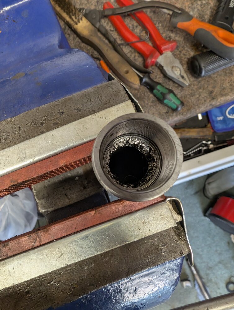

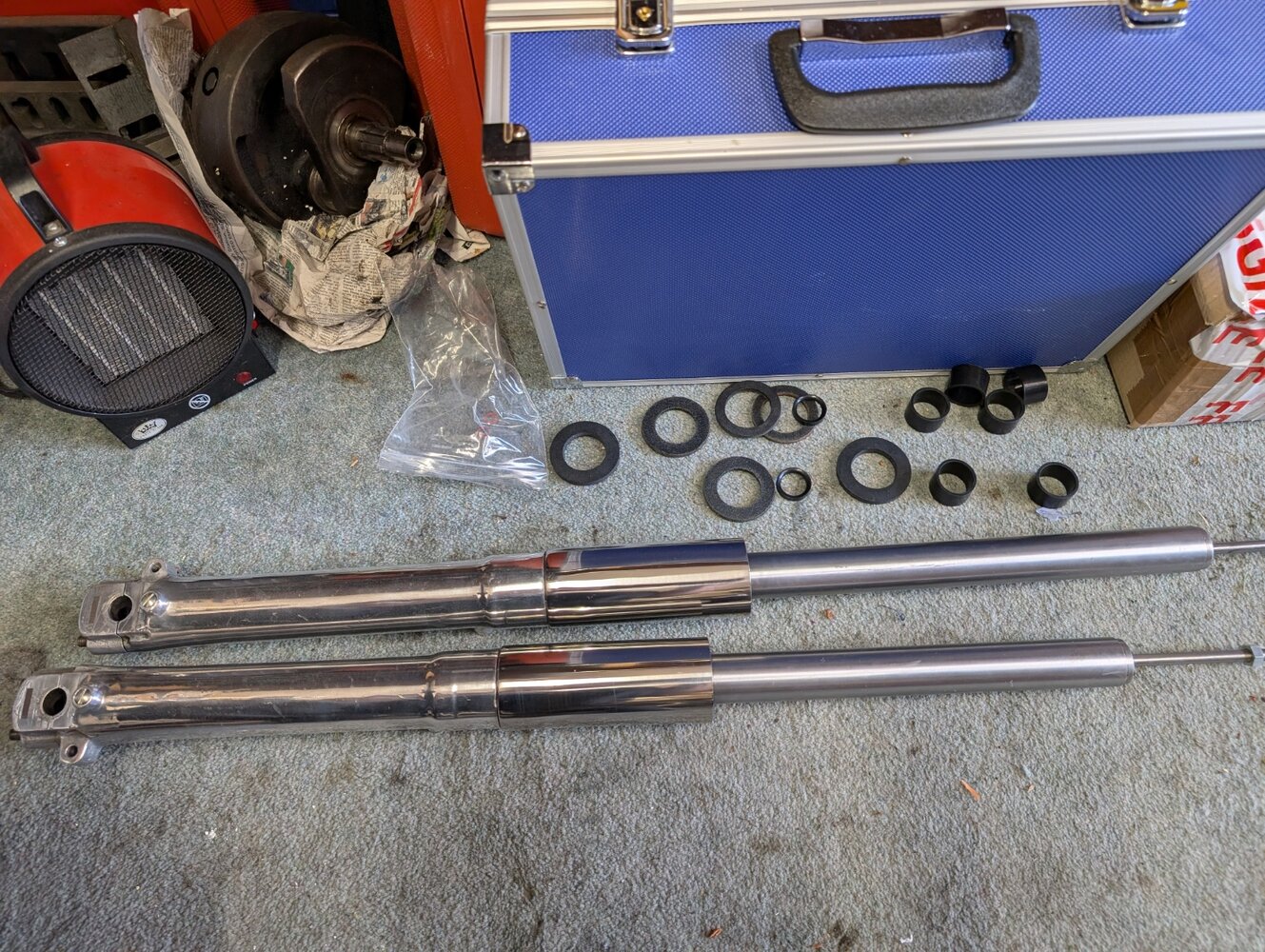

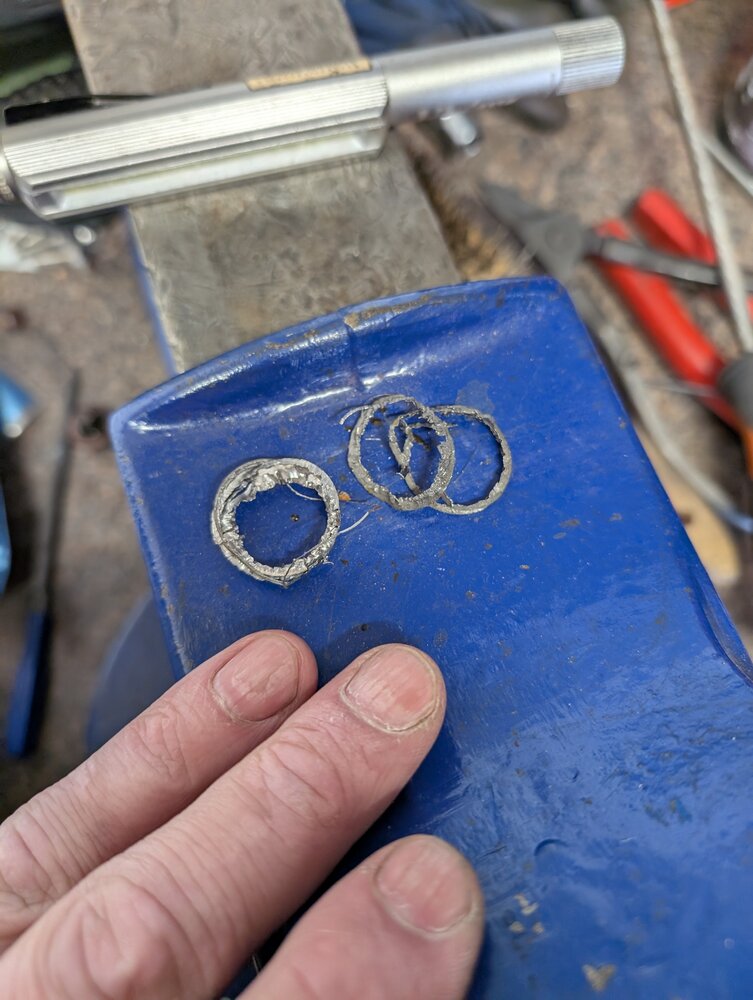

So who was this P.P.P. "Purveyor of Perfect Parts " or could they be called "**** Poor Presales Preparation. " ?The other end of the stanchion was worse with swarf:
so a little filing and deburring.

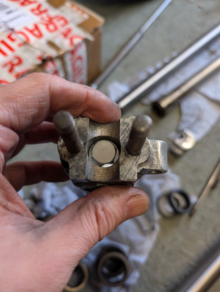

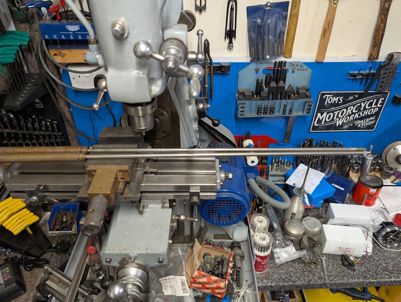

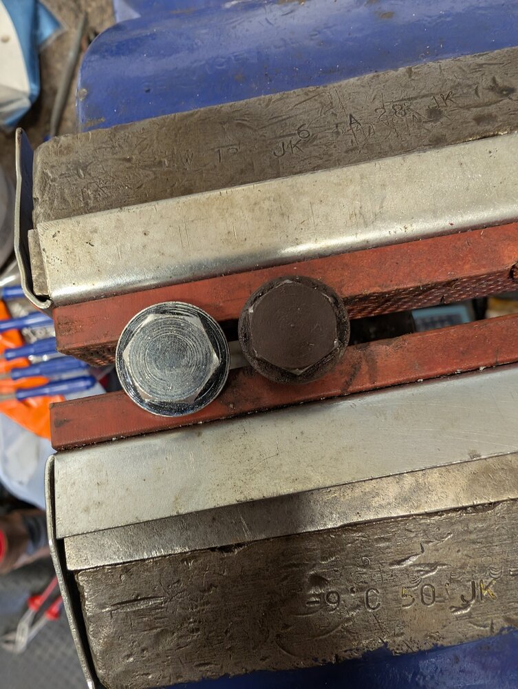

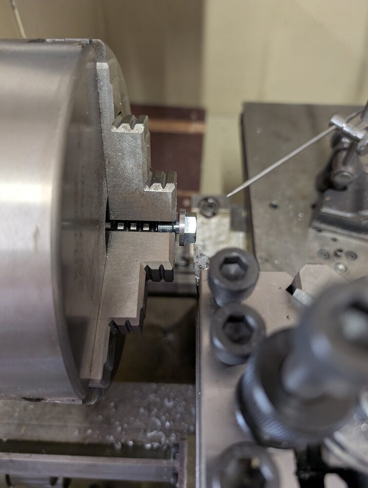

Next found the new damper rod bolts were 60 thou too large:
So onto the lathe:
and perfect fit:

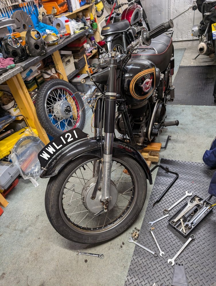

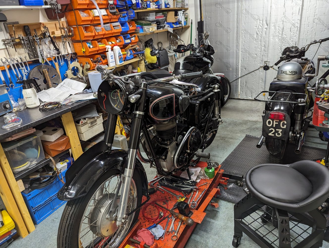

So finally got the forks assembled with new stainless oil seal retainers.:
then on with all the rubbers, leather washers and springs then assemble to the bike:

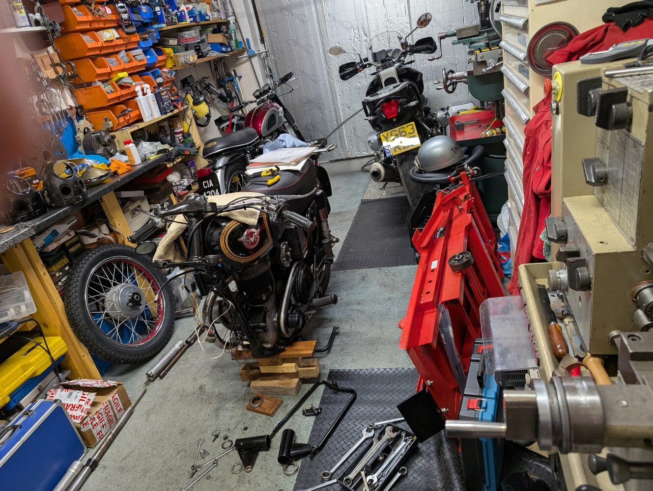

Also dragged the R75 out from the back of the shed, its due a service, though is running well.
I am out tomorrow night, so will get back to it on Saturday.
RGM Norton Ltd., I emailed them pictures to check their stock.So who was this P.P.P. "Purveyor of Perfect Parts " or could they be called "**** Poor Presales Preparation. " ?
