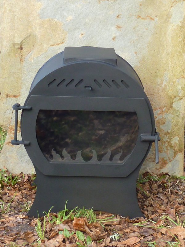

been burning wood to heat the the house for 12 years-only tar I've seen is on the road to repair the potholes-however-you are correct in that tars can form in chimneys/flues if unseasoned wood is burnt-moisture/humidity on longer flue runs I've seen tends to form on the outside of the flues and runs down to get burnt off on the stove top and the fumes go unoticed in the Gauloise cigarette smoke.

Having said all that, there is value in pointing out potential pitfalls in projects/designs in posts because they are potentially read by many more people than actually comment and may be found by the uninitiated through an internet search.

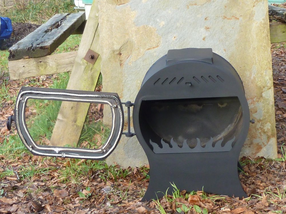

If you have any pics of woodburners you have designed and built and can post them it could be useful-I had not really thought about fabricating my own wood burner until today-I'd be interested to know how they stand the test of time if mild steel-as the norm is cast iron.

But the insurance cos. do require that you have the flues swept yearly by approved bods. This is typical jobs for the boys, very common here. Life is controled by the Ins cos. Even a wrecked car in your back field has to be insured. But the French take little notice of the regs.
) On the prototype I had an inlet at the bottom as well, as I thought I'd need it to get the fire started - I didn't.
