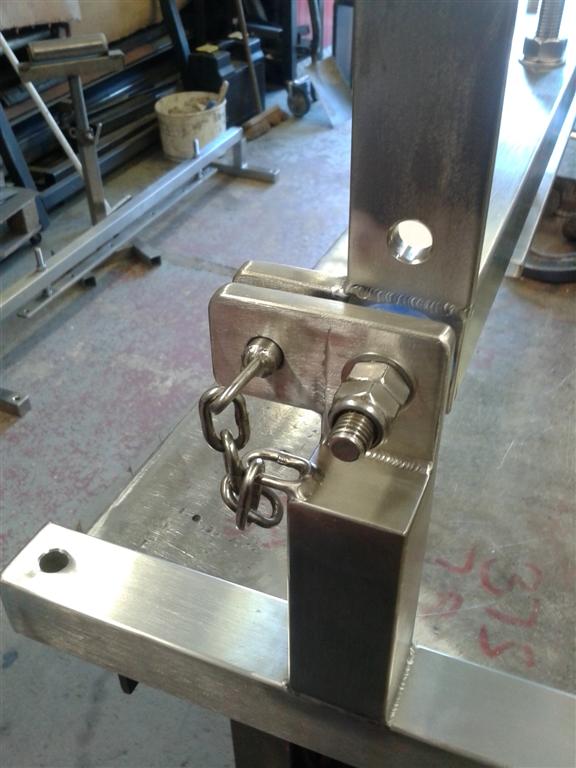

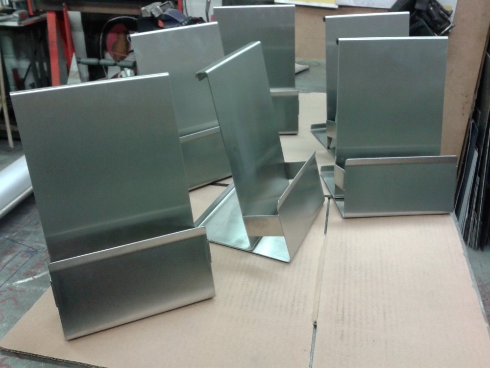

Neat little idea.Just pickling paste scotchbrite soapy water, and a bit of patience, no more than 15 to 20 mins to clean that up, also I always clean or polish every component before assembly to make things easier.

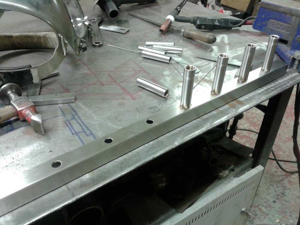

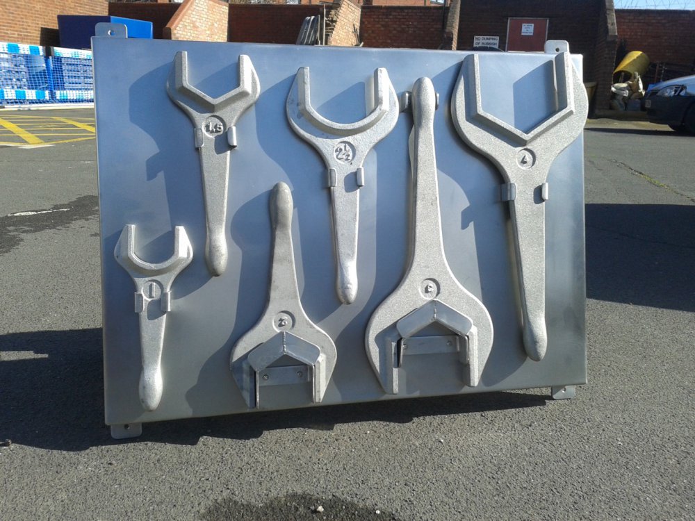

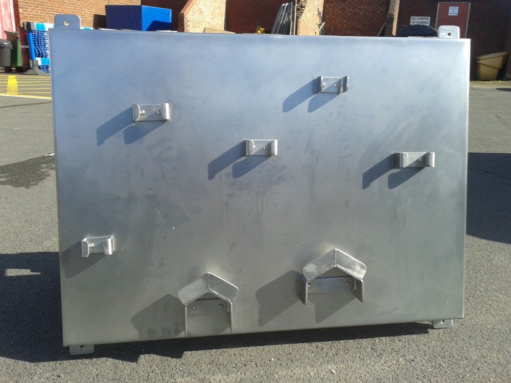

That's one hell of a shadow board, not sure how you can lose a four inch spanner though it is not like you could get home and find one in your back pocket then stash it in the kitchen draw of useful found items.And this is what they are for, storage of RJT spanners for a food factory, bet they will still lose them though

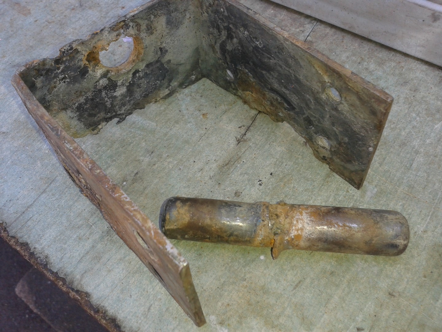

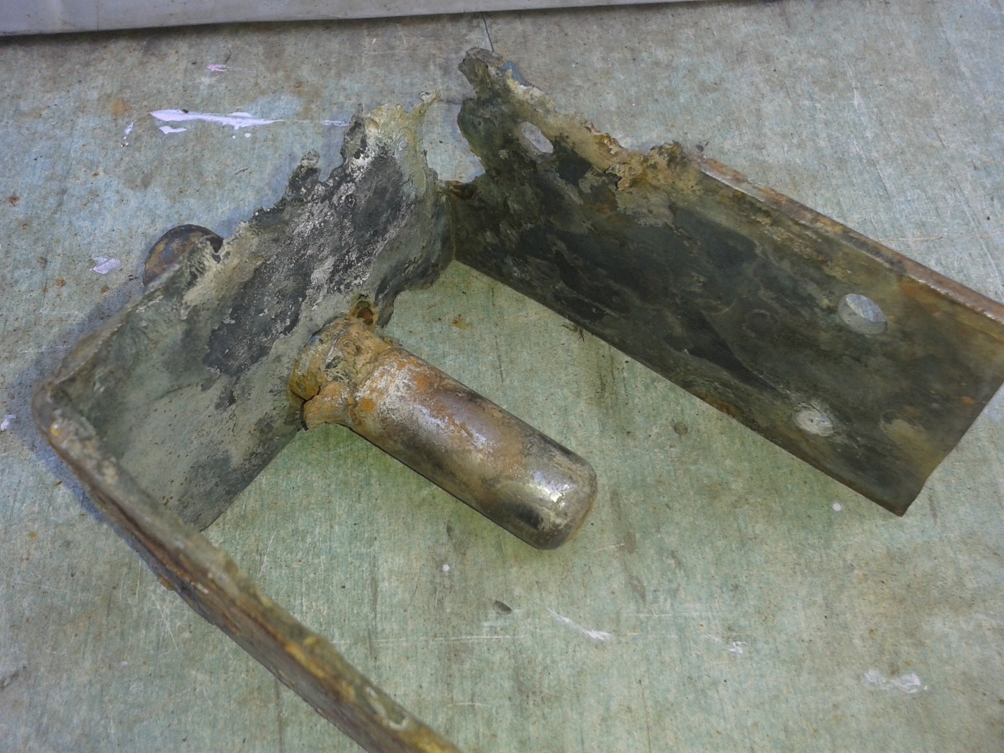

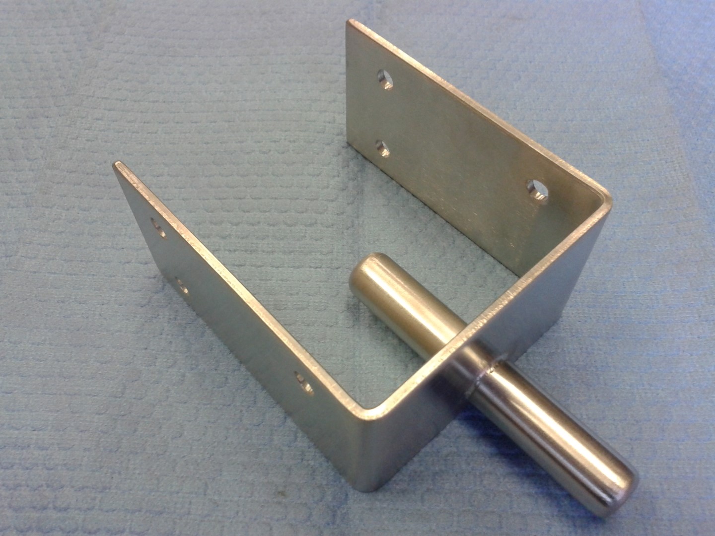

Could have been anything, but you would expect 316 on a marine component, I suspect the weld was attacked from the root, it was only welded one side and the pin had a deep groove of corrosion, and the weld had completely failed, the new one is fully welded to seal it up.Any idea what grade the old one was? I thought 316 was pretty much indestructible in marine conditions.
