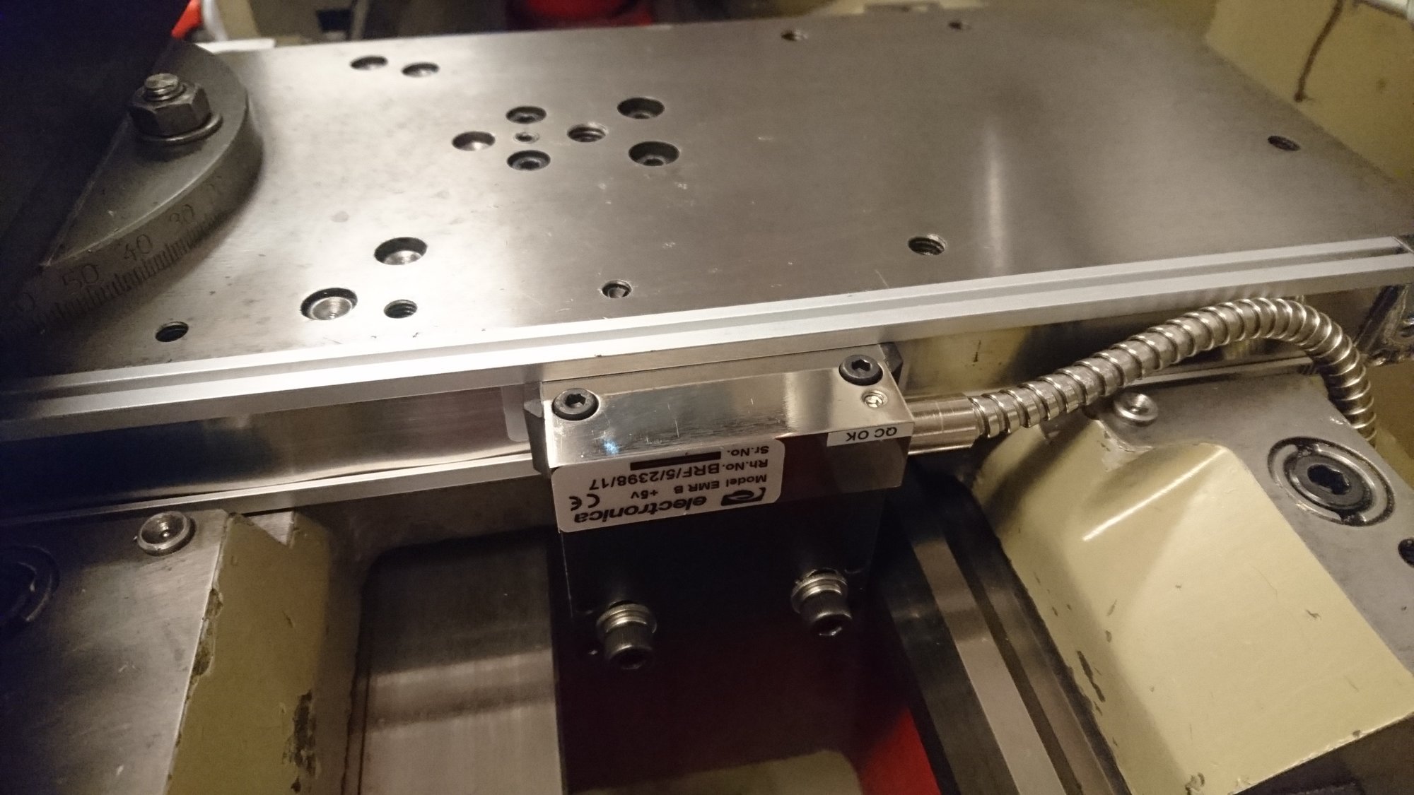

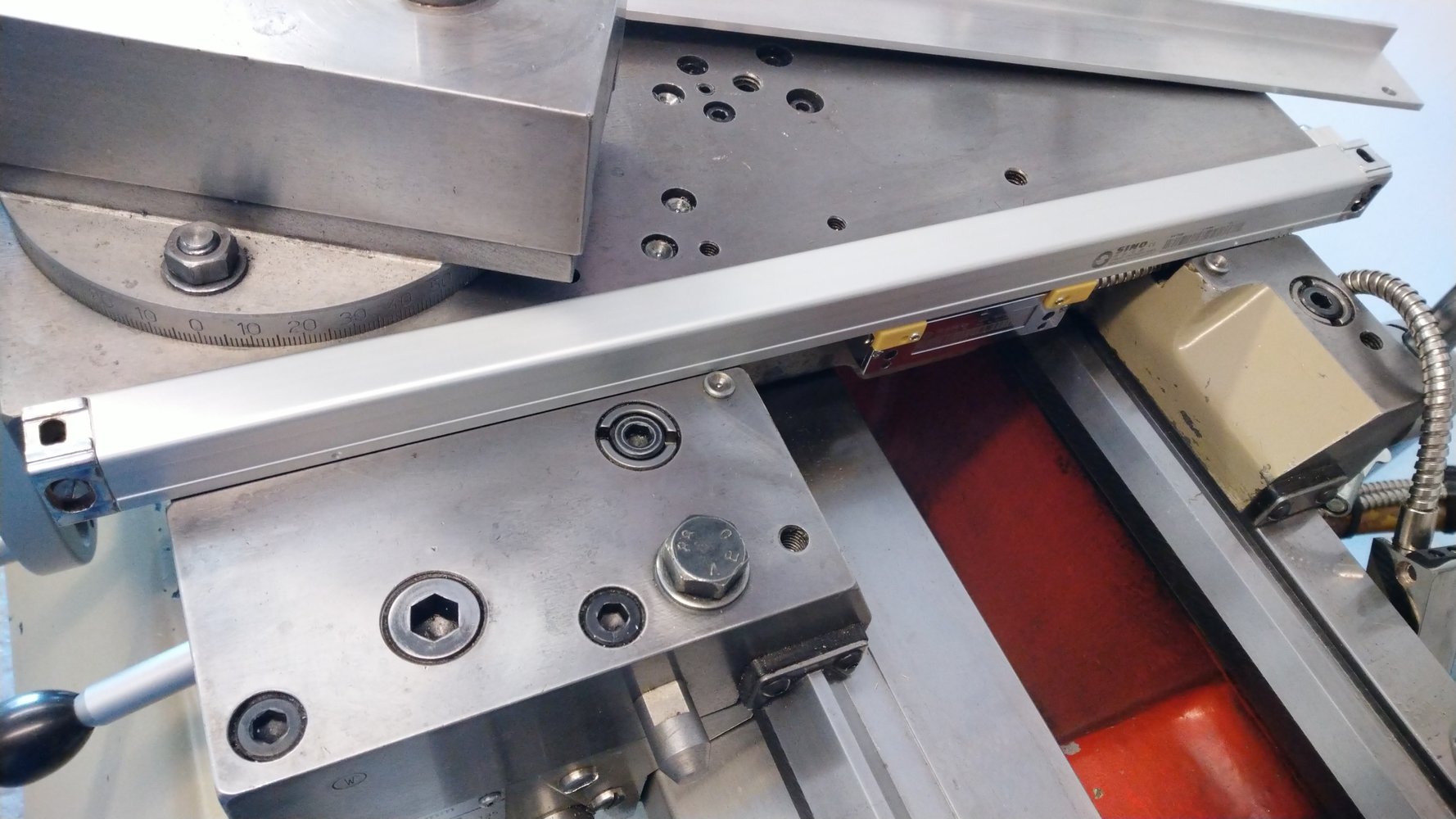

This is how my D type for the mag scales is wired.
1- A BAR
2- 0V
3- B BAR
4- Shield
5- Z BAR
6- A
7- +5V
8- B
9- Z
These pin outs dont seem to correlate with any known standard, certainly not RS422.
