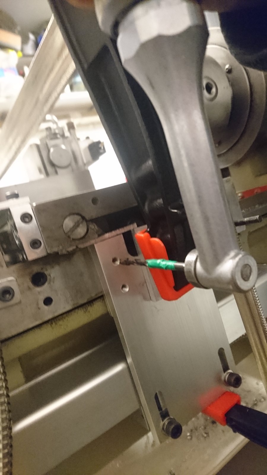

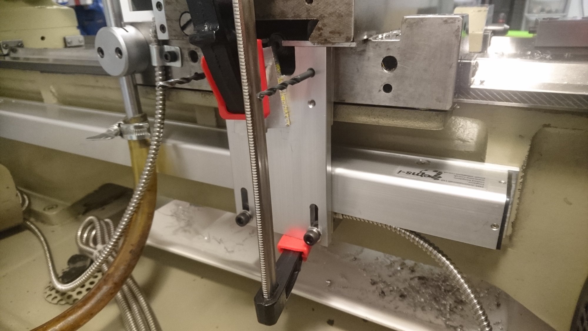

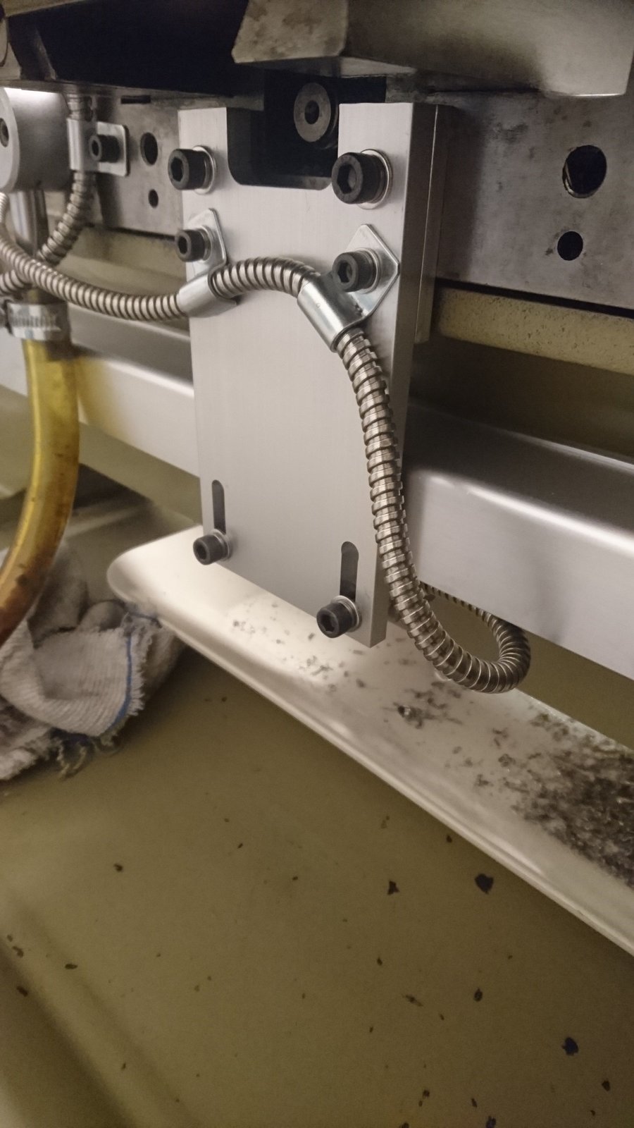

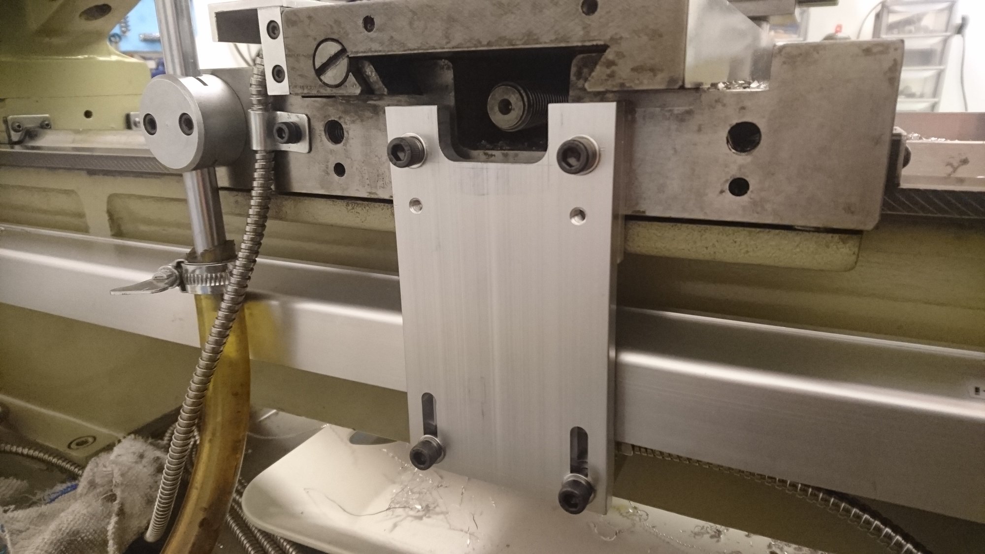

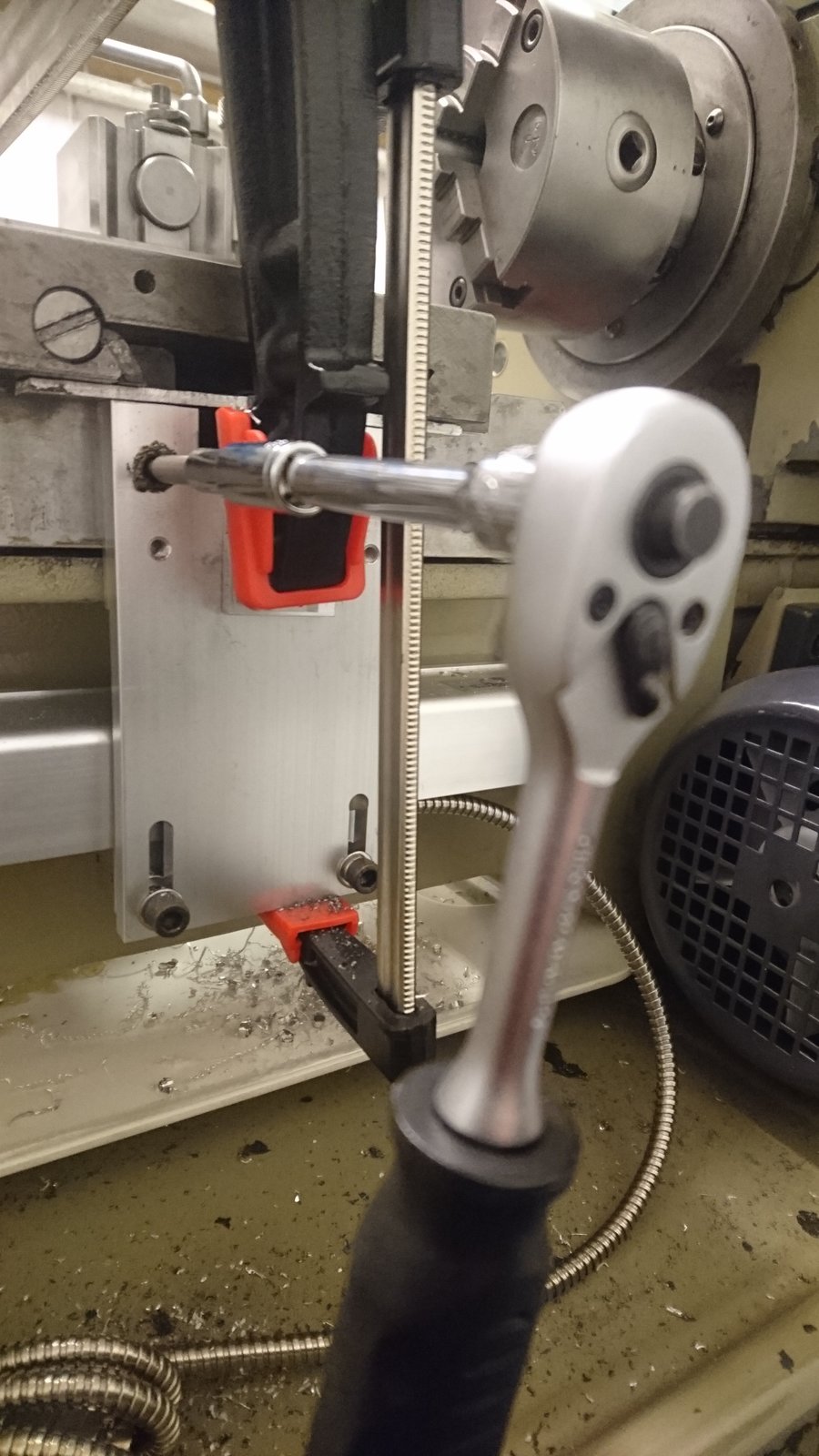

An hour after dinner this evening and I have all the parts of the mounting bracket that I've made so far in position.
The protruding drills are being used to position the spacers. They are 4.2 mm which is the tapping size of M6. Tomorrow I will drill through and tap.

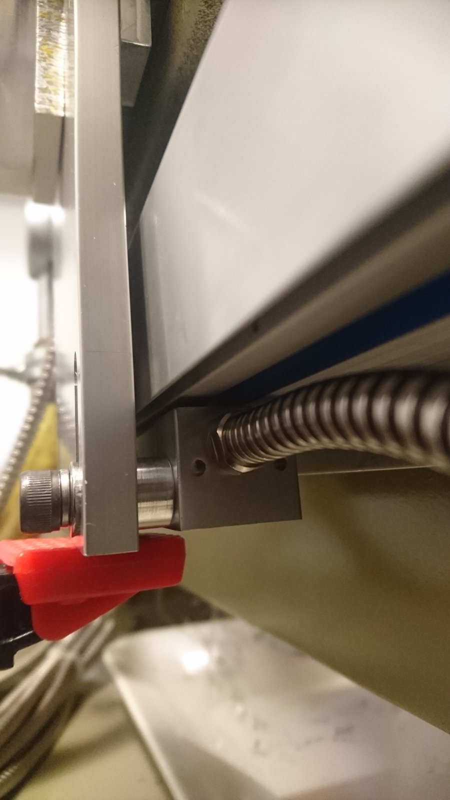

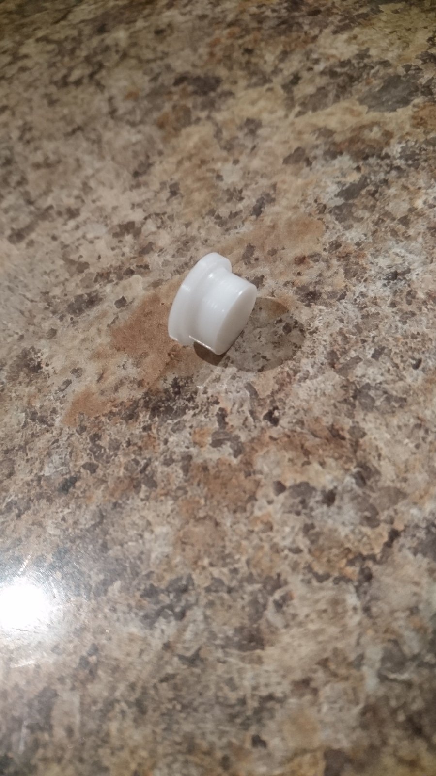

The stepped bushes are a good fit in the counterbored holes of the read head.
