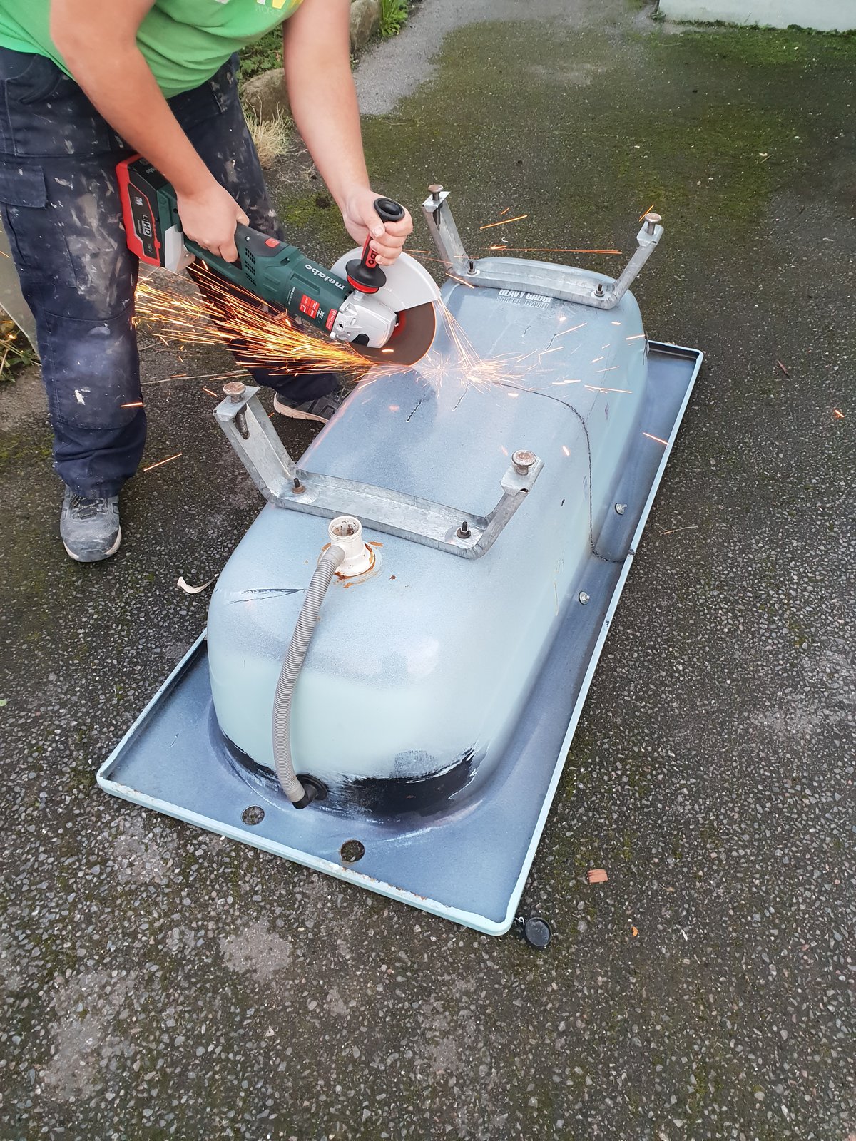

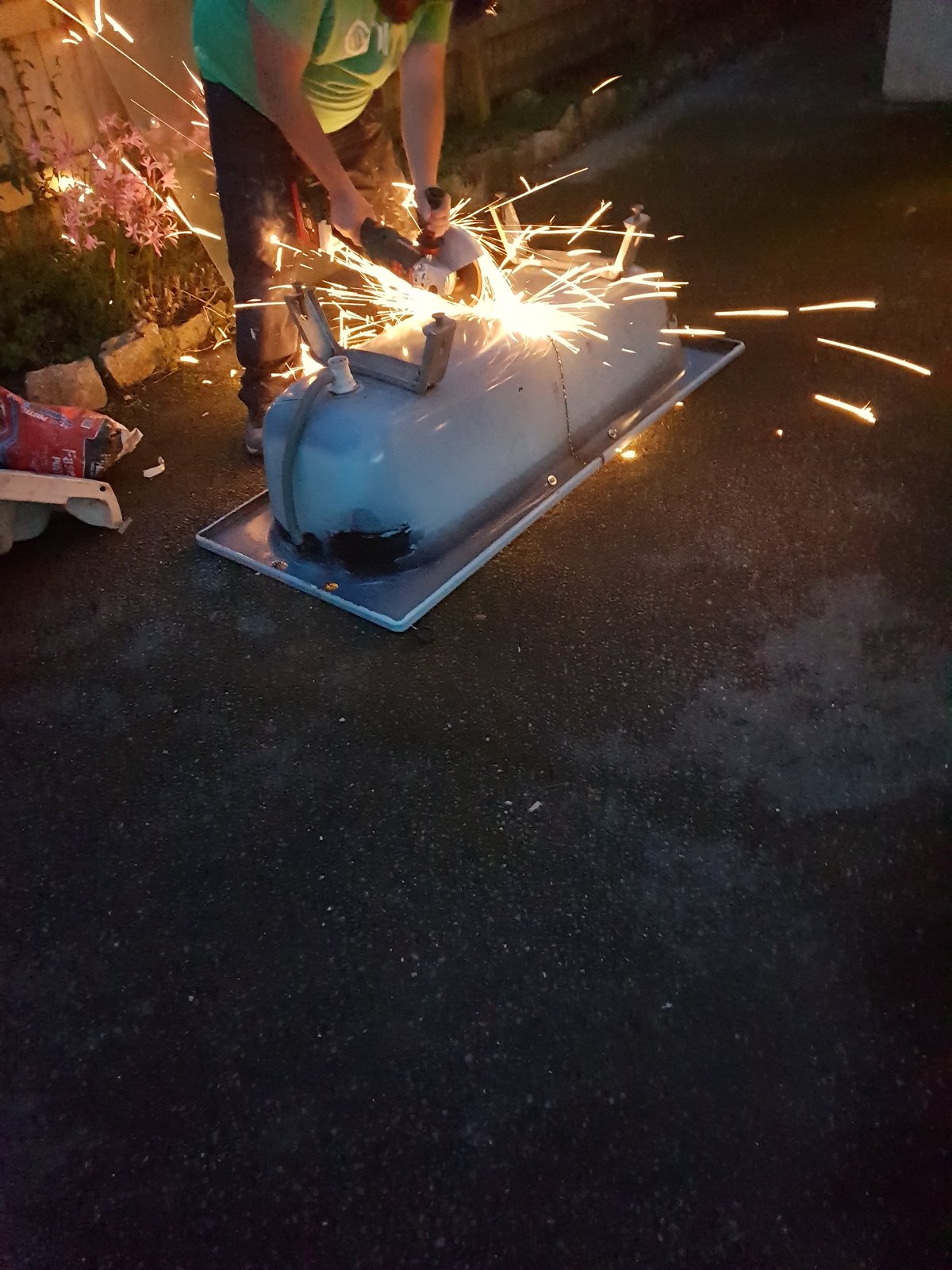

I have the Metabo cordless 9 inch. You can twist the handle so your hand is in the correct position for cutting or grinding. The blade will stop within 3 seconds of lifting off the deadmans trigger too.
Seen here in use cutting up the redundant steel bath to get it in the back of the van.
Not me in the pic, im left handed and use it in this orientation, but with the trigger in my left and handle in right hand with me stood on the "guarded side".
I assume that this is correct as i dont get covered in sparks unlike me mate
