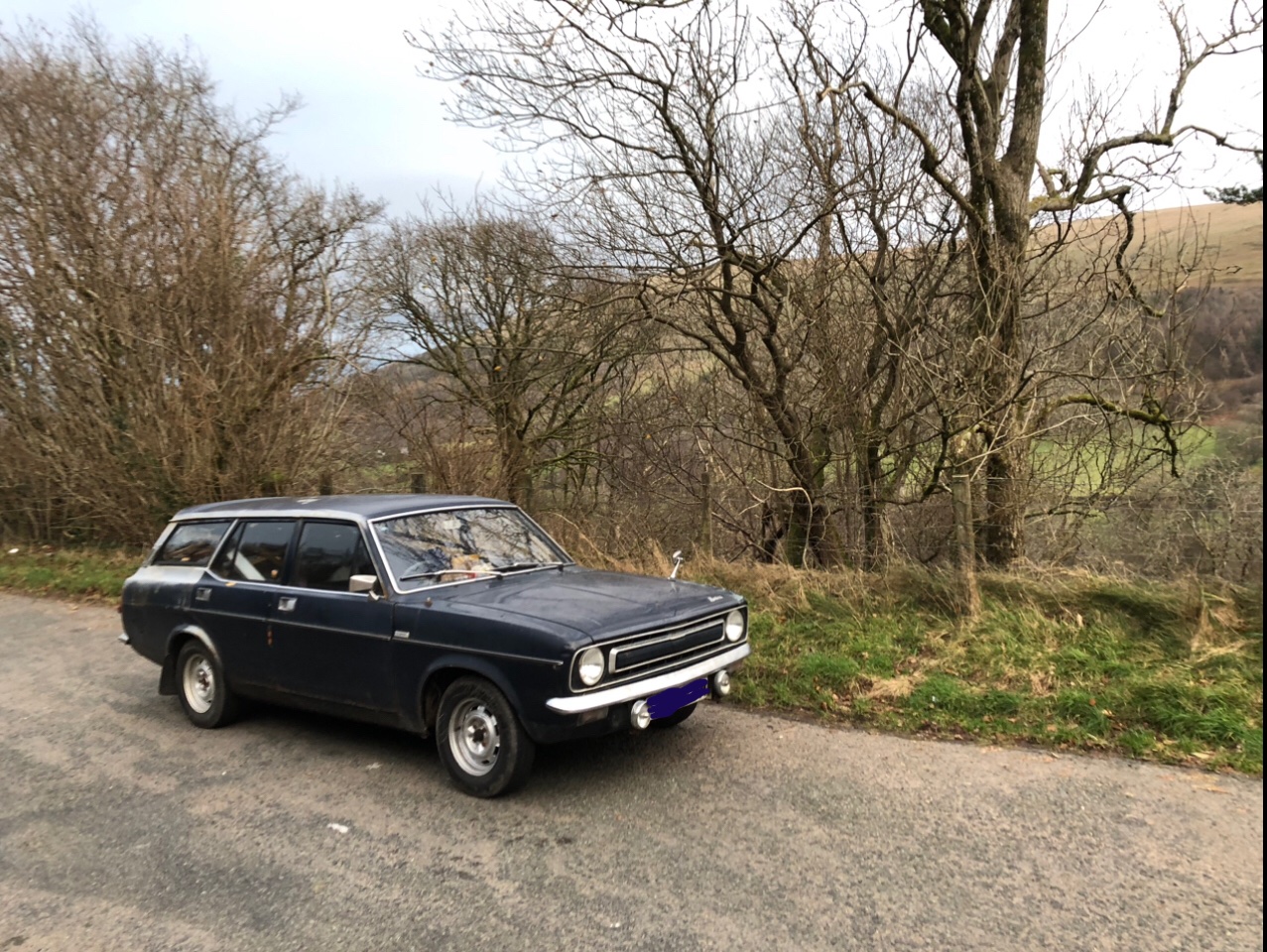

A quick photo in the Welsh valleys just to show it didn’t rain for the whole journey home

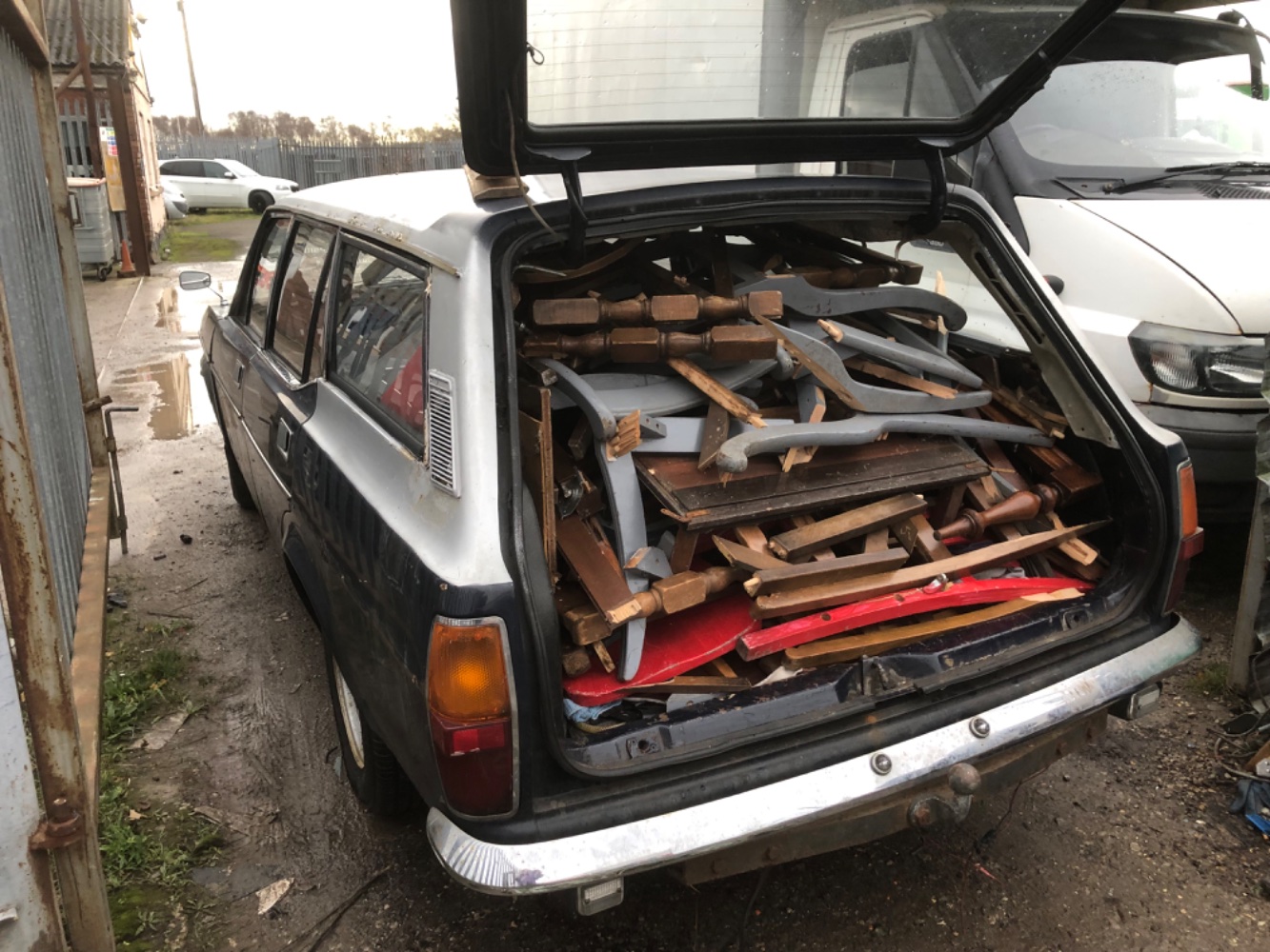

Never a dull day![]()
Fizzy could do with that wood nomad .Already in my van many thanks!Fizzy could do with that wood nomad .
