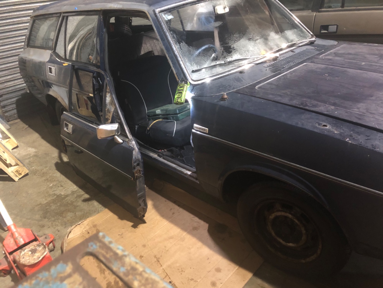

While I was waiting for a delivery of carb parts I swapped the front (worn) and rear (as new) door hinges, then found previous owner has welded a patch onto the A post so there was no adjustment. Fun

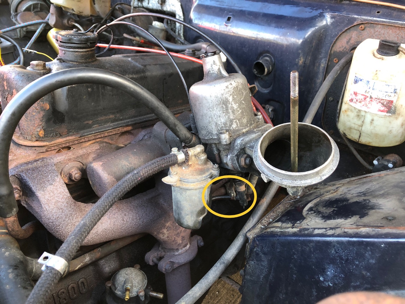

My Marina cut out yesterday, the small bore flexible fuel line from the float chamber to to main jet is kinked and not allowing fuel to flow. This is a bad thing and hopefully the only fault.
The car came from a "make do and mend" chap so the carb may be from something totally different but its been running ok since I got the car (engine never felt crisp but was always smooth and reliable despite low power - it's a B series in an estate car so isn't a surprise)...

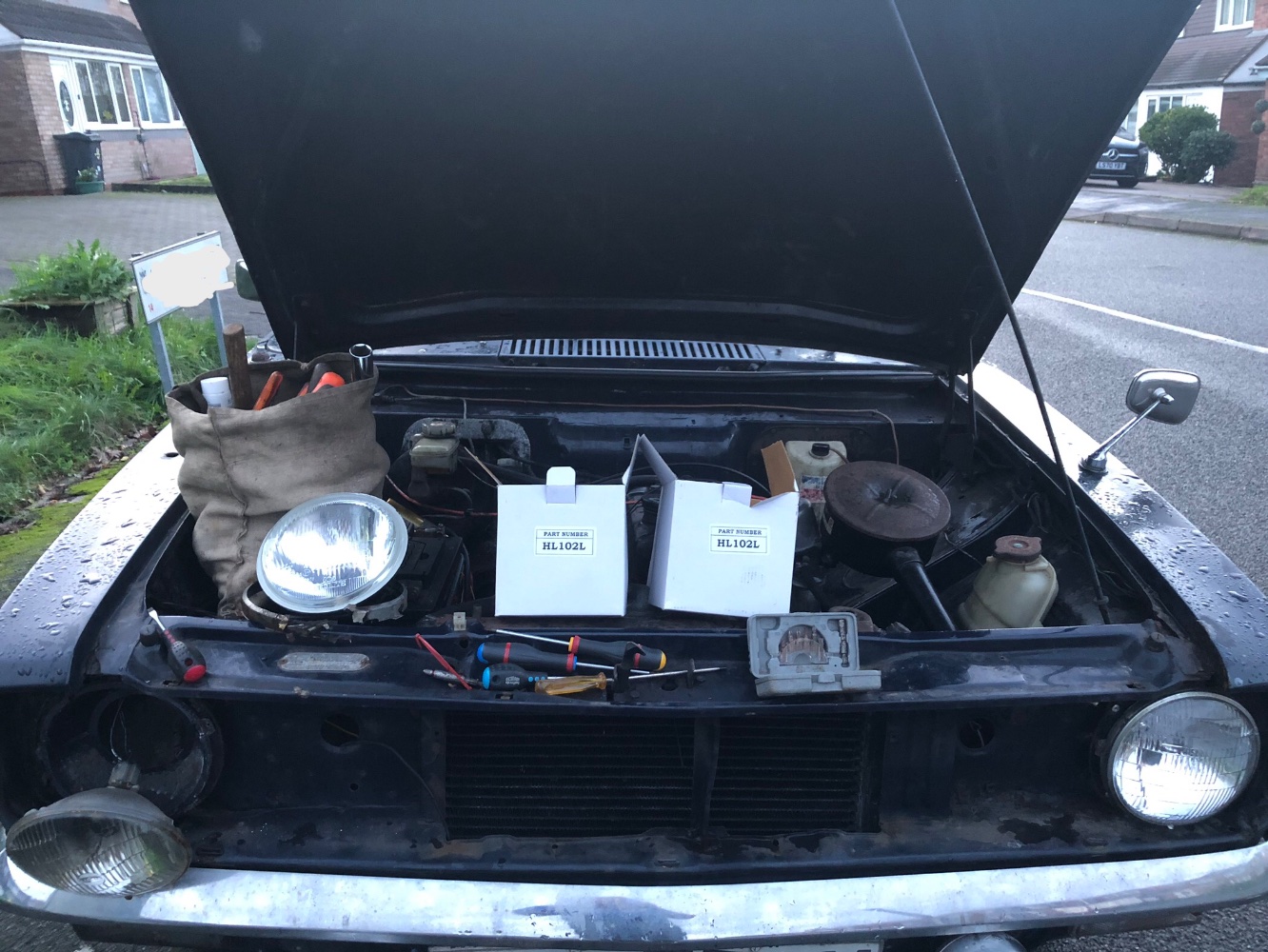

Todays mini project has been to replace the failed sealed beam headlight with a modern H4 light.
One done before daylight went, the other will get done asap.
A bonus is the lights have built in sidelights for extra visibility.
A quick test when it got dark showed how poor the original high beam was - upgrade was well worth doing
The headlights came from Bowers - good kit, great prices.
The Morris Minor has the same or very similar carb to that. Mine isn't very happy either and needs pulling off and messing about with.
Luckily the Land rover is chugging along happily (on its Zenith carb) so there's no panic to sort the MM out

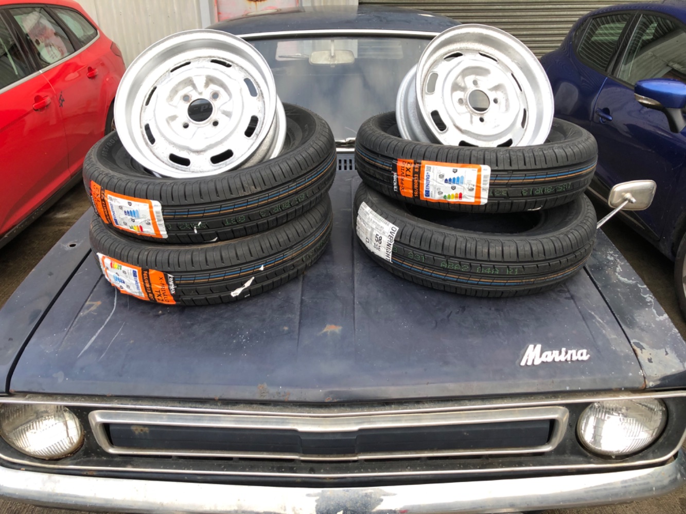

I’m in good terms with my local tyre fitter so he stripped 2 rims. I took them away bare and repainted them, he fitted new tyres and I took away the next pair of rims
The car now has new tyres, repainted rims, and 2 good spares. It’s all good news.
A new battery was fitted last month so it’s now in good shape for winter once I drain the cooling system and add antifreeze ( bought yesterday).
Good upgrade to the H4 units, I do it to my Land Rover Series.
