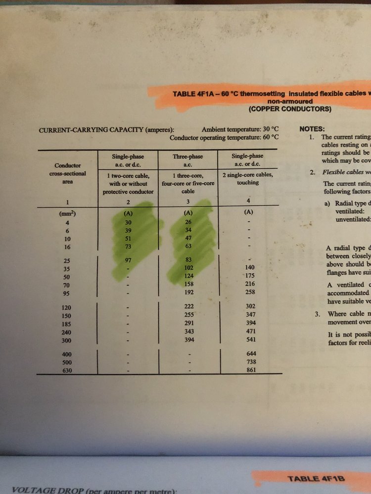

I need to connect to a 63a socket, obviously I need a 63a plug but what cable?
It is feeding a unit with a 40a breaker and I could do with it being flexible ish, but no idea what to even search for
Im not going to be doing the connecting but I have to supply the parts and all ive been told is it must be suitable, I hate sparkies.....
