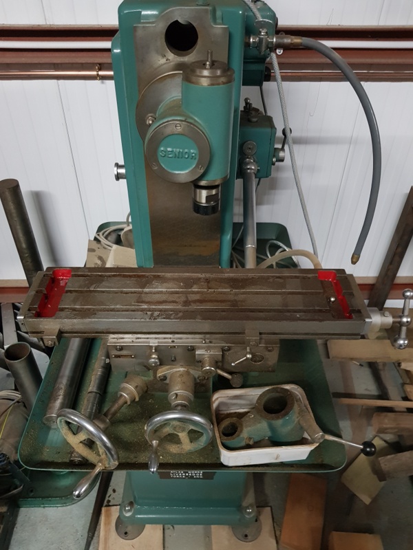

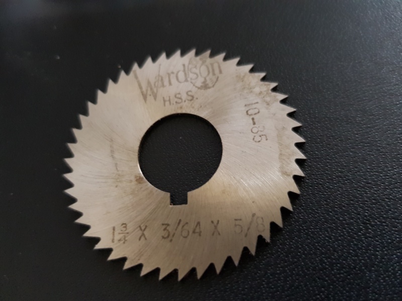

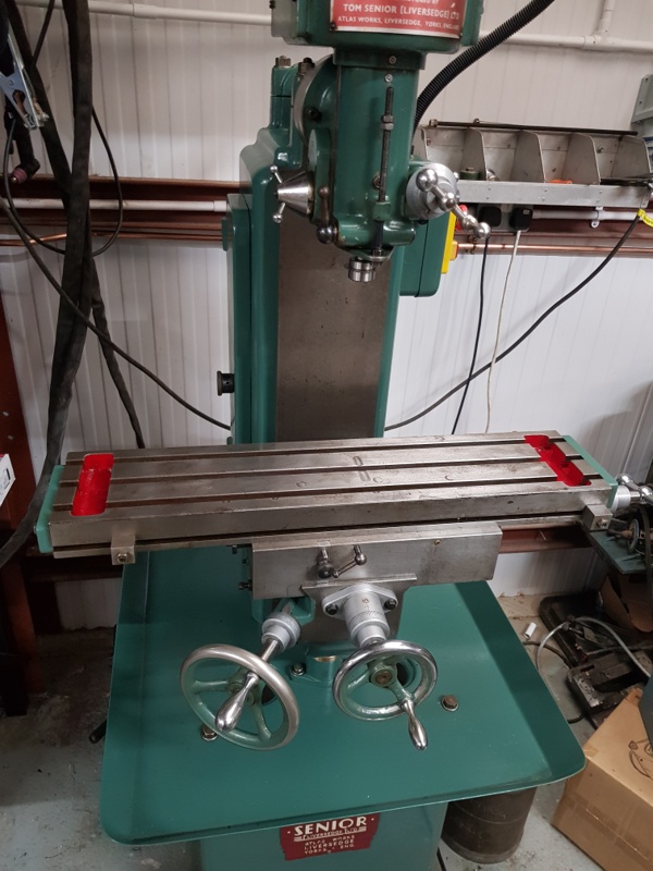

I want to cut slots in some grub screws, yes I could do it by hand but I want a nice repeatable job. Plus I have a dozen or so of these nice slitting saws from my dads stash. It is likely that I will be making slotted machine screws for other machine restorations.

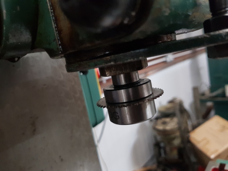

The problem is that the arbour in the Tom Senior M1 is 1" and these are 5/8" or 15.88mm. So a 16mm arbour will be too big. Using a reamer on the saws won't work well with a keyway if I ream it to 16mm, I've been there, it goes off centre. Yes, I could just get a 16mm arbour and 16mm slitting saw, or maybe just slitting saws with a 1" bore for the Tom Senior, this is probably where the smart money is

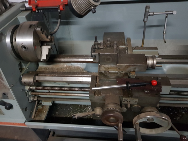

There is a second hand 5/8" to 2MT arbour for sale on ebay by Home and Workshop machines for £43, which is a bit steep for a second hand unit that I will use two or three times a year but would fit directly into my Myford as that has an MT2 headstock, I could then mount the screw in the toolpost of off we go.
However, as I am by no means an expert in the slitting saw arbour world, I thought I would throw it out there and see what comes back, there may be a much easier/cheaper option that people have used for these occasional jobs that may fit the bill that utilises what I already have.
Any simple but safe ideas?
