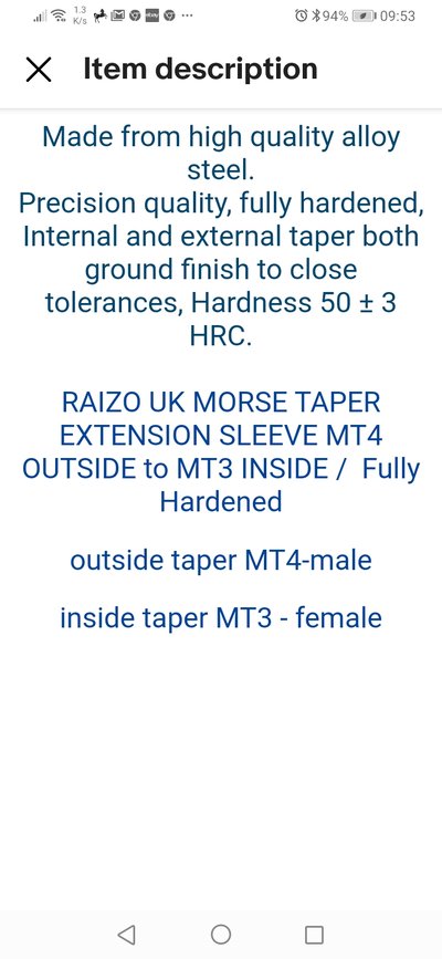

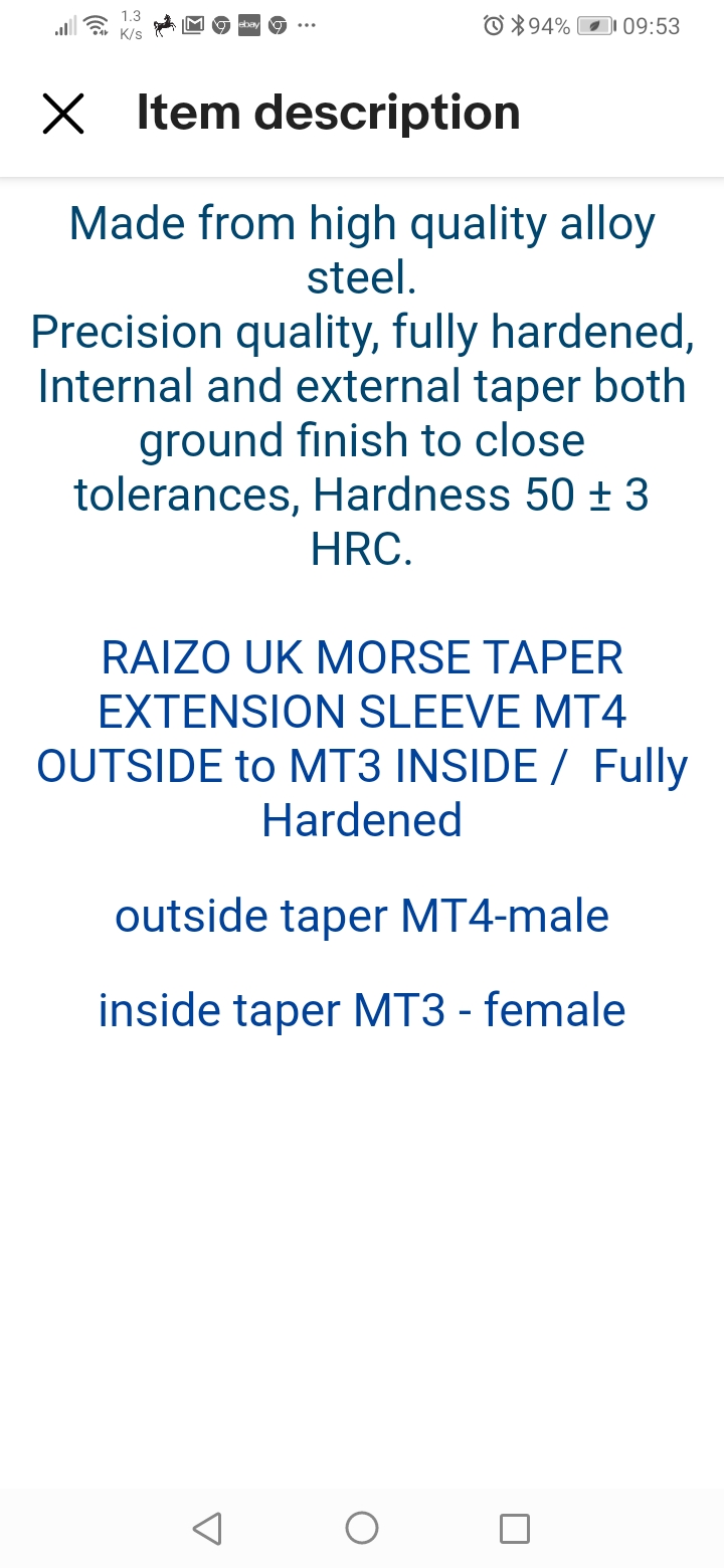

Not to me as a don't want one of those.Reads perfectly correctly to me.
Not to me as a don't want one of those.![]()
I have a 3 Morse tailstock and a want to use a 4 Morse shamphering tool.Whether you want one or not doesn't affect whether it's correctly described though does it?

I knew it was rong but my spell chucker would not play ball.https://www.ebay.co.uk/itm/MORSE-TA...876043?hash=item41e251a64b:g:PB8AAOSwlkFdXUhi
Granted MT3 external to MT4 internal are out of stock but they might be getting more in. And it's chamfer BTW.

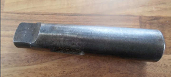

I am going round in circles trying to find what I believe is termed a 4 to 3 Morse adapter.
I see many listed as 4 to 3 but stamped 3 to 4.
Now the one I have in the photo is stamped 4 to 3 but I am doubting myself now as I can't see how it can be without a step in it.View attachment 249548

That leaves a long reducer - why would you want one of them?
Because my 4 Morse taper tool does not fit my 3 Morse taper tailstock.See the pic (from your original post)?
This can only beva reducer, so that's easy.
An increaser will allways be long, with a bigger big end than the small end, by quite a bit.

My mind is boggling a bit concerning how you might hold a chamfering tool to turn down its shank. In every aspect, it lacks the parallelism that is necessary for easy workholding.
