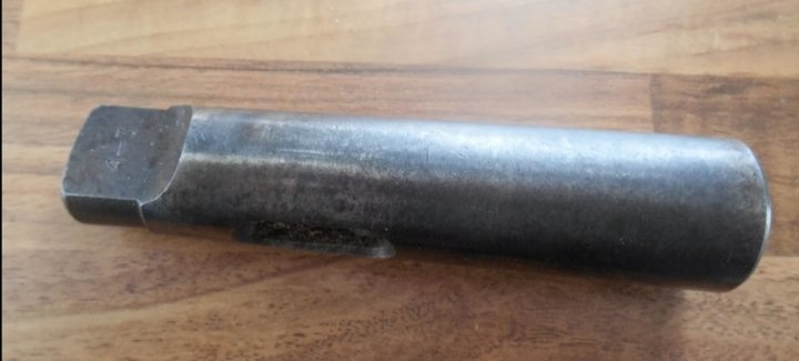

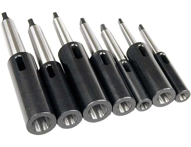

Cutwel, get the bison ones. High quality and logical terminologyI am going round in circles trying to find what I believe is termed a 4 to 3 Morse adapter.

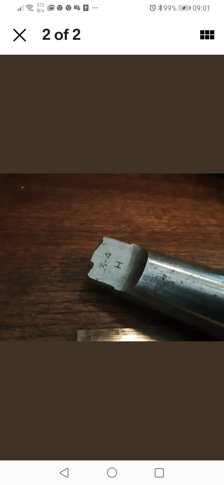

I see many listed as 4 to 3 but stamped 3 to 4.
Now the one I have in the photo is stamped 4 to 3 but I am doubting myself now as I can't see how it can be without a step in it.View attachment 249548

Yes but the photo is the same. Just stamped both ways.All hinges on whether its a reducer or increaser?
You would think so.It should be completely obvious, just look at the shape. Which way round it's stamped is not relevant if there's a picture of the actual item.

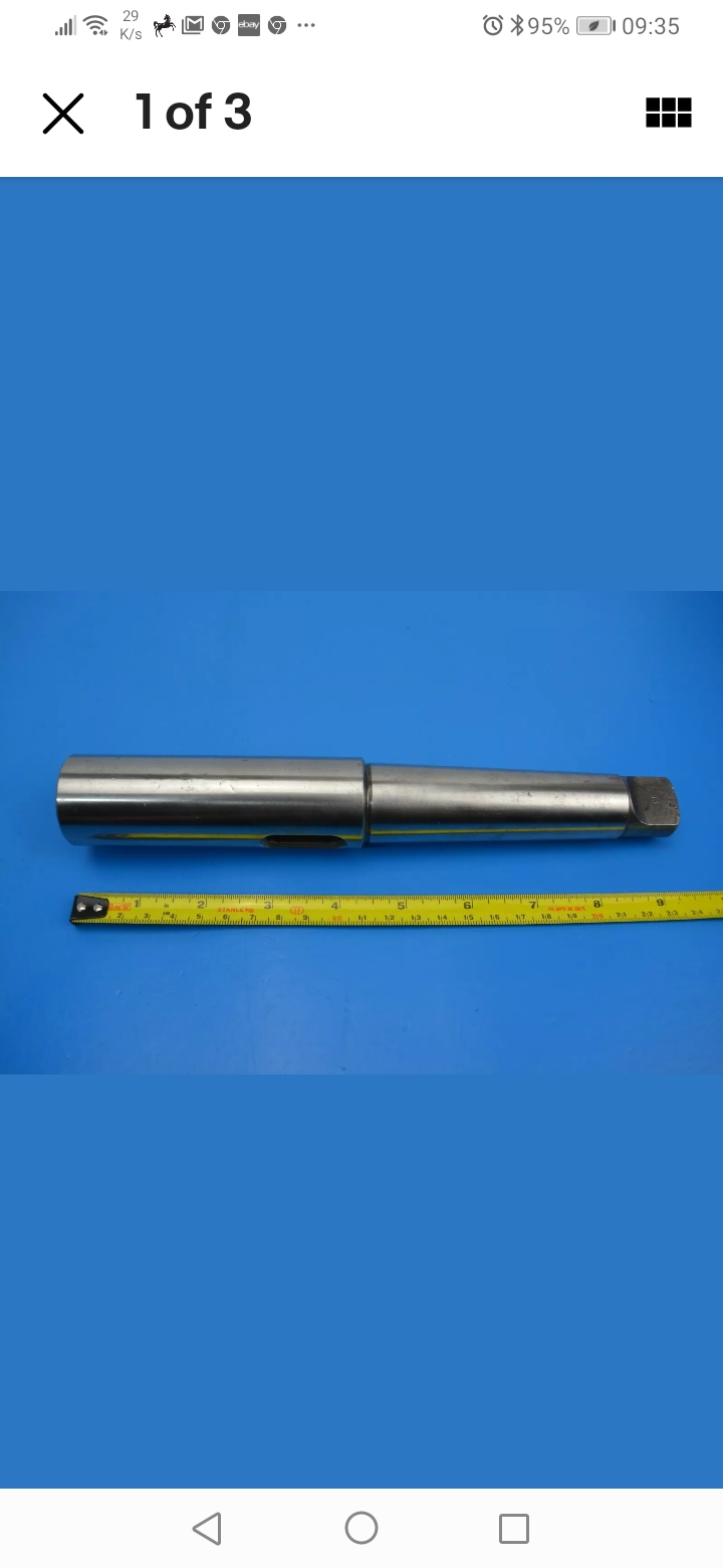

I just have a 4 Morse large diameter shamphering tool that would be useful occasionally. But thankfully cutwell don't have them listed as the prices of their extension type start at around 60 quid (too rich for me)
You would think so.
But the problem is the extension type can be both ways.

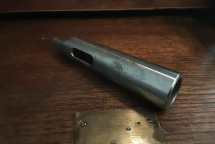

What's this one?View attachment 249562 View attachment 249563
@Brad93 I appreciate that mate. But it's probably cheaper to buy a 3 Morse shamphering tool.European made, hardened and ground.
You can get extensions from China but they’re not as nicely made.
That's what I thought.Not big enough to be an increaser so it's either a same-size extension or a reducing extension. What does it say?
