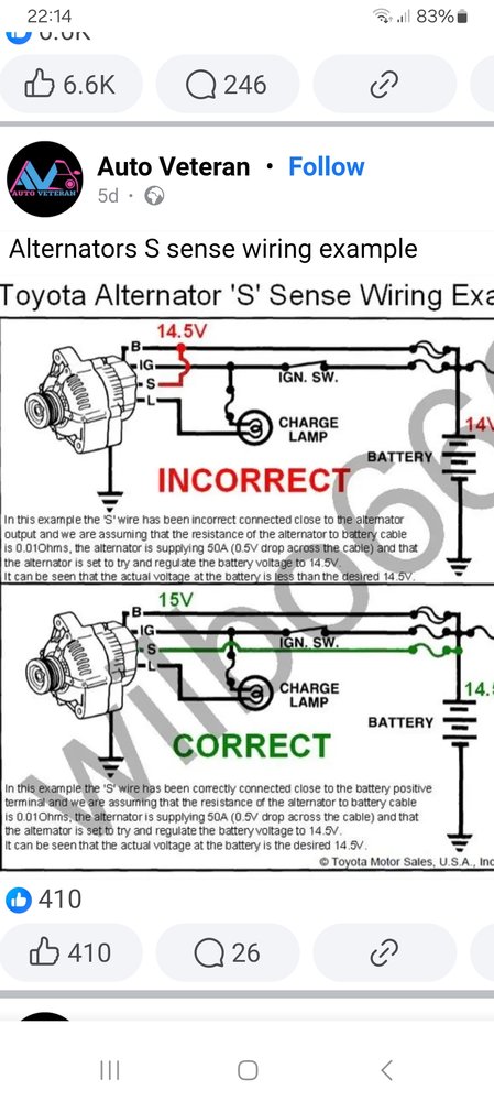

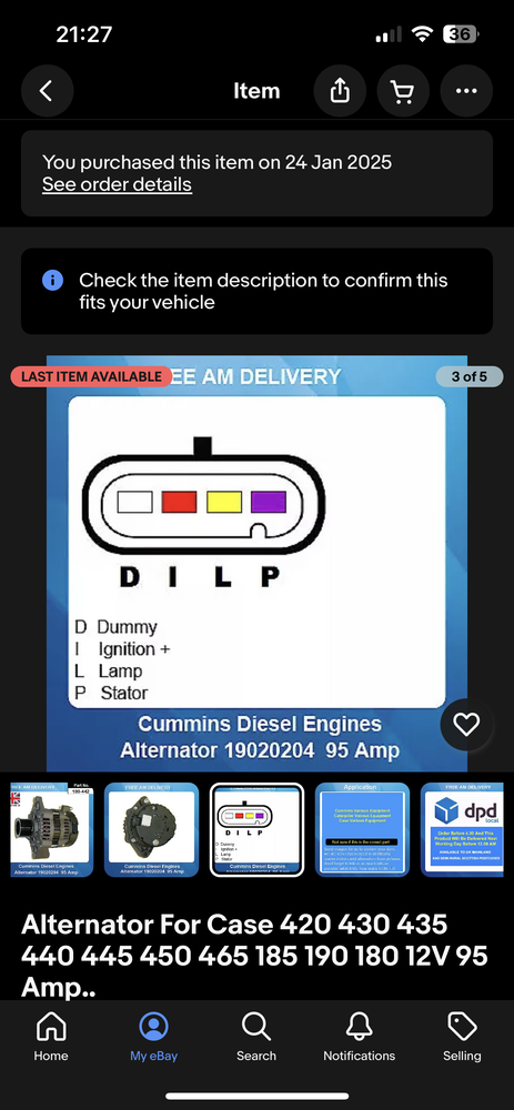

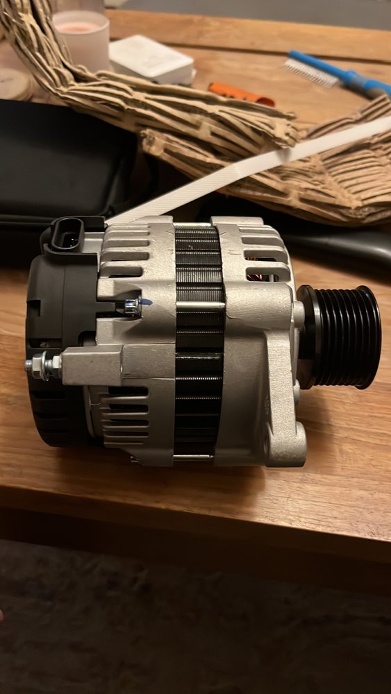

Just trying to confirm my thoughts on wiring this alternator:
It has a 4 pin plug with terminals labelled PLI and S
My understanding is P is tacho (don’t have one)
L is charge light/exciter
I is ign pos to act as exciter if you don’t have a charge lamp circuit
S is voltage sensing. To my understanding this MUST be jumped to batt pos?
Cheers
