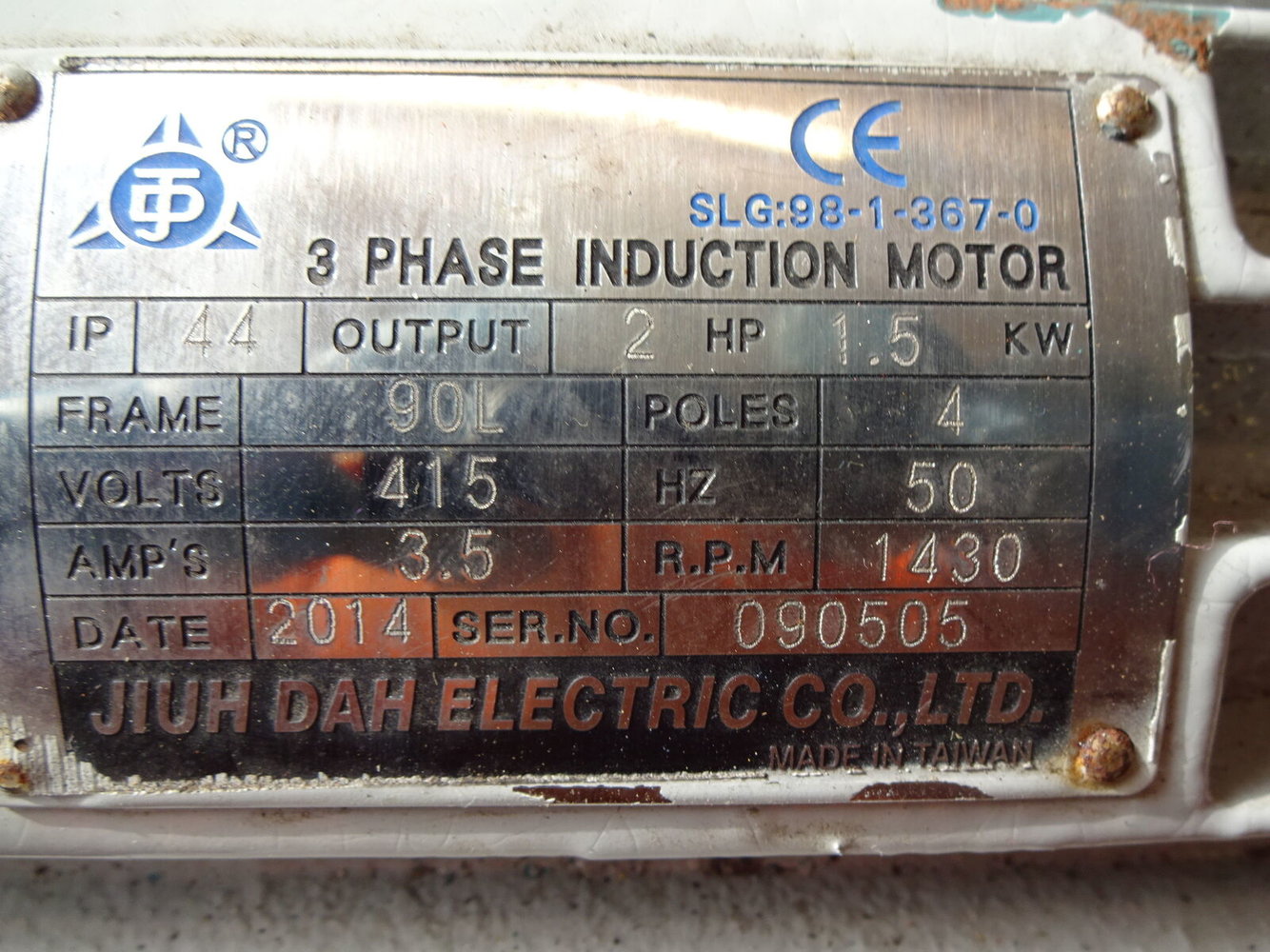

Not without pulling the windings to make it run on 220v
Well no, no yes. You can run it on 240vsd, as @not done it yet says it will be on reduced torque, or reduced speed. I run a 4.5 kW mill on 240v, just haven't got around to pulling the windings yet.Well, yes and no. It can be ran with a 415volt VFD but I suspect what you are asking is "Can this motor run off a 240volt VFD"? and the answer is no.
However if you get someione to pull the points outof the wiring then you could run it 220 volts*
*someone far better able than I will be along shortly to explain.
Do you have a link to the vfd you were thinking of?

In essence yes. Choose a motor with the mounting option to suit your application. If using a cheaper vfd rate it slightly higher than required. I have two lathes and a mill all running off vfd's (there are posts on the forum showing mine and a few vids on my YouTube channel).So, to do what I would like I would need a 2hp, 220v 3phase motor and a vfd? Would I be ok with them?
Ahh ok thanks fellas. My boxford lathe has a 1+1/2 hp single phase motor, it struggles a bit when turning bigger dia stuff. Thought if I got a 2hp, 3 phase motor and a vfd it would be powerful enough for all. I also believe 3 phase is smoother running and I like the speed control on vfd.

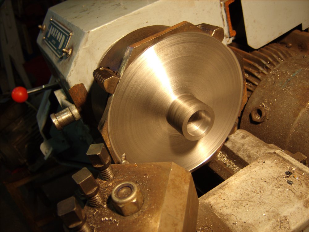

6 - 8" dia I also find the lathe heavy to start in cold weather especially when using the gear train. Maybe the motor does not provide the power it is plated to do. It was one of the cheaper £Bay motors. If I remember right I think the original motor was 1hp 415v.1.5hp is a good match for a Boxford. Are you sure that it's not belt slip? What do you call 'bigger stuff' ?
Changed motors once or twice before so have 2 pulleys.The challenge is if the motor shaft diameter is different to the existing one. The drive pulley will not then fit the new motor and you cannot put it in the lathe to alter its bore as it is coming off the old motor that is driving the lathe. The solution is obvious: never own only one lathe.
