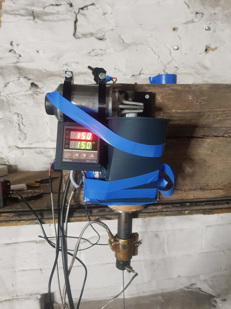

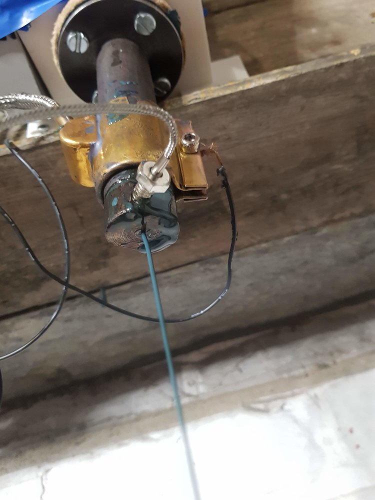

Crushed PLA can be squeezed through a hot nozzle using a drill bit too, never thought to use it for injection moulding though, I might try that.For stuff that's not going to see over 40c then polymorph type granules can be extruded easily through a nozzle made from a soldering iron and driven through by a screw powered off a cordless drill.
Once set that stuff is about the same as nylon in stiffness and toughness.
