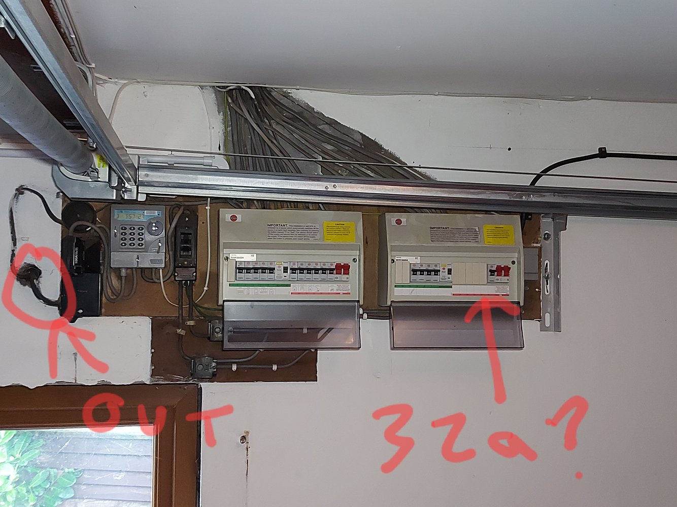

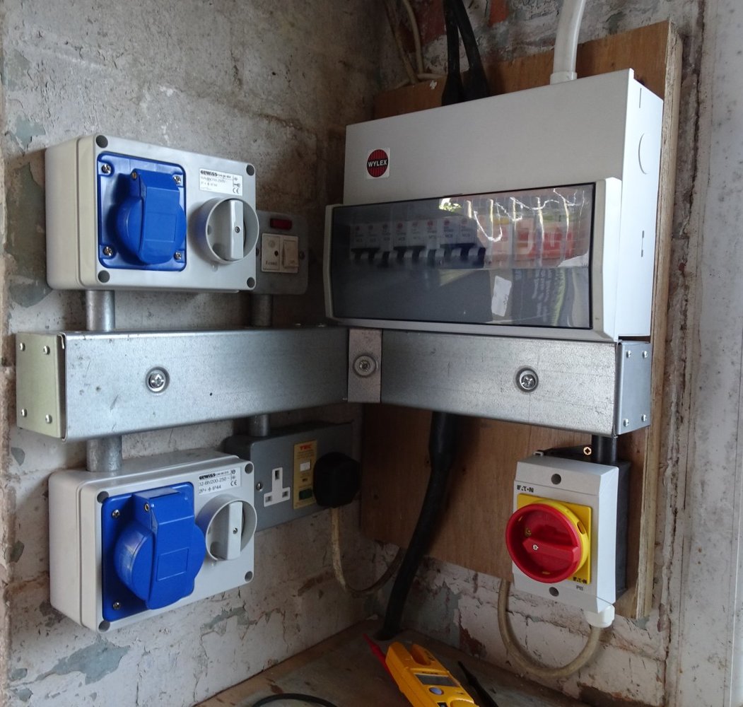

Thanks for that it sort of validates my suggestion above- aka I could create this same scenario but hard wired into my garage. 32amp breaker and 6mm supply from main garage to back garage. Where that cable comes in at ceiling level fit a small dual MCB wall breaker. And 16 + 32amp cables / supplies off that.
Best of both worlds(?)

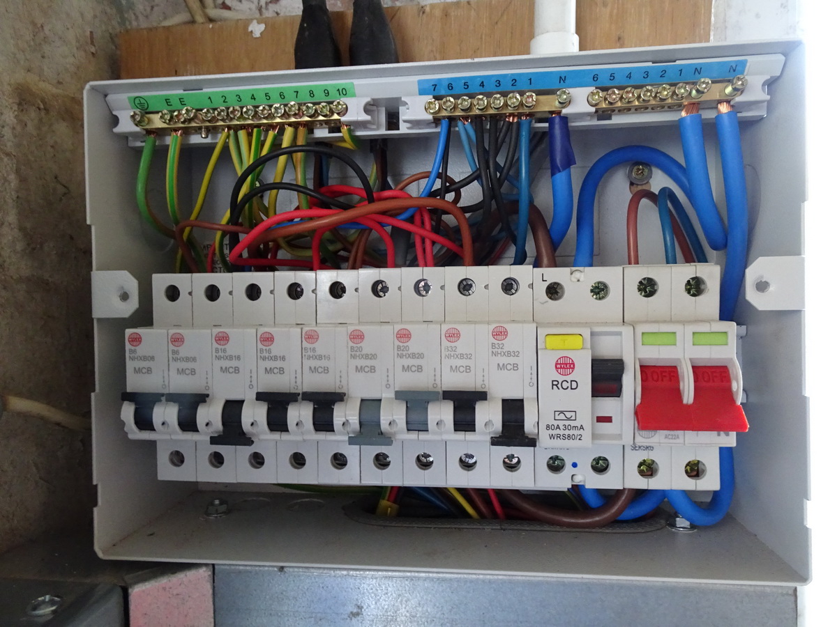

If you use the unit you've shown the house RCD may still trip under fault conditions due to both RCD's rated at 30mA (discrimination)
scored a 25 meter length free so that was the governing factor
