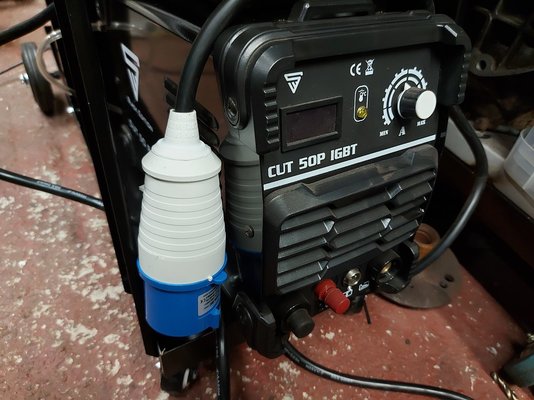

I have a Stahlwerks plasma I bought a couple years back. I ran it temporarily on 13 amp supply and it worked but would trip the garage as too high obviously.
With my TIG purchase I'm finally putting in a new dedicated 32amp supply to my back garage.
I am putting 32 amp plugs on the TIG and this plasma as I would run them from this new 32 amp supply. But the Plasma original euro plug is stamped 16amp.
Doesn't make a difference stepping up? Prob no good the other way around but just making sure!
