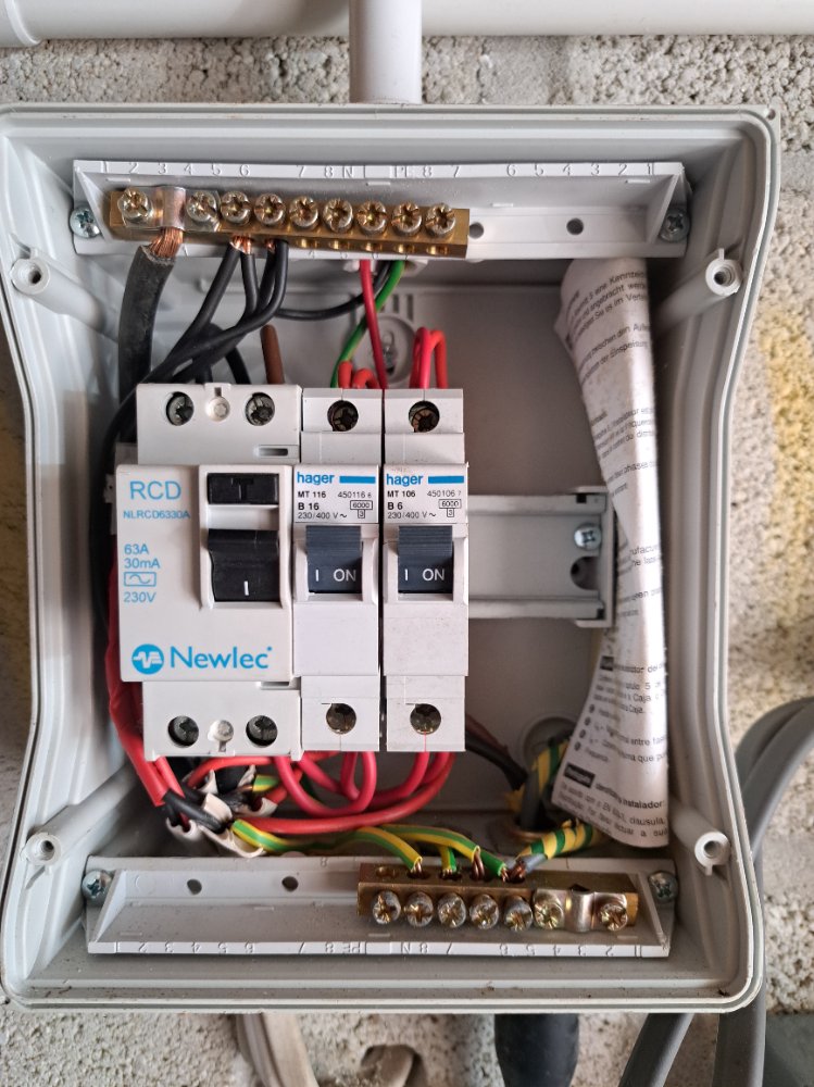

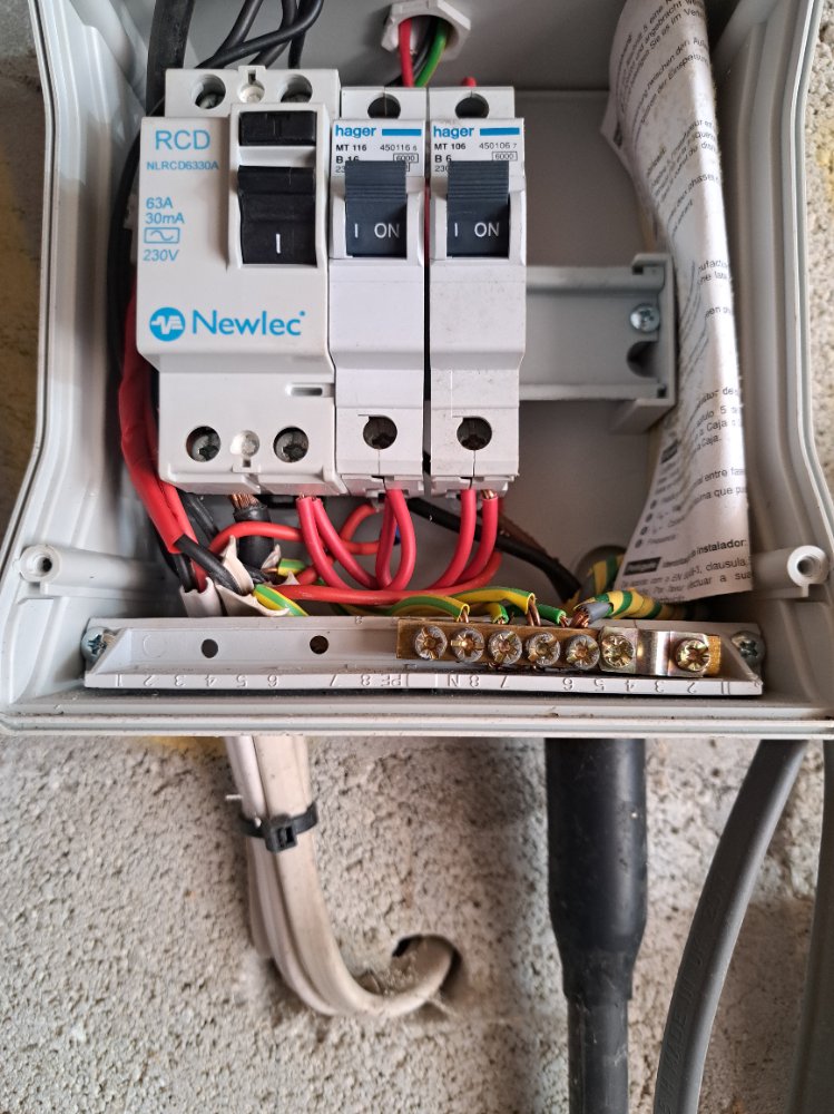

its catch 22 nothing in the regs saying you cant fit another manufactures mcb if they fit bad . news is you then become responsible for the design and manafacturer of the said product and have to have the relevant paperwork to prove item so in other words no you cant . both companys are now not responsible for the product![]()
the wiring regulations require all protective devices to meet the requirements of the relevant product standards and type approvals.
Manufacturers only type approve their products for use in their equipment.
If you mix and match manufacturers then you assume the role of manufacturer of the finished assembly and become responsible for the compliance of it.
If you are installing a standard DB then it's more cost effective to go down the type-approved route but if you're making anything custom, like a control panel, then you're already taking on the responsibility for manufacturing it and can mix and match whatever brands you like.

who knows could have been loose wires both manafacturers denied responsibility as they didnt design it
done it myself in the past and a few in the present
