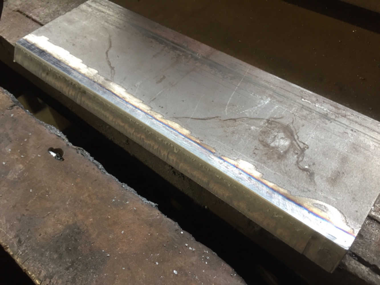

This one looks so much cleaner.But thinner 12-15mm
Brad, how do you cut that with propane? Is that propane with compressed air or something? I'd like to cut a thick plate myself, maybe 25mm IIRC.That's 40mm thick cut with propane if I remember correctly
Propane & Oxygen.Brad, how do you cut that with propane? Is that propane with compressed air or something? I'd like to cut a thick plate myself, maybe 25mm IIRC.

That won't be acetylene. Acetylene, realistically, is limited to about 8" thick.oxy acet will cut four feet thick steel ,,, theres some video on you tube of some guys cutting 2ft steel I think ,,,,
last guys good , he does some interesting stuff , hes a daemon with a gas axe though , he cuts pipe joints nicer than I can plasma cut them , but be warned , you will watch all the video if you watch the first fifteen seconds.
Still using oxygenBrad, how do you cut that with propane? Is that propane with compressed air or something? I'd like to cut a thick plate myself, maybe 25mm IIRC.
It will be, it's with acetylene rather than propane, narrower kerf, cooler part, less heat input.This one looks so much cleaner.
15 psiThat won't be acetylene. Acetylene, realistically, is limited to about 8" thick.
Anything over that, will be propane. 1.) Cost 2.) Acetylene can only be drawn off at a certain rate, and above a certain pressure (it escapes me now) it becomes unstable.
