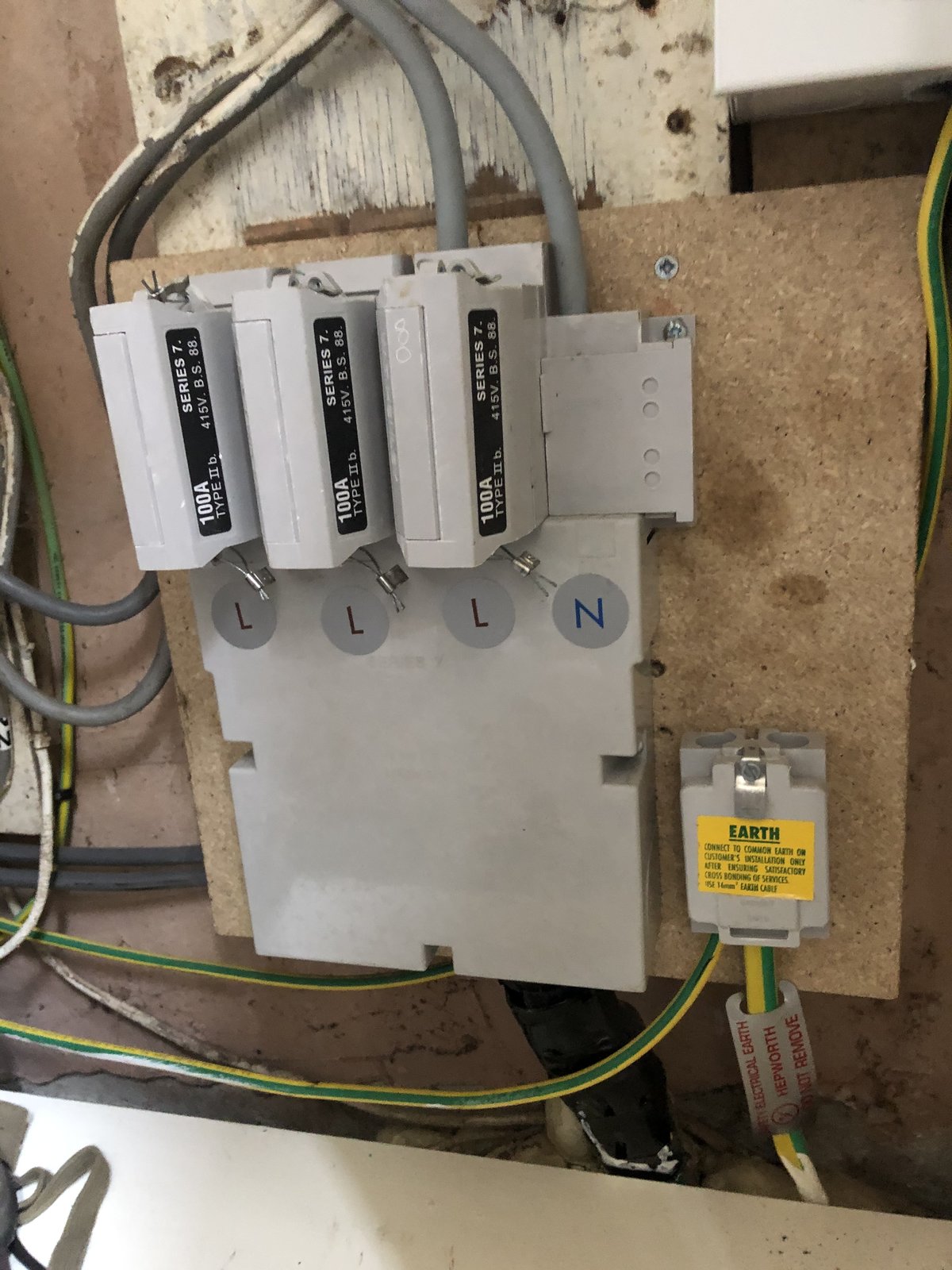

I reckon if you got on to your supplier they would install a 3 phase meter foc as you already have the service cutouts.
