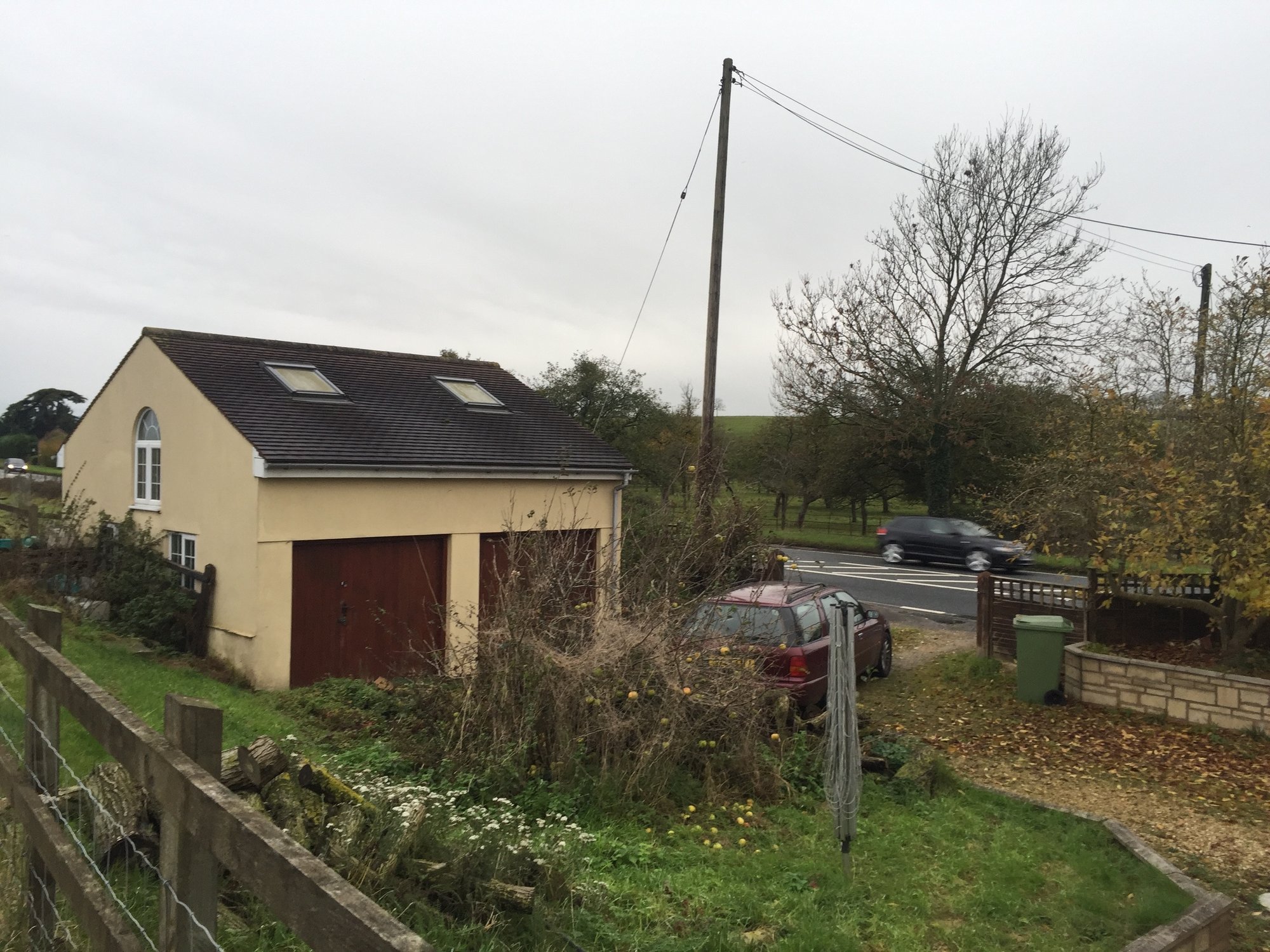

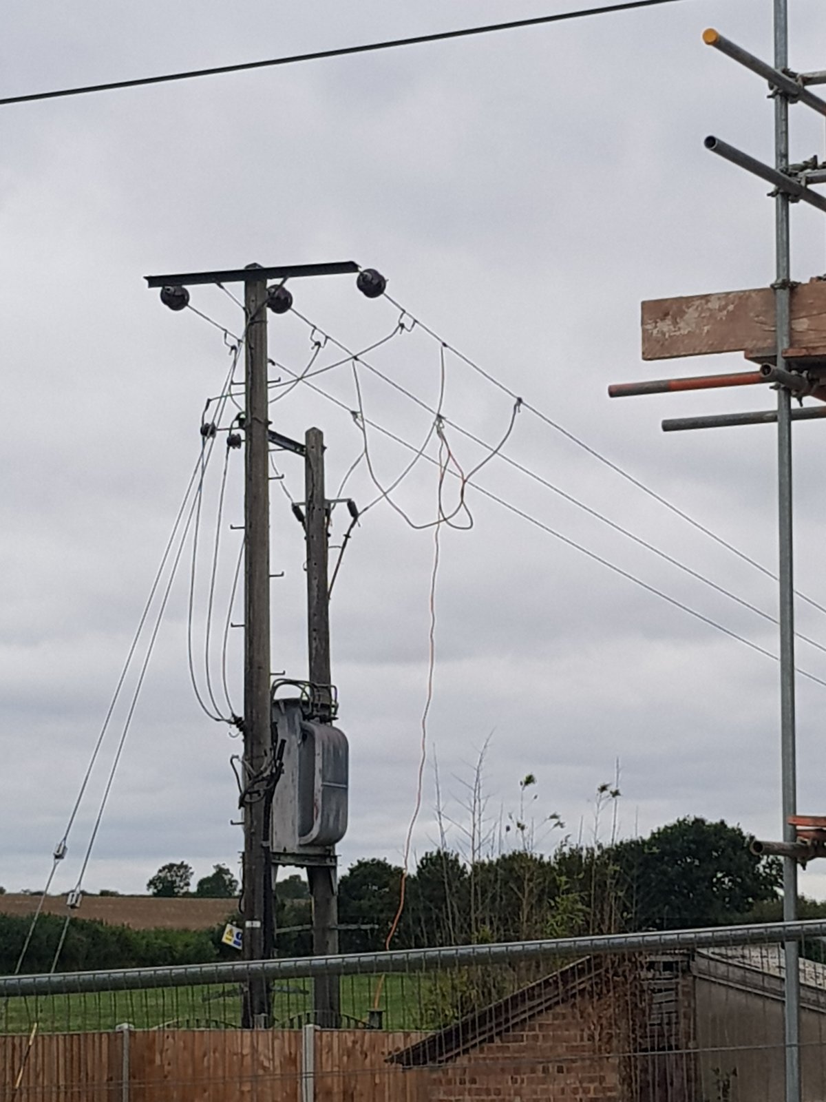

Just climb the pole with a handful of crocodile clips.
R.I.P. Jack
That would explain the ground spikes in the field.Grounding on the 11kv lines to allow safe working just in case it becomes reenergized.
and across the phases as wellThat would explain the ground spikes in the field.
Suggest to them you require the cable over your property to be laid underground this is something they have to do, (they have 12 months to do it) you can then make a another suggestion
even though the pole is on my land.
but it just feeds his property
