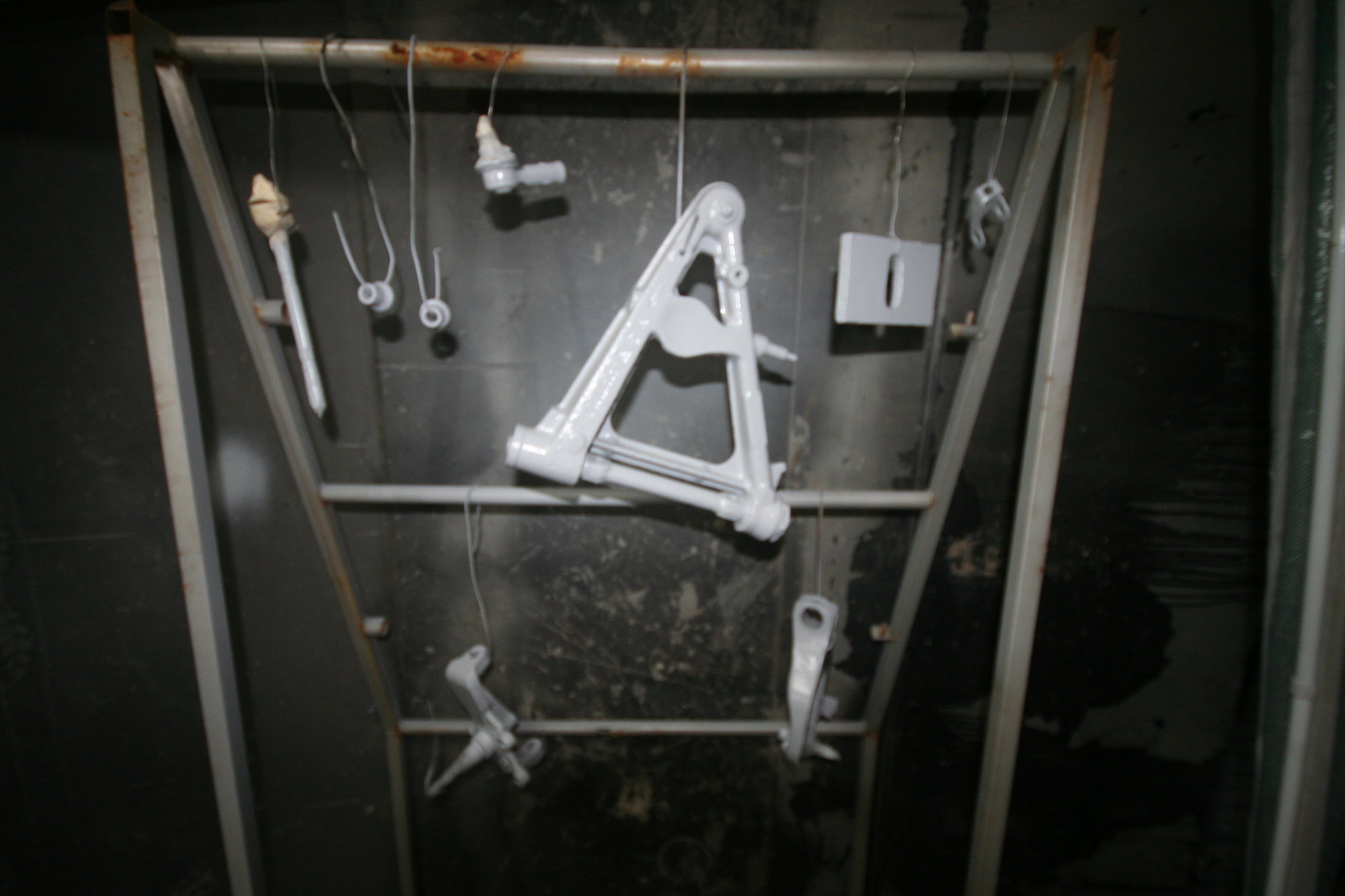

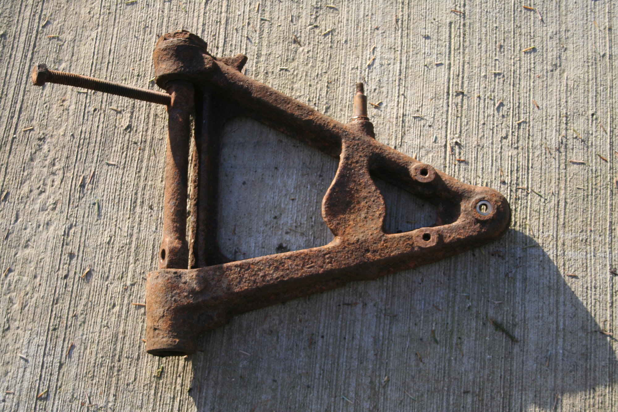

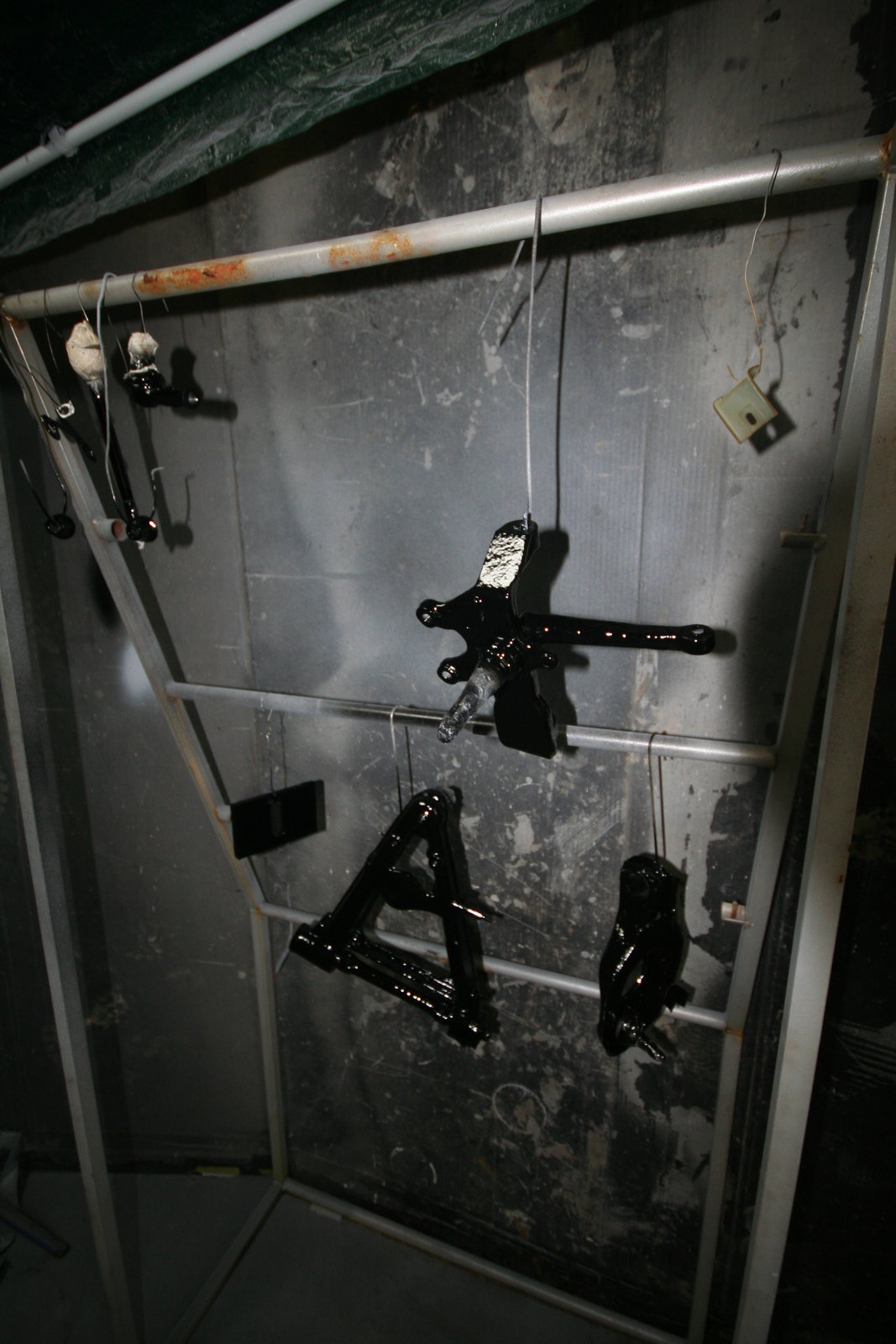

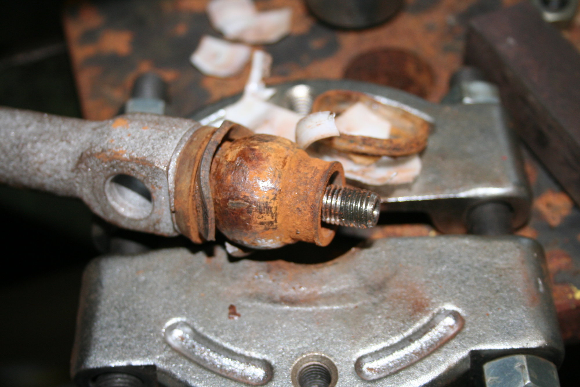

Bit of a diversion, no welding but a bit of heat required.

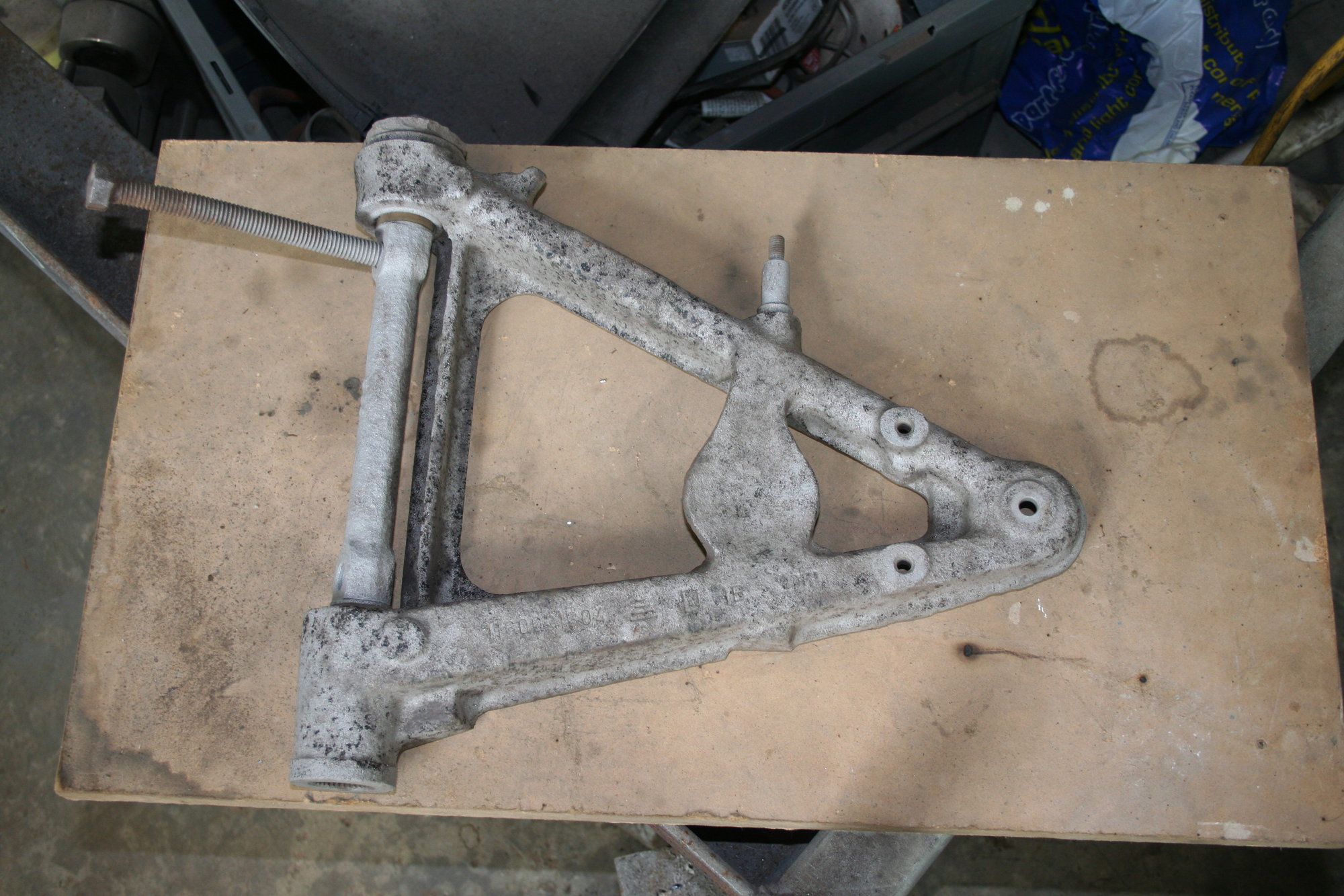

Started on the upper wishbone
As removed from the car with the ball joint removed
After blasting but siting about for a while

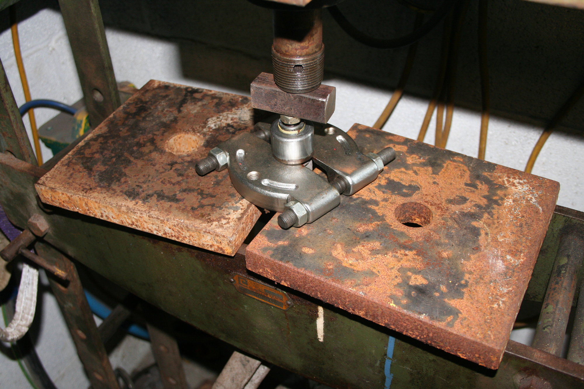

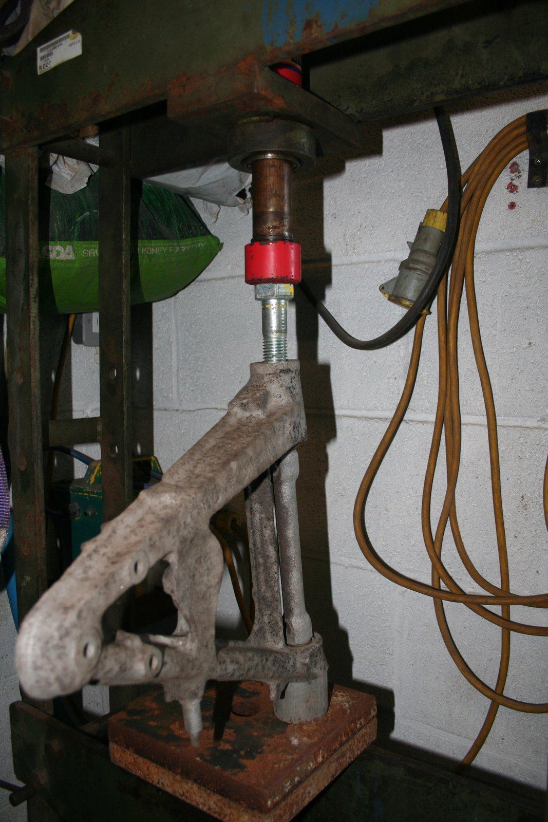

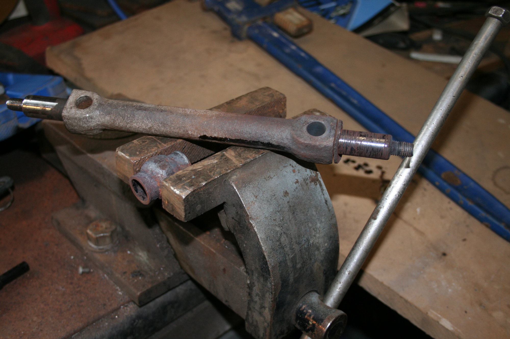

Removing swivel arm and bush
And then trying to remove bearing
Not playing ball
So a bit of heat and persuasion required
And finality got it off
Assembly was a lot easier, then another blast and a few coats of epoxy primer
And two pack top coat
