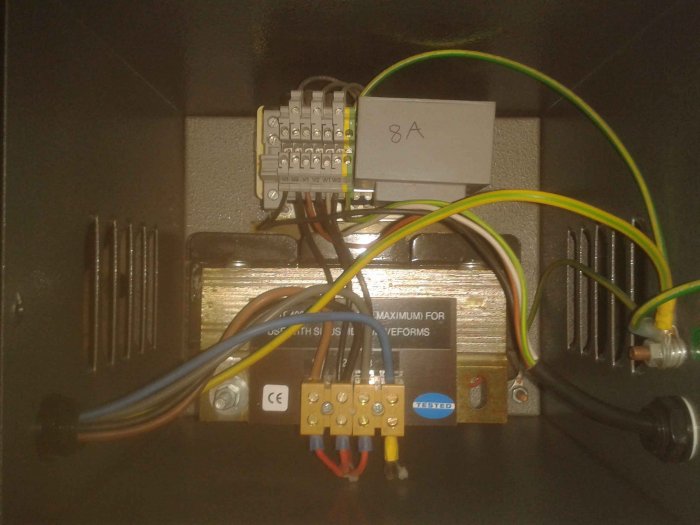

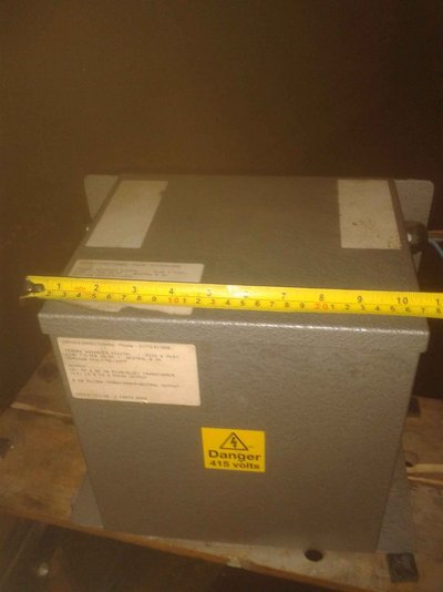

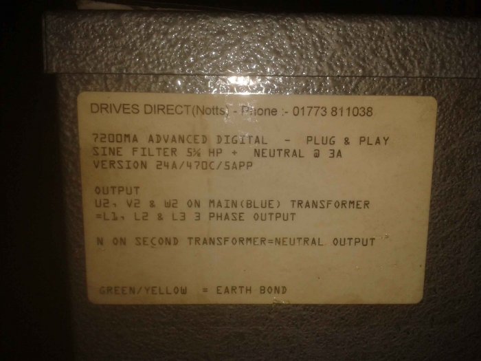

This is the unit I have, I have never had it connected, its all in a well made hammer finished silver box. very very approx 250X250X250.
connects to the inverter, and then from the Sine box to the Motor. The motor I have the Unit connected to is big old Polishing machine, with --I think about a 2 Hp Motor, sadly the Jaguar drive I got recomended, kept tripping out under load, it kept loosing a phase, on paper it should have powered the machine with loads to spare. A reset and off it went again till it tripped again under load, this bigger unit has never ever tripped.
So all I have connected is the Inverter and the Motor.I dont use the Sine.I still have Speed control up to 100%, and Fwd and Rev,( 3 phase 220Volt can give 200% speed control) so my 2850 motor does 2850 at 100%
