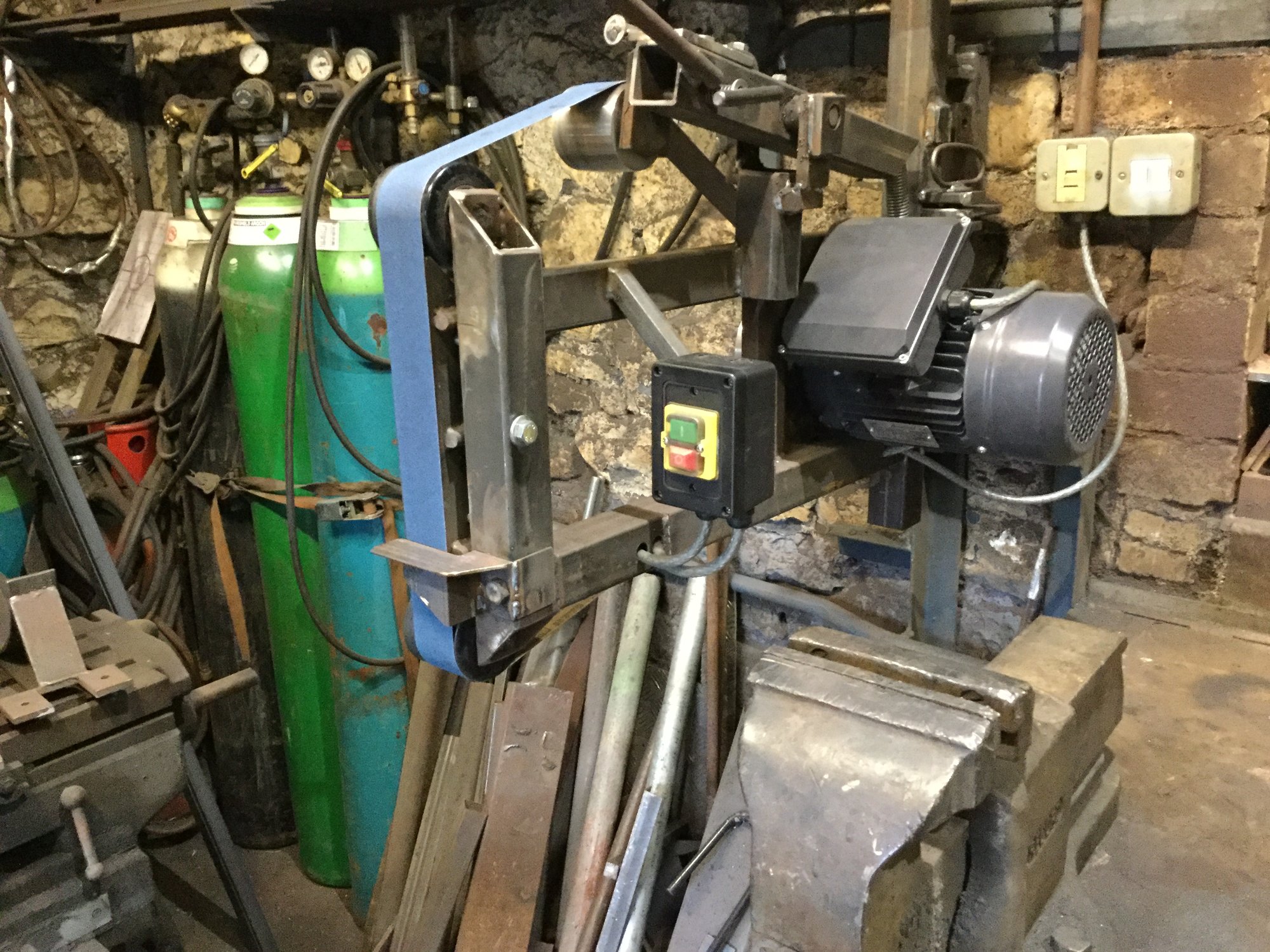

A bit more done on this today.

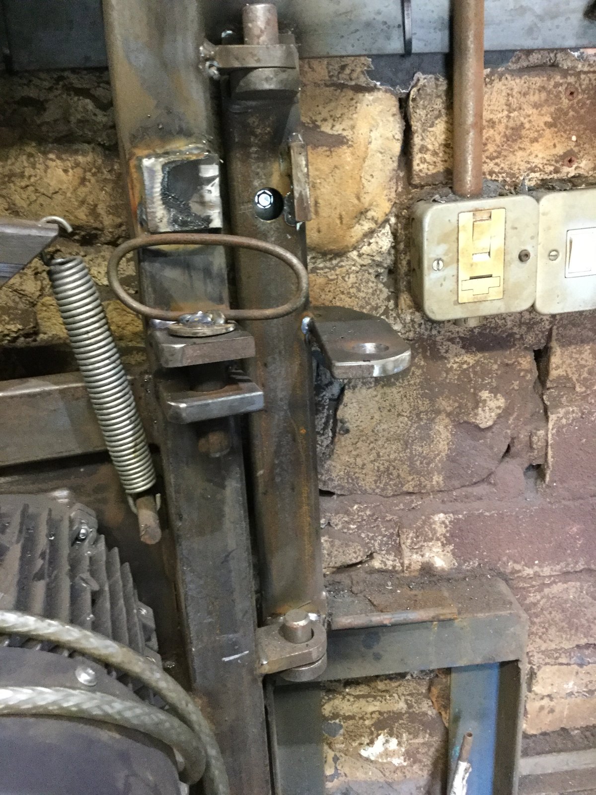

Altered the fixings to hold it in position.
Made a new tracking wheel because i thought i'd have trouble turning the polyurethane.
Made a new aluminium one and crowned it.
It still wasn't running right so took off the driving wheel and put a crown on that.....loads better and the tracking worked ok.

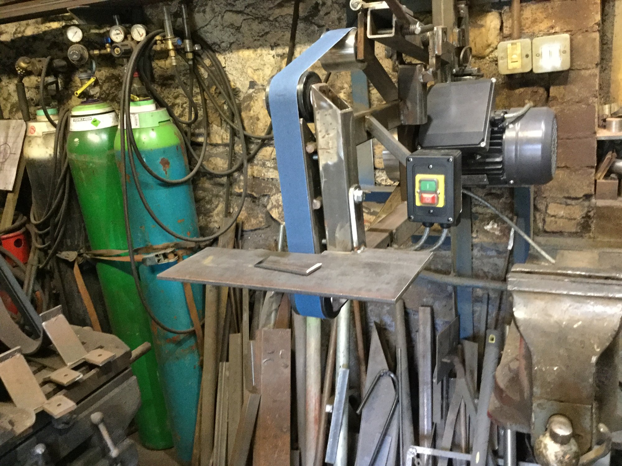

Made a bit of a table that folds out of the way when it's against the wall.
It seems to remove material pretty quick......just need to watch the sparks coming back round on the belt.
Just need to wire it in a bit more permanently.
