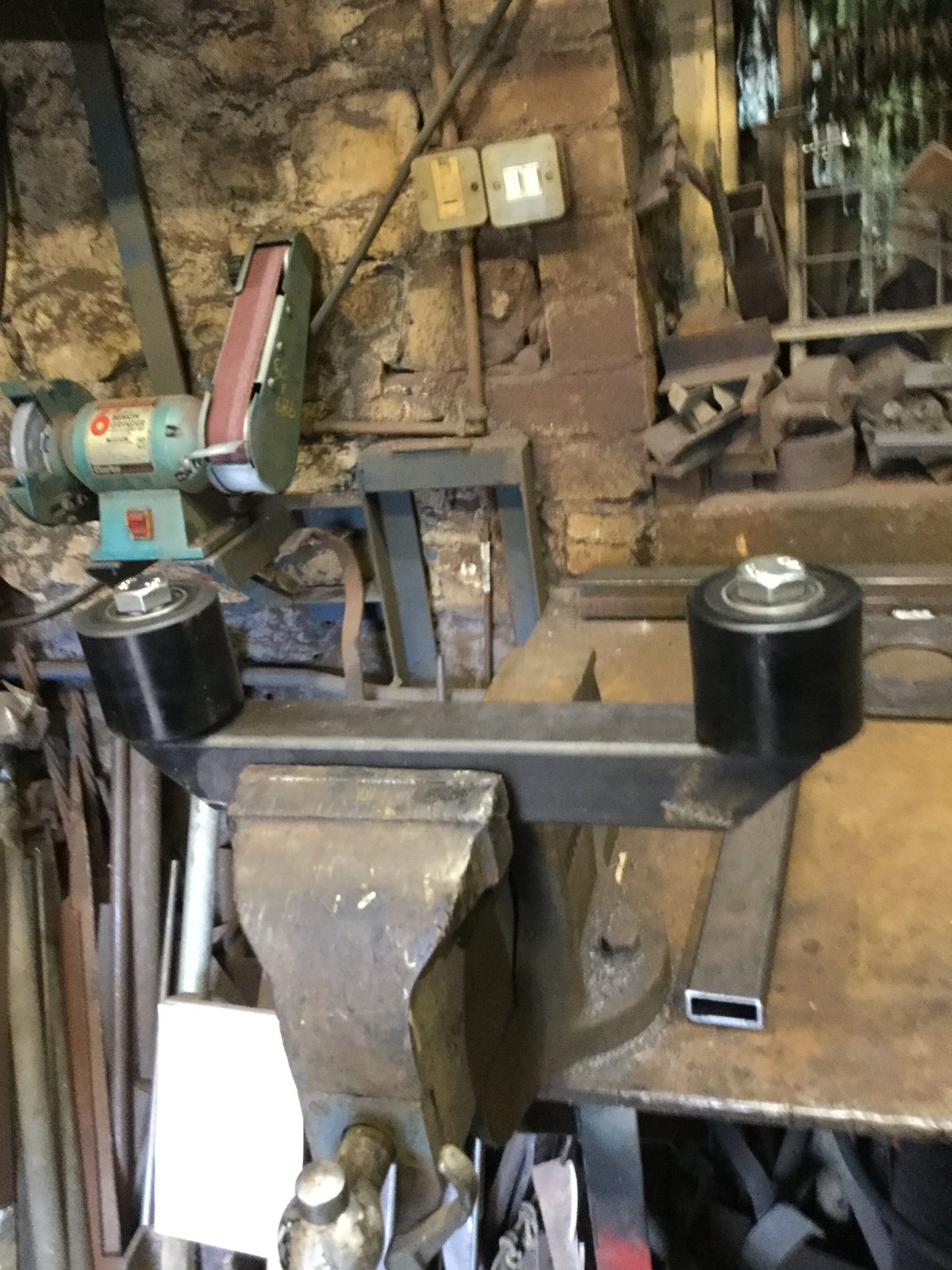

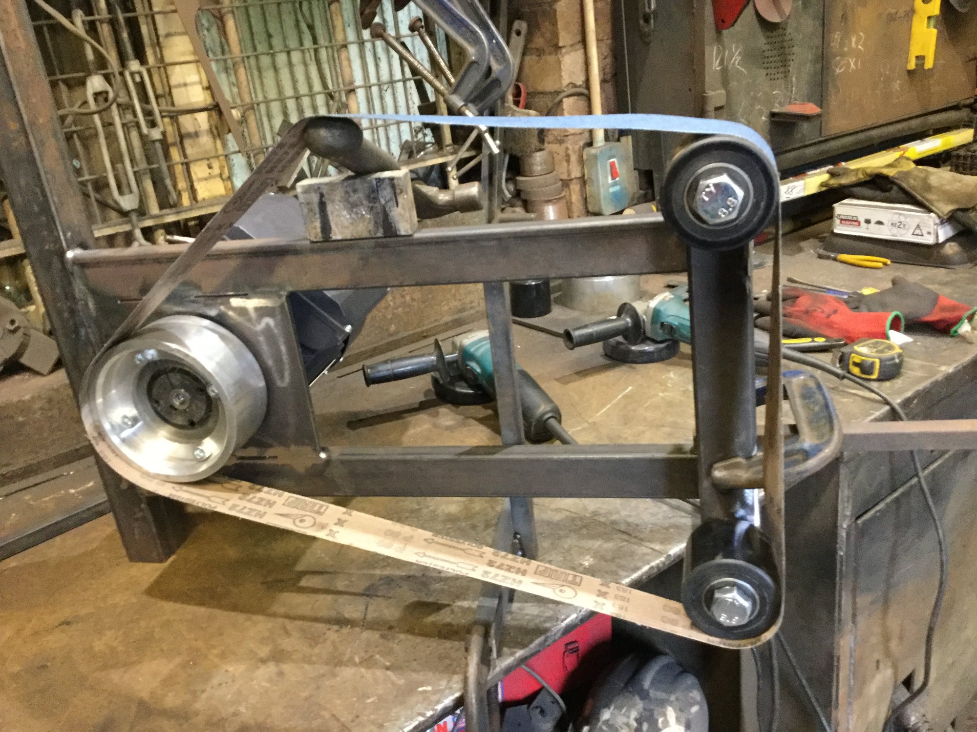

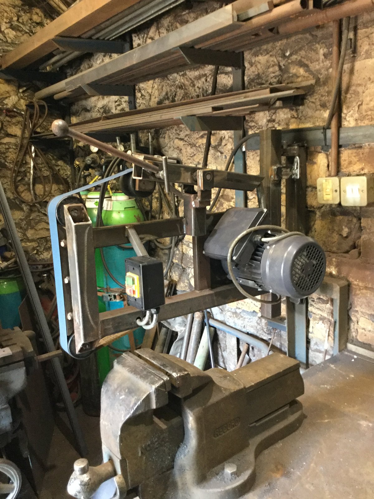

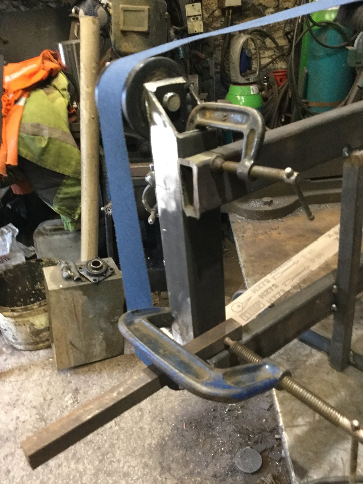

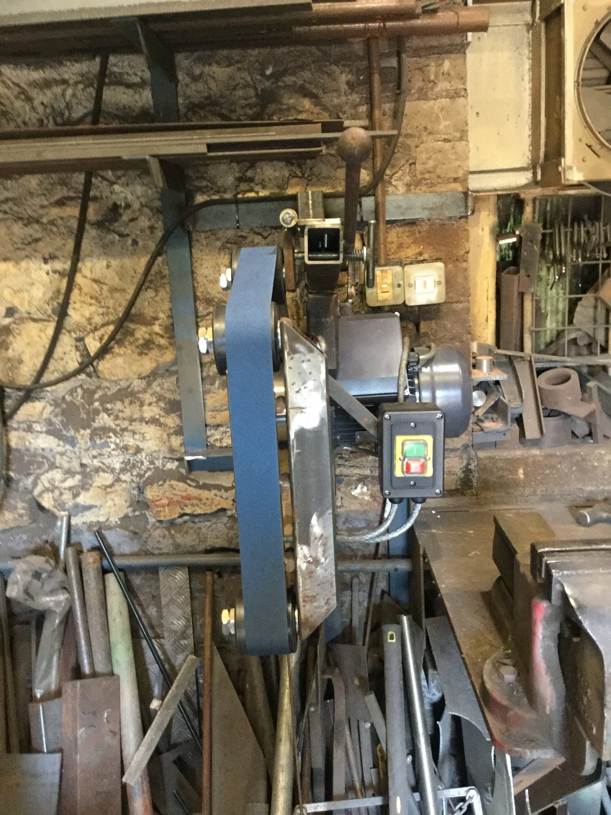

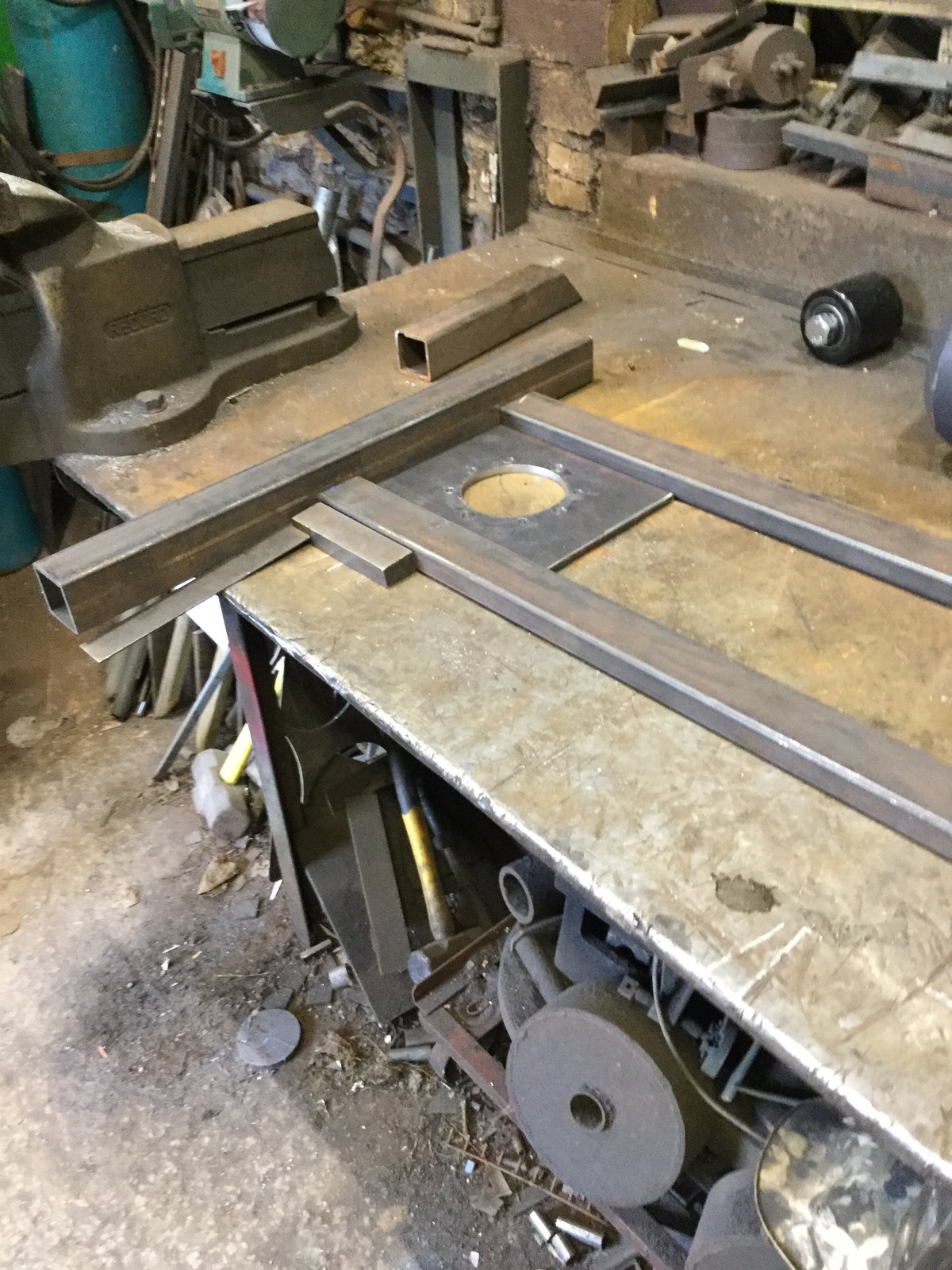

I've just started having a go at making a belt grinder.
It will use 2"x72" belts and be powered by a 2hp motor.
The pics below show a couple of hours today.
The bits...
- 2 hp 1ph motor
-3 PU wheels
- An assortment of belts
- taper lock pulley
- 6" diameter aluminium.

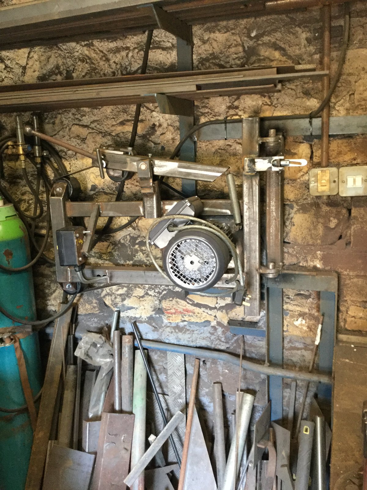

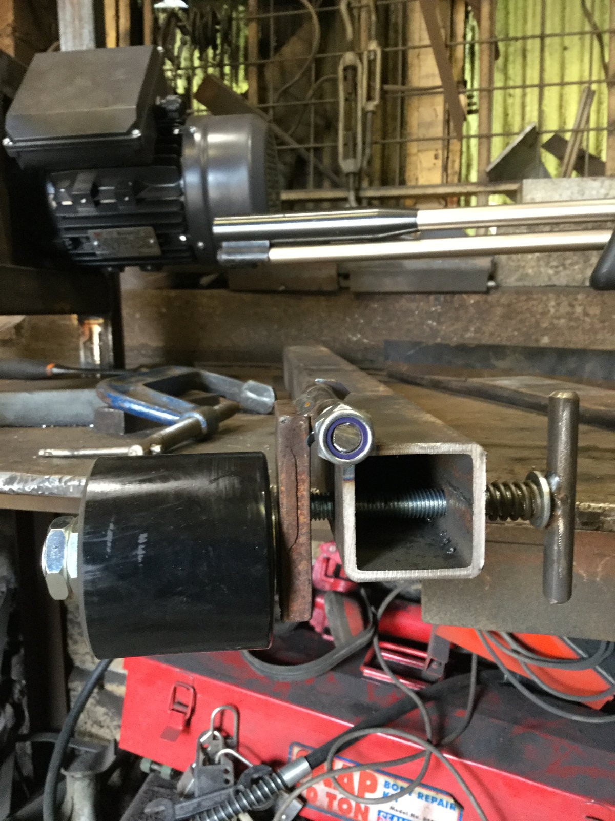

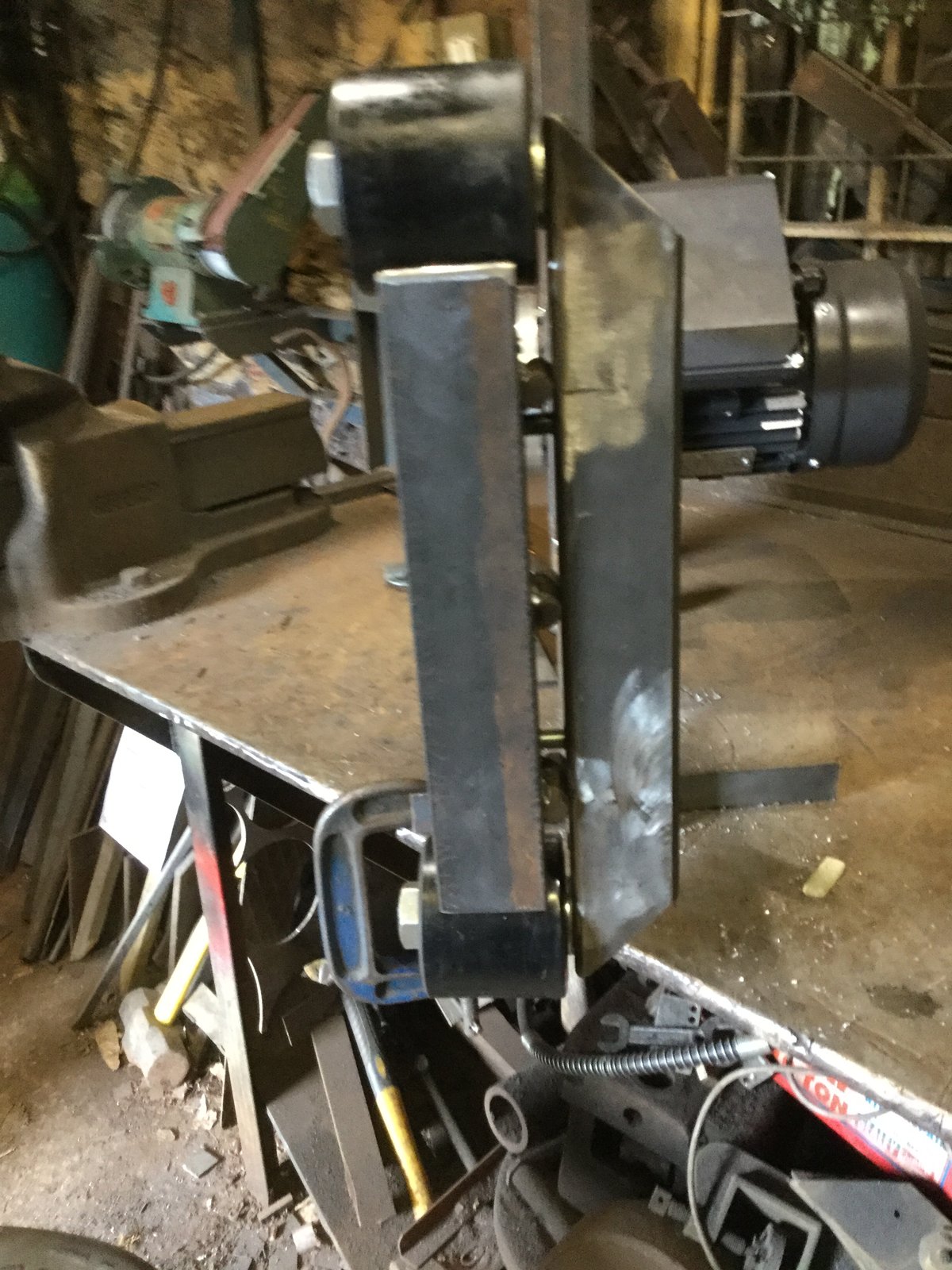

The idea is to mount it where the clarke grinder/sander is. Fix it to the wall on pivots so it can be folded back when not in use.

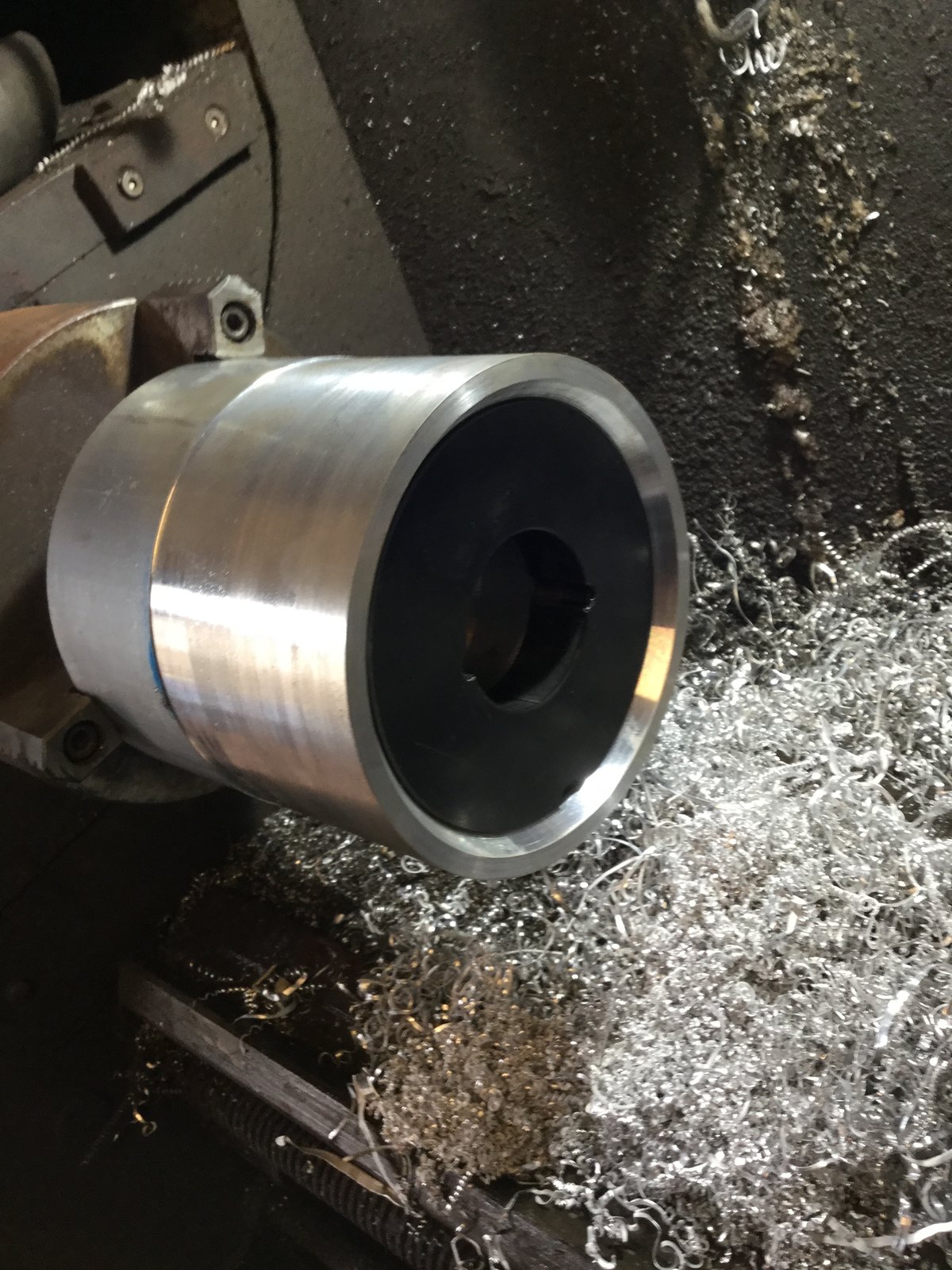

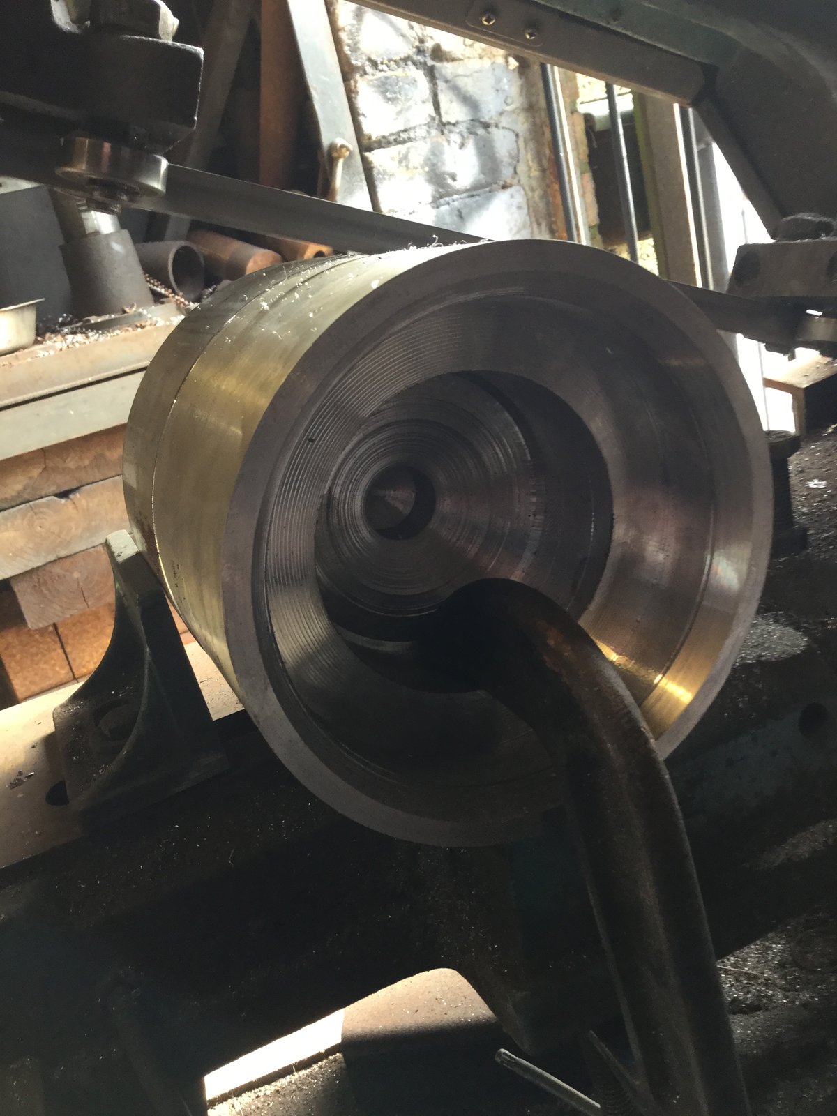

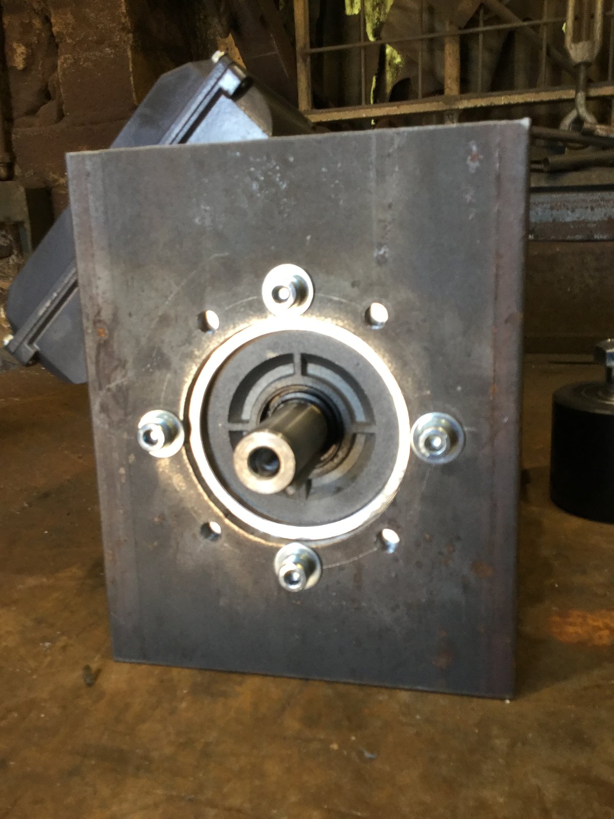

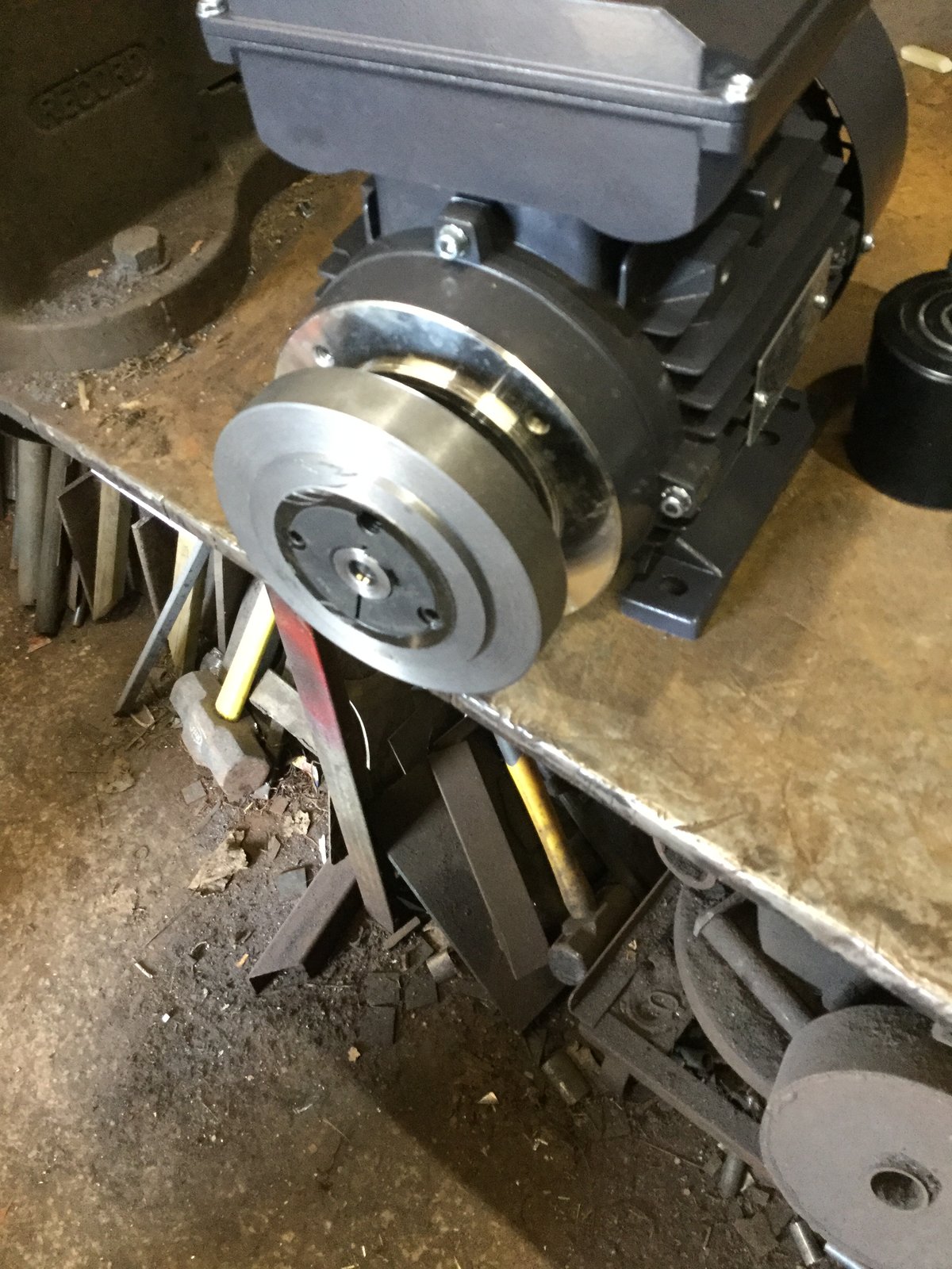

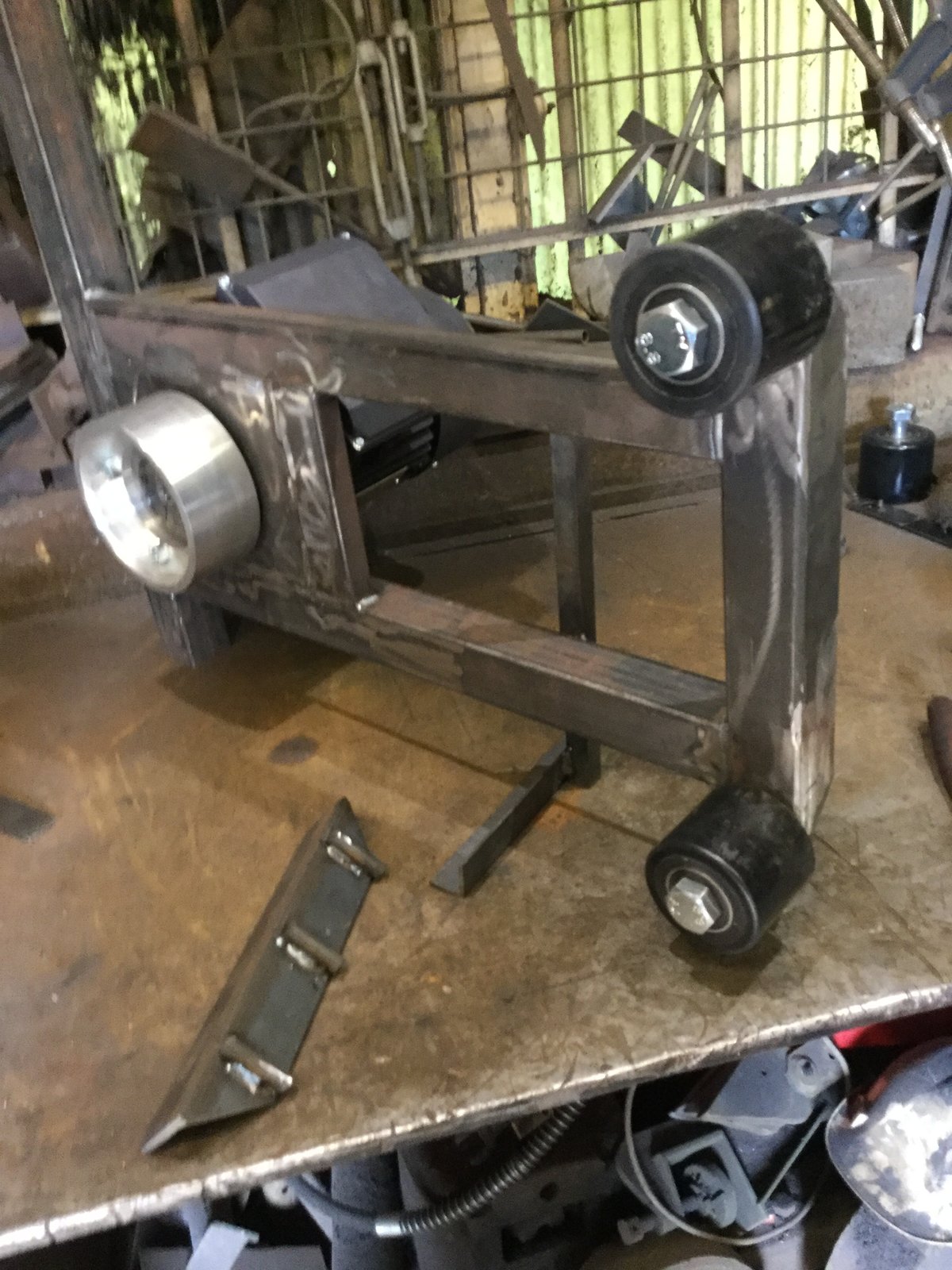

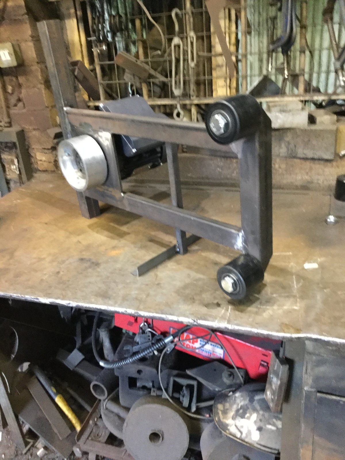

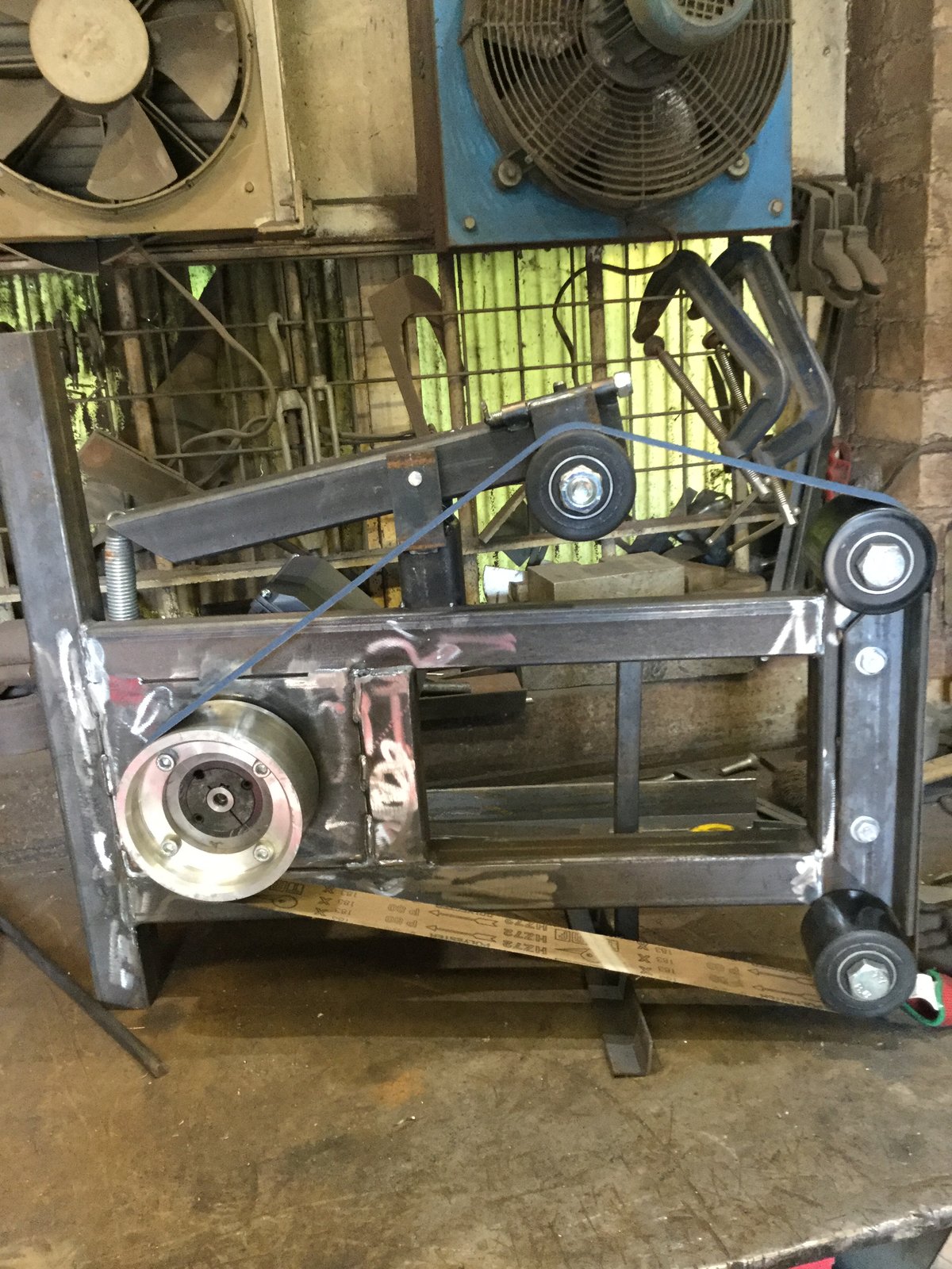

Turned down a tube to 24mm to mount the pulley in the lathe

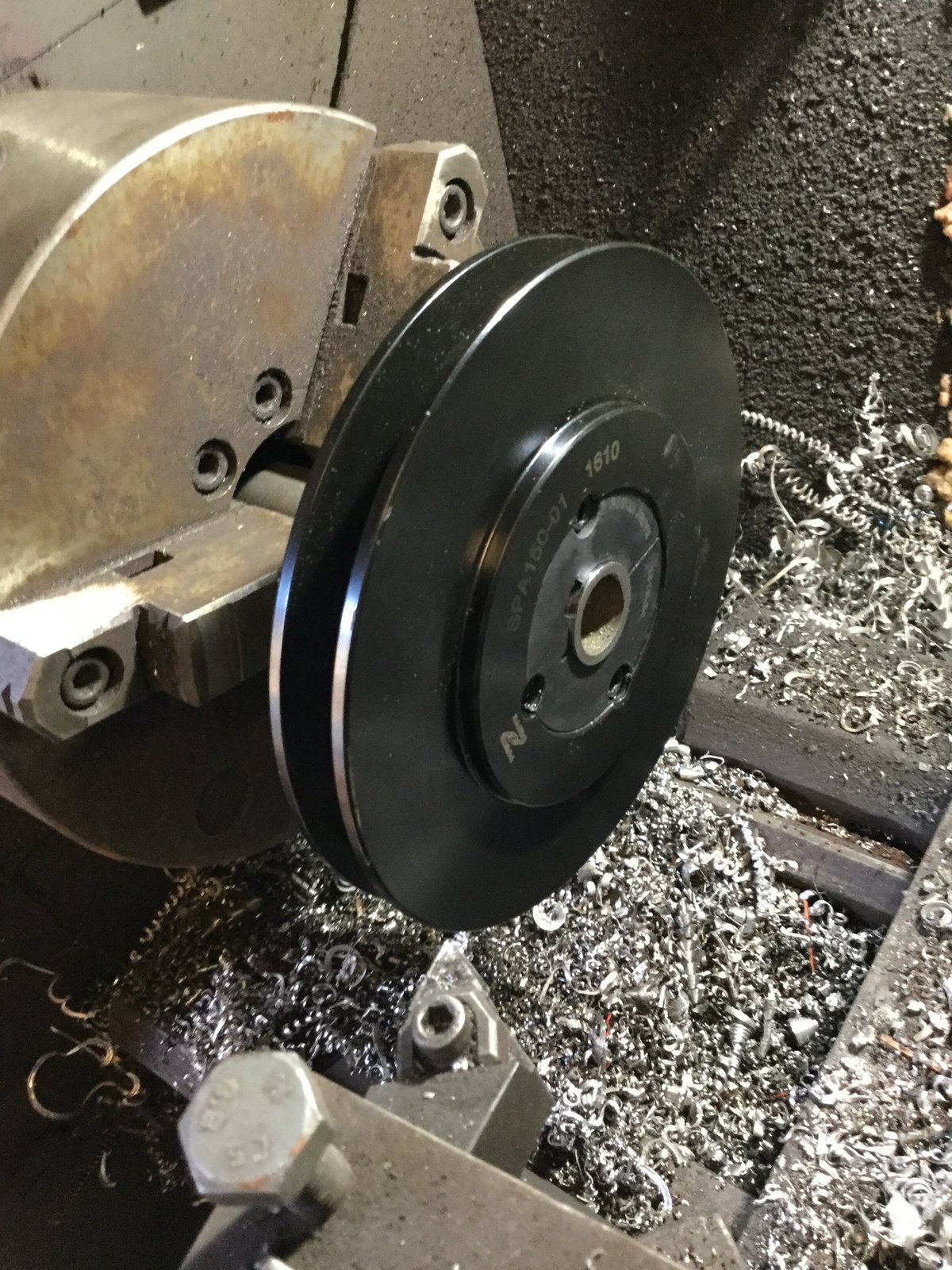

Turned it to get rid of the "sheaves"
Mounted it on the motor. Put a DTI against it and it was pretty good.

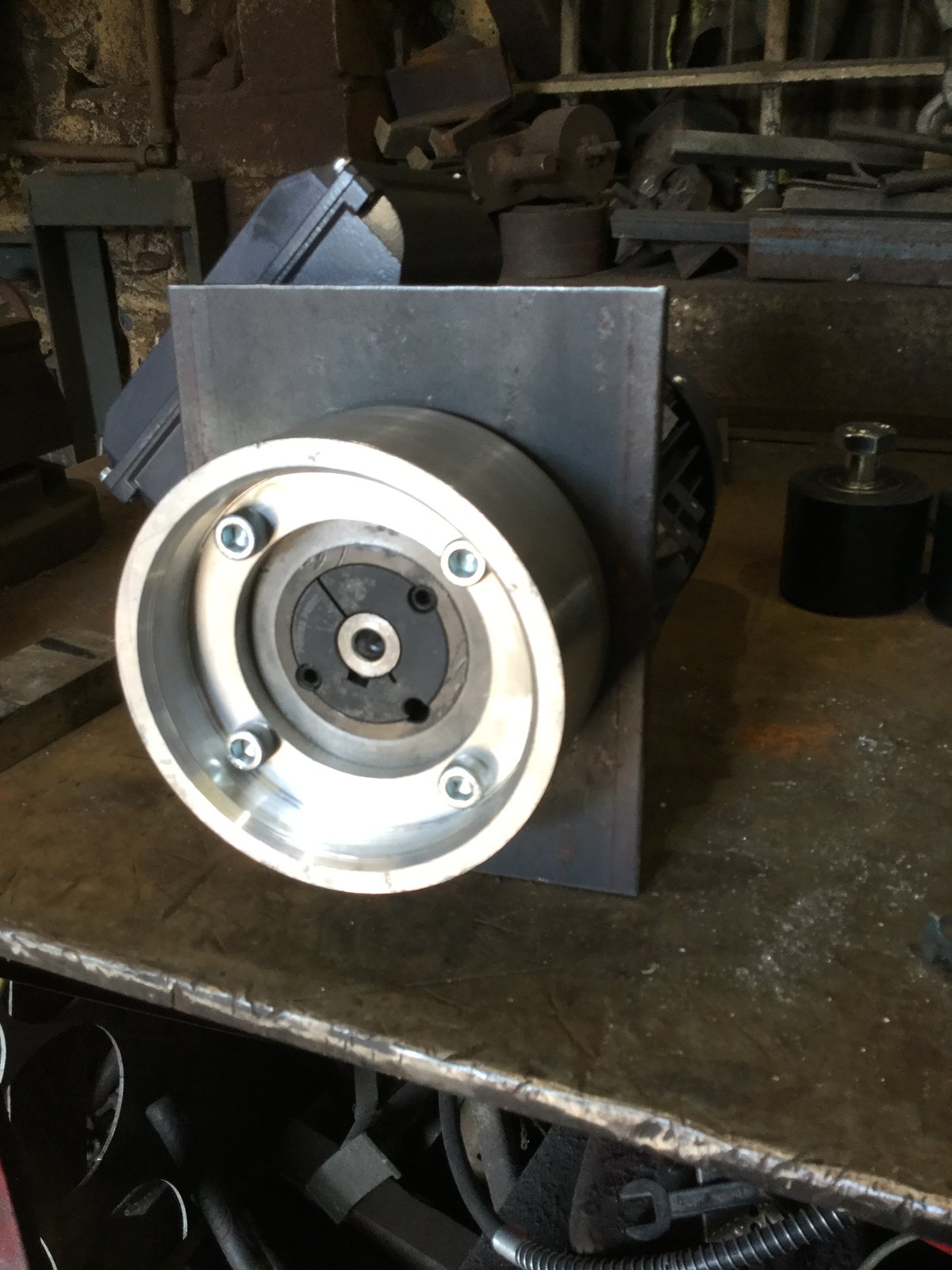

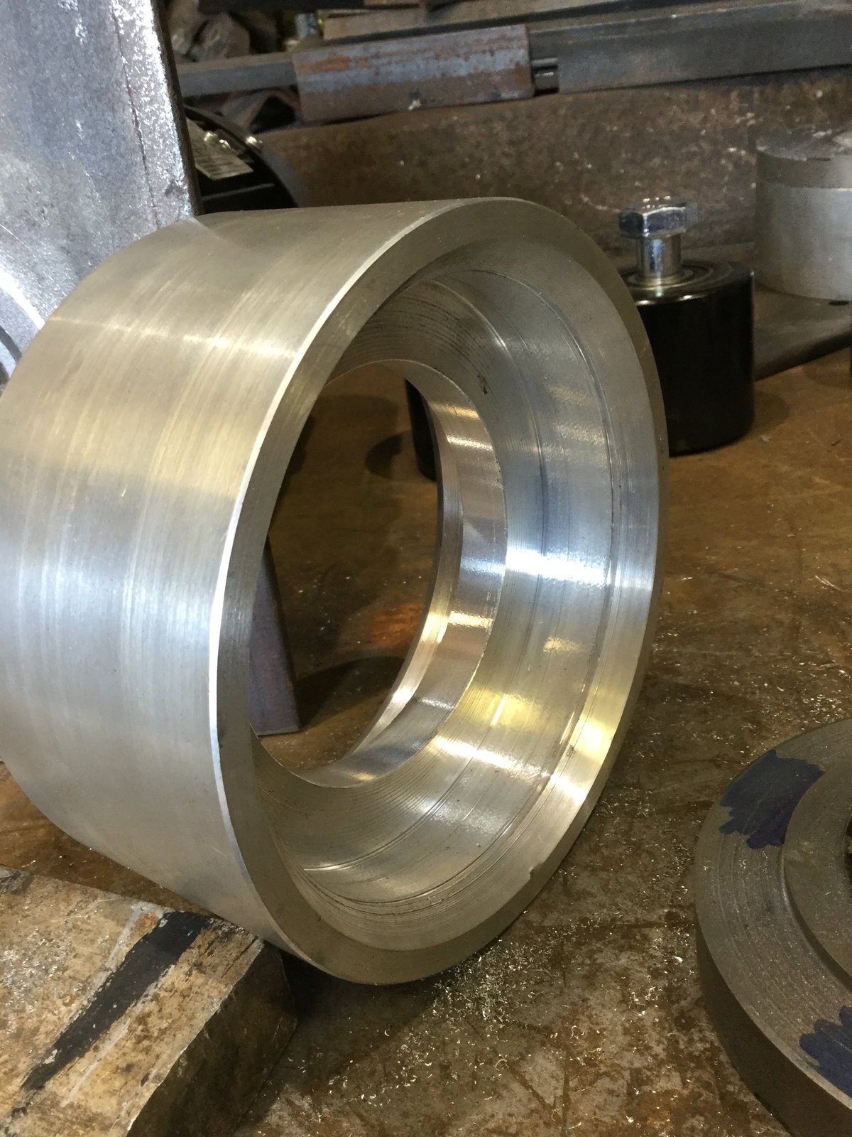

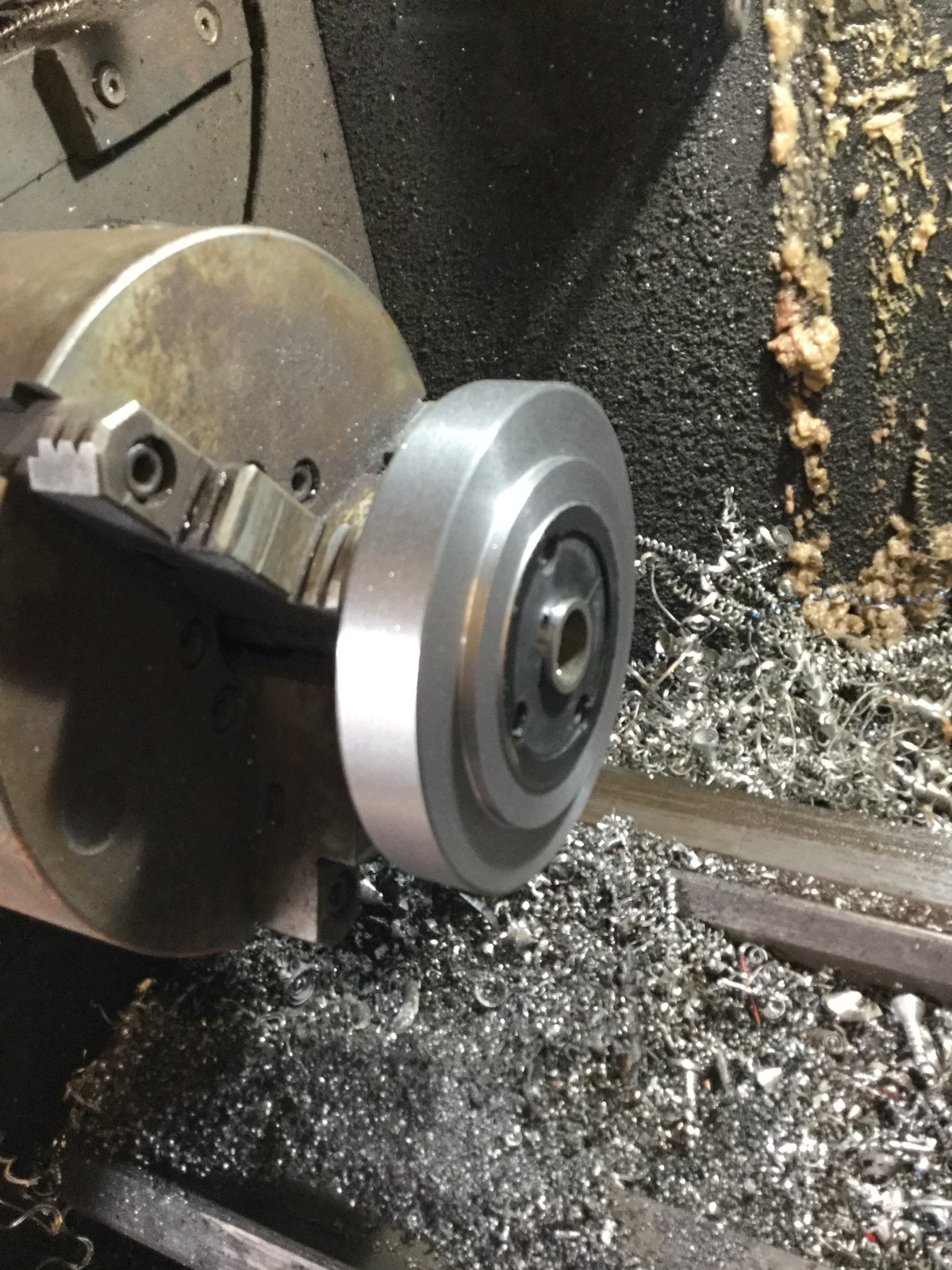

The idea now is to turn the aluminium into a flat pulley/wheel which will bolt to the cast iron pulley.

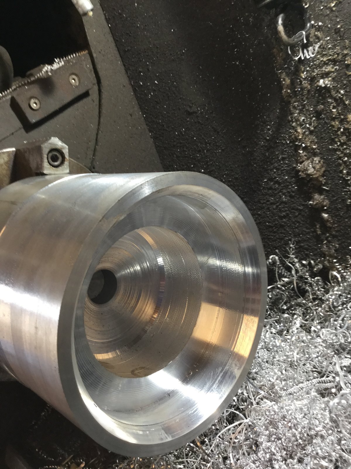

Turning the aluminium to fit the cast pulley.
Testing for fit...seems ok.

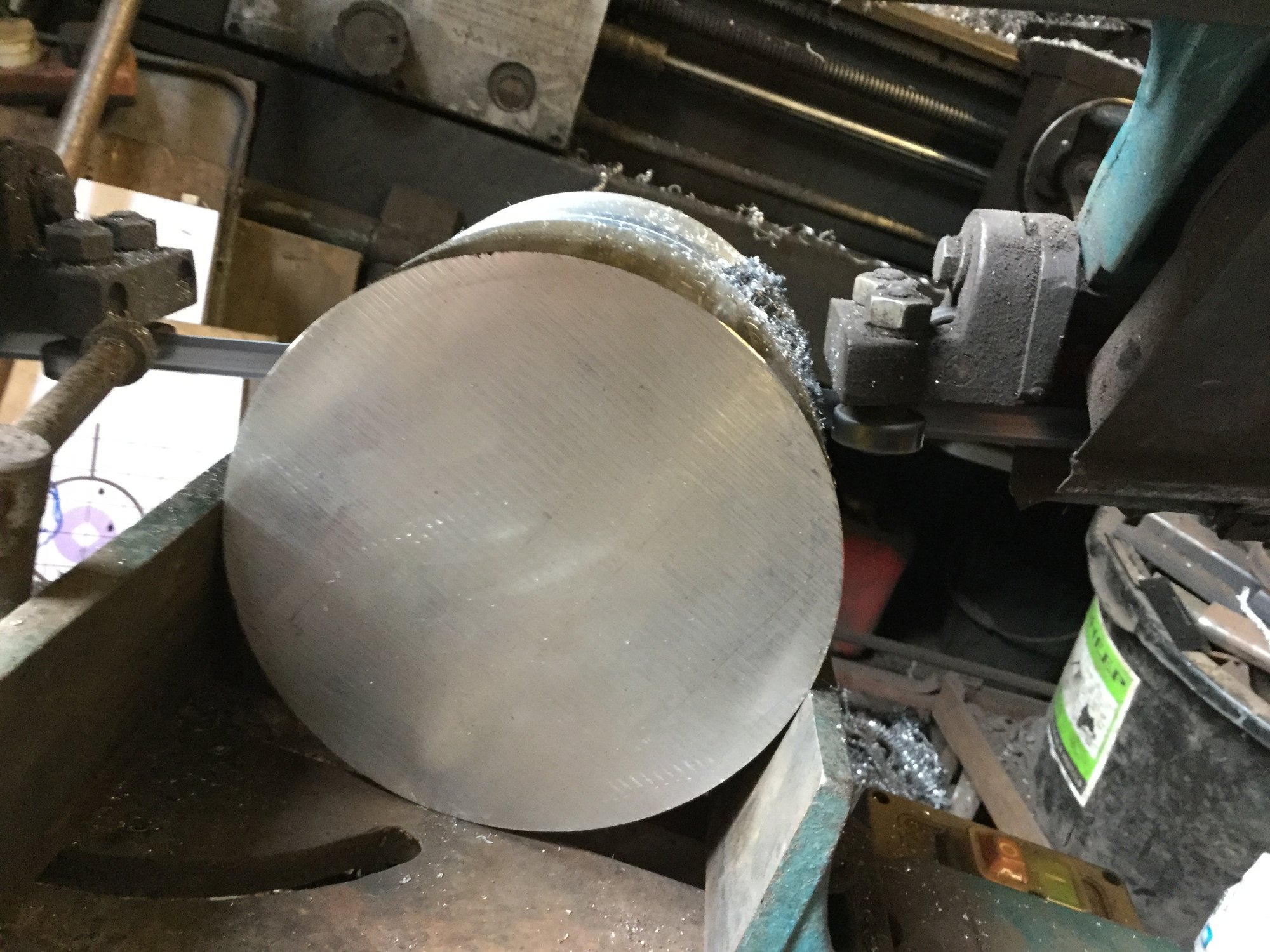

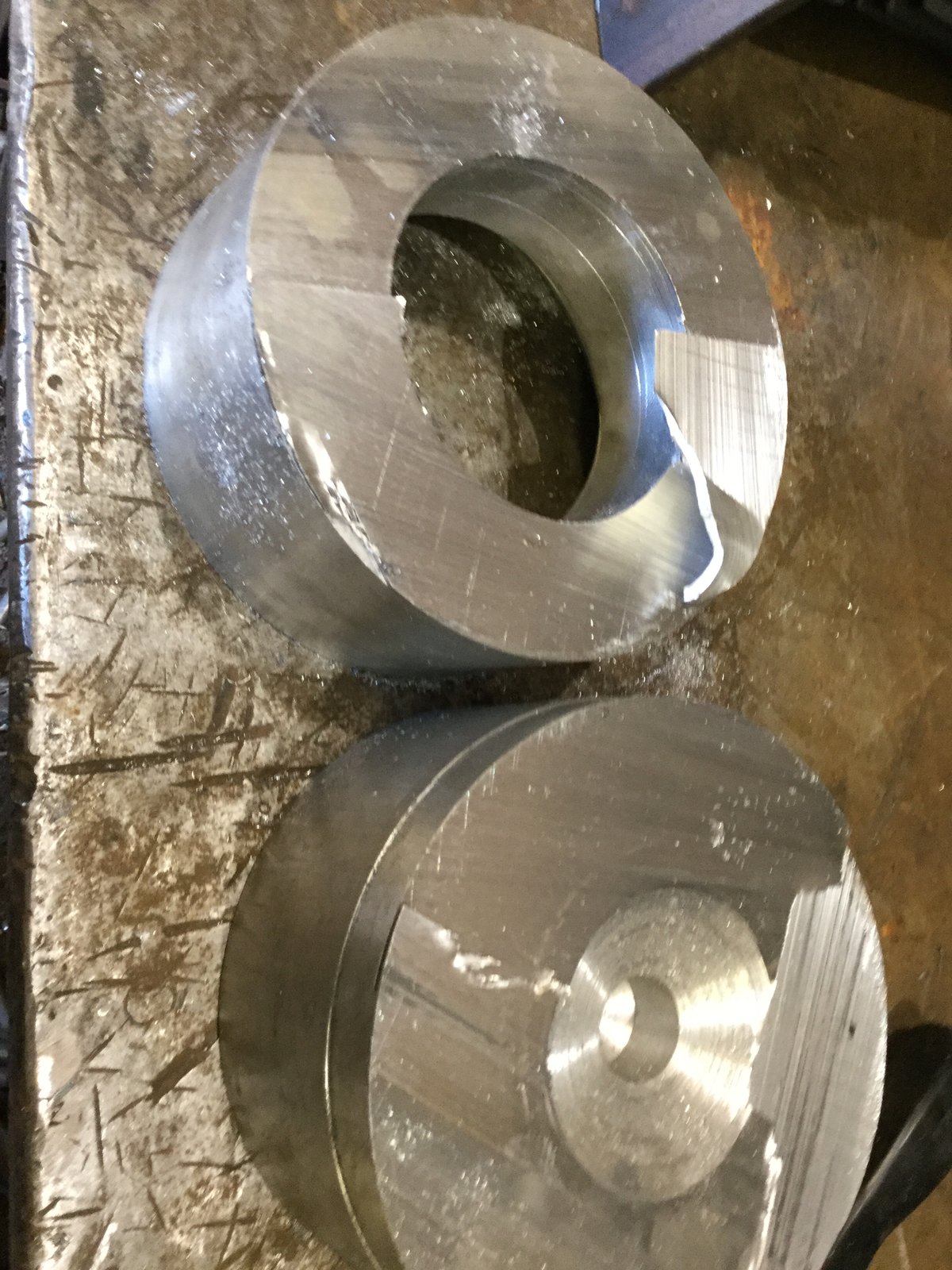

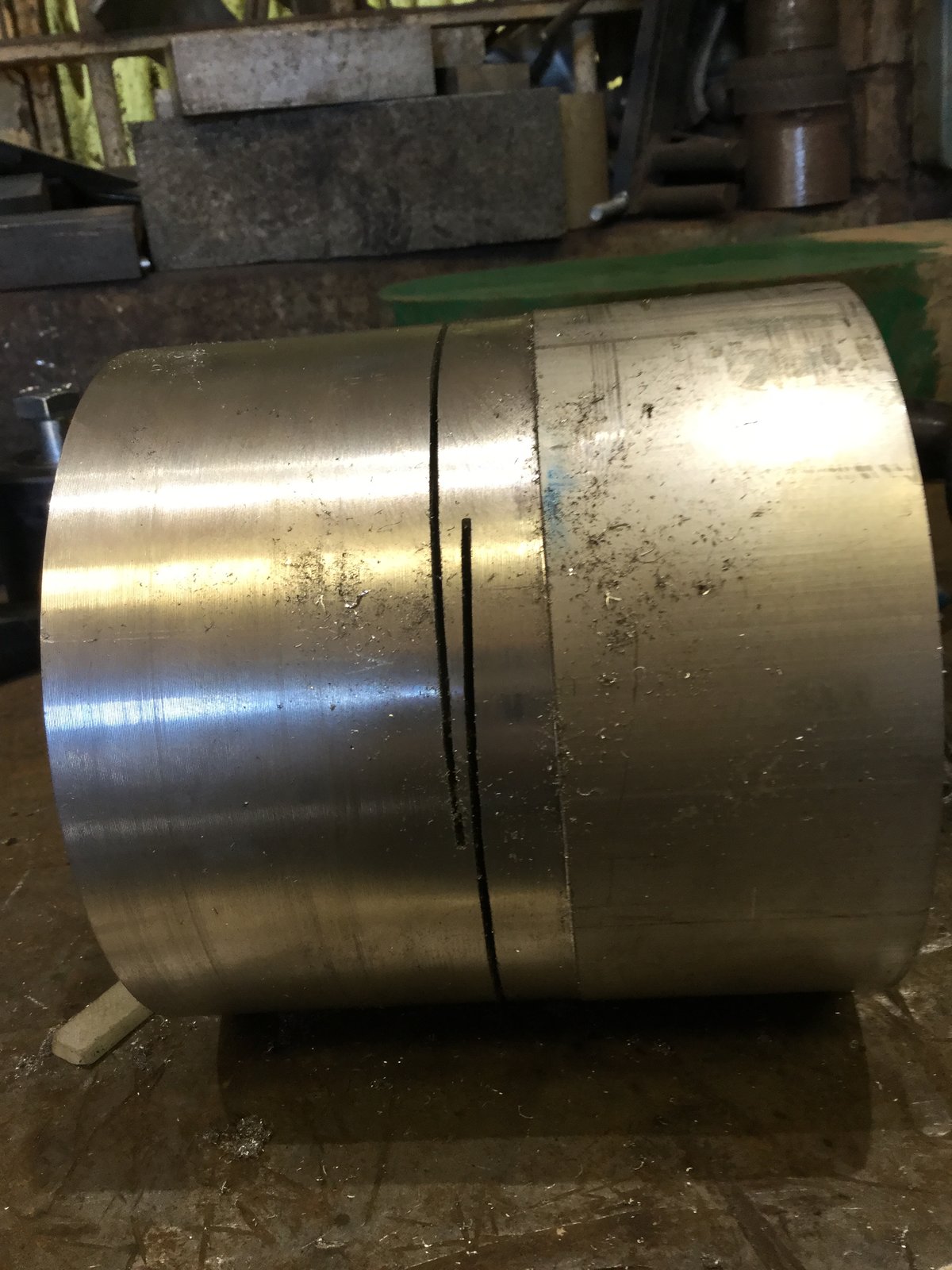

I got 6" of aluminium because i thought i would need the extra to hold it when turning.... didn't really think that one through and now need to cut it in half.
I dont know if the old clarke bandsaw will handle it.....still a couple of mm to spare.
That's as far as it got today.
