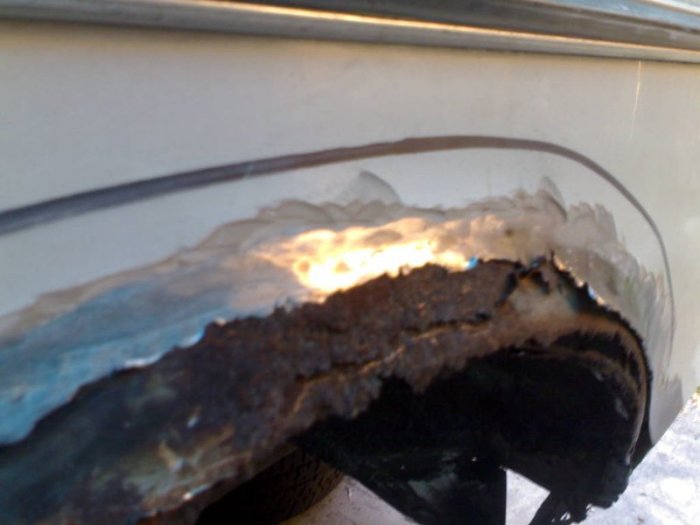

Finally got a new gas bottle, hoorah!
Man sized too.
Spent the next 4 hours getting angry, fiddling with settings and making holes. Eventually filled more than I made, and ground them down a bit before the light went. It's not quite perfect, I'll go over it again with a light flap disc when I come to clean up the entire wing and get it smooth and flat.
