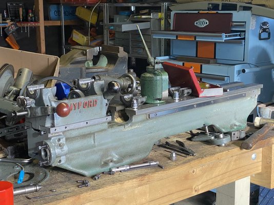

That little Centec is a work of art. Would love one!

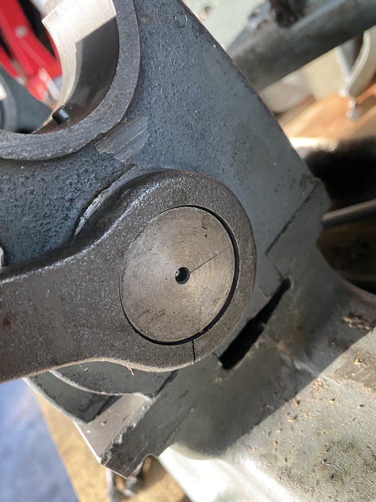

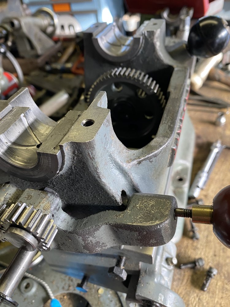

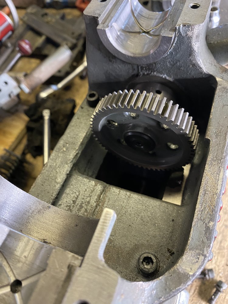

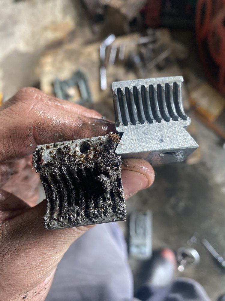

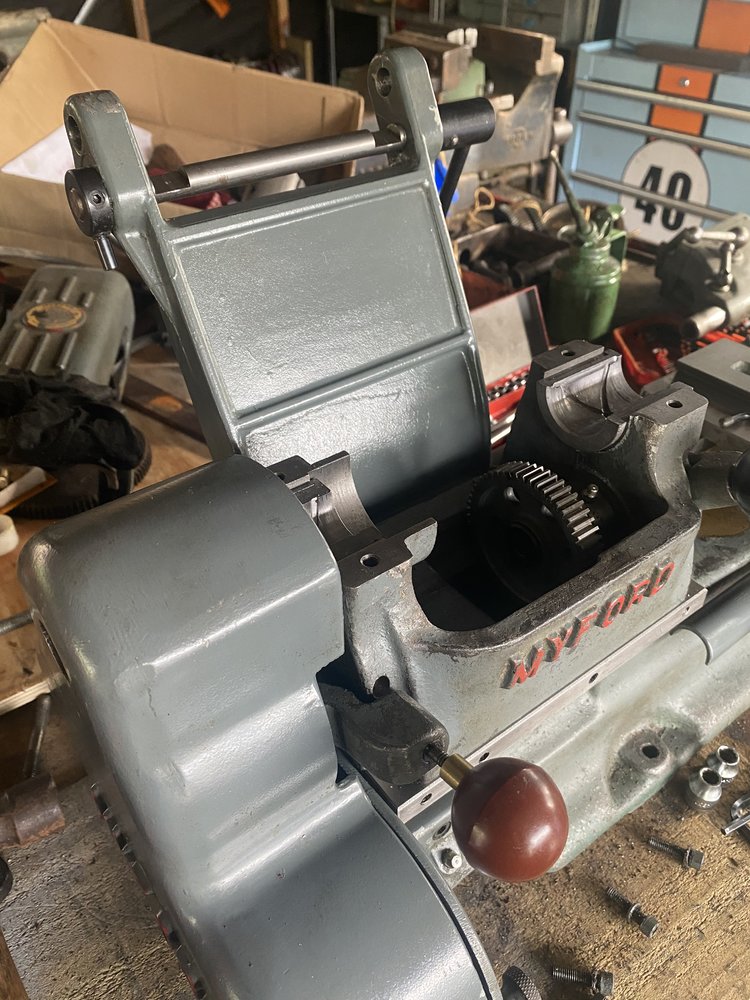

More grease blown out. I’m wondering maybe to just replace the nipples.
there not grease nipples. there all oilers on the myfordMore grease blown out. I’m wondering maybe to just replace the nipples. This is for the back gear engagement

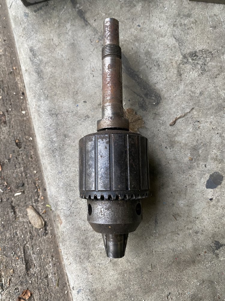

To me, the thread would indicate draw bar attachment.................................... Is that Jacobs chuck for a mill? Haven’t seen that fitting on it before.
Why’s that? I don’t see myself using them.

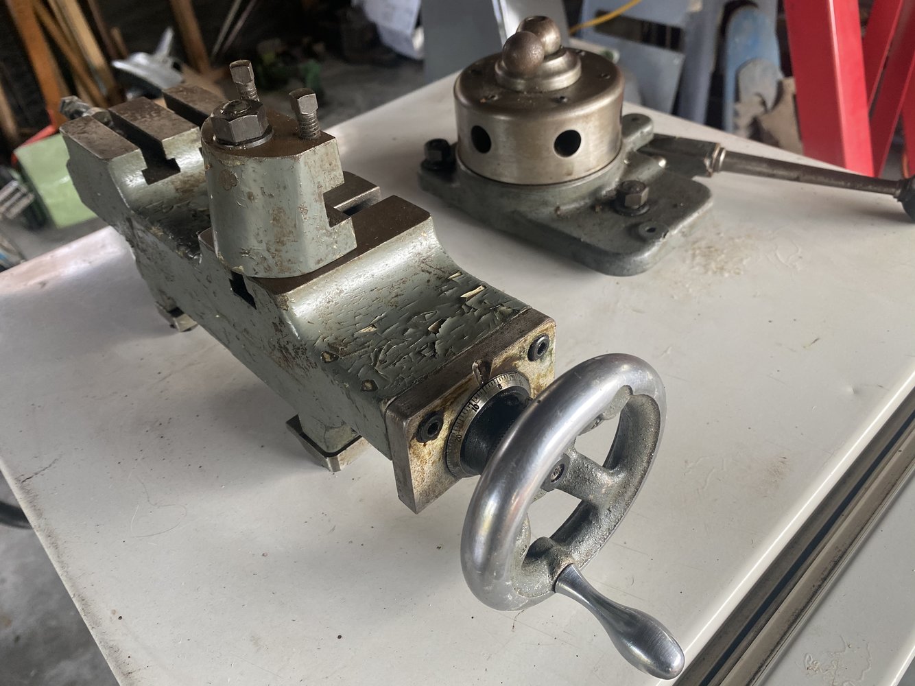

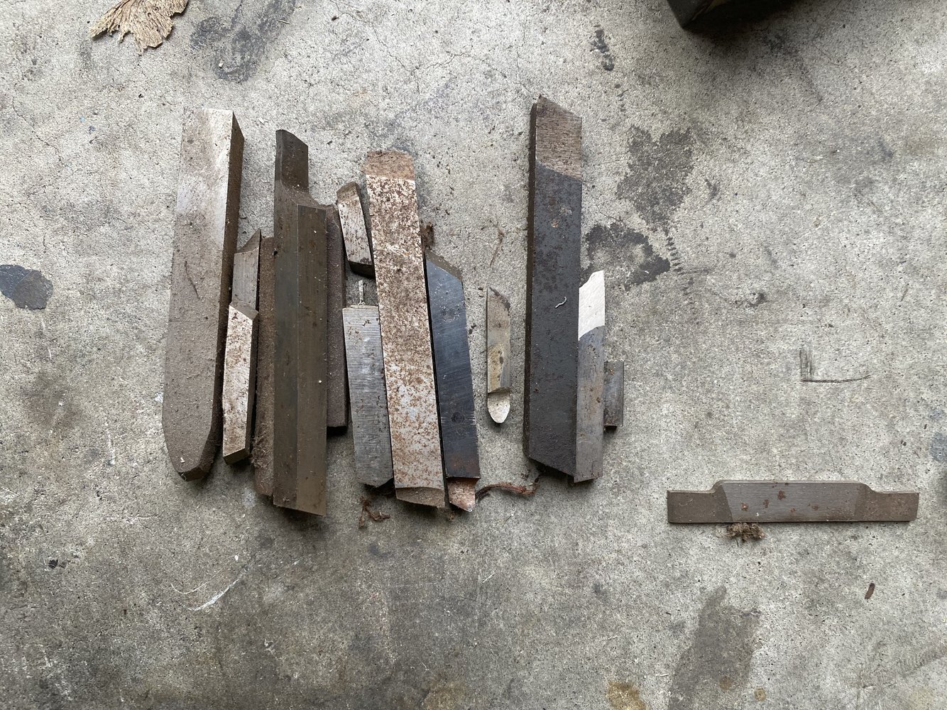

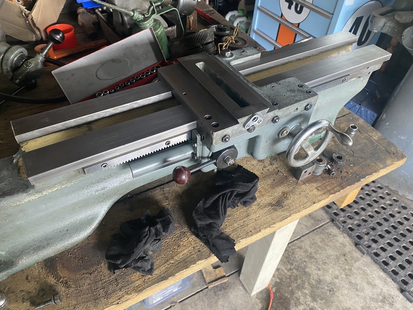

See if you can rear mount the parting off holder & part off with the tool upside down, its the recommended way on small lathes.
The one that goes on the rear of the cross slide is different (see https://www.ebay.co.uk/itm/234008992038).
