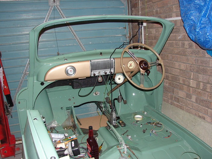

Hey Gavin....ya missed a bit. Underside of the windscreen top rail is still in grey primer on one side!It can wait until we nip back for the polishing.
I'm gonna have to drop your score to 99.9 out of 100.
Sorry, how did i miss that will sort it out when it comes back for a polish

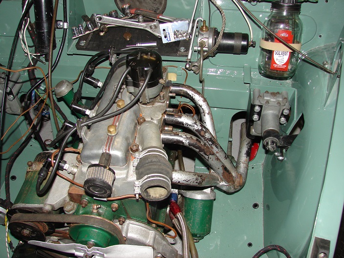

) Moss etc are fine for the Morris 1000 stuff but the pre-1953 stuff is very hard to come by. Lots of little things are different such as the pedal position, the drivetrain rubber mountings and wiring loom. Even the front suspension legs are different, having imperial bearing sizes whilst the Morris 1000 had metric ones. Most of the early stuff is N.L.A. I've had the gearbox crossmember on and off five times so far. since you can't get the engine in or the gearbox mounts changed with it bolted down, unlike the later cars.
