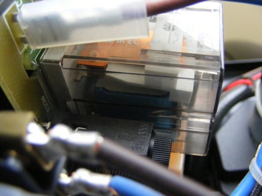

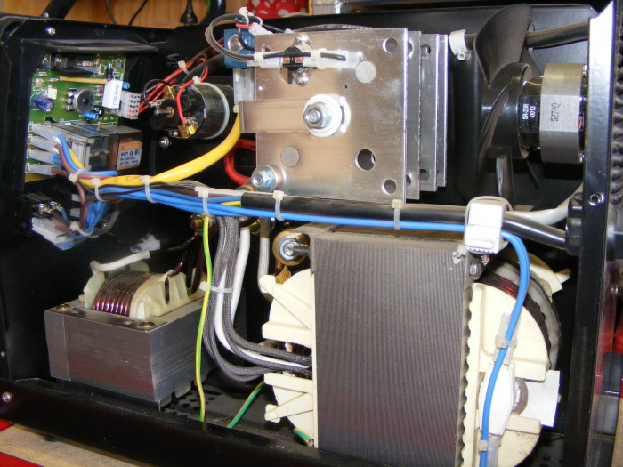

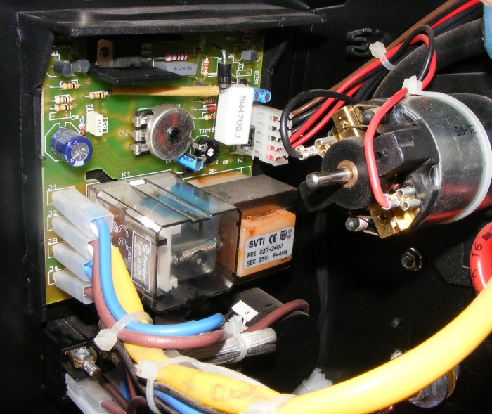

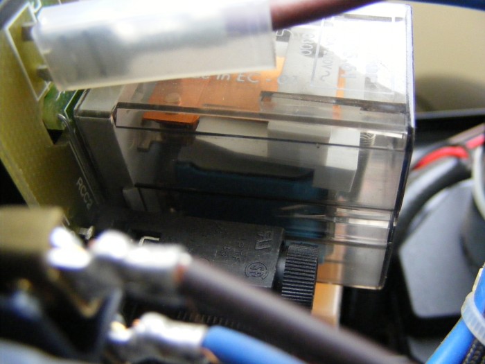

Take a peek at some old pics of my welder internals to determine if you think they might be similar:
and the close up on the fuse holder....
Other note: The manual refers to an "Internal 1A fuse" when "Mains indicator light is lit but welding arc cannot be established"
What is the value of my PCB fuse??? Sorry, I never checked when I took these photos.... let me know if you would like me to open it and see..
