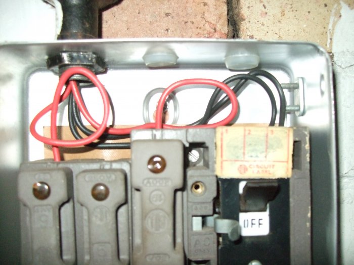

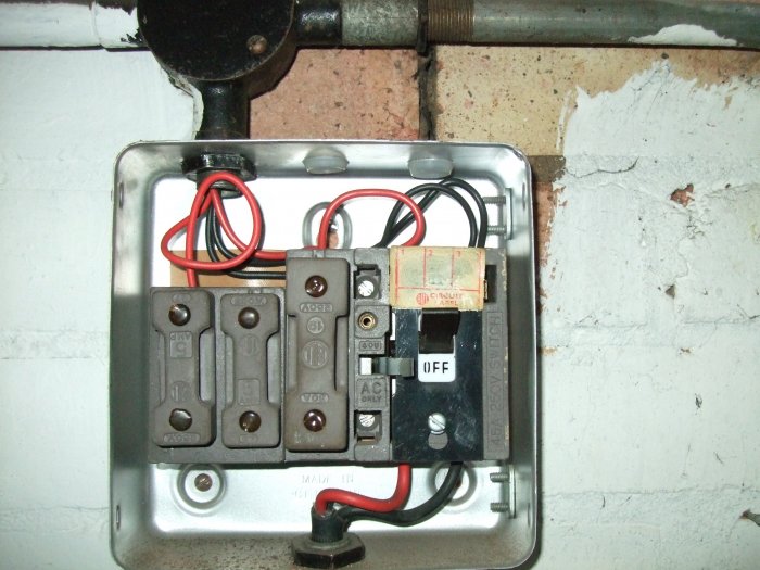

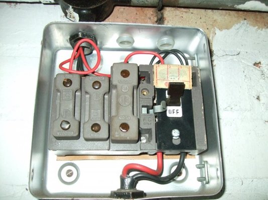

You won't need to fit a new fuse into the existing box. You can run a 16-20A cable from the output of the 30A fuse through the grommet directly above, along the wall to a wall-mounted small 4-way consumer unit box. This box would have an isolation switch, like your fuse box. This would be your dedicated welding supply. The box would contain a 16A mcb, and preferably a rcd, although this isn't essential, but safer.
From your cu box a 16A preferably armoured cable would run to a 16A wall socket. You would plug your welder into this socket. In the event of any problems on the welding side, the 16A cutouts in the cu box would operate, tripping out and protecting your original fuse box.
All the above could be done without altering your present council fuse box in any way, apart from a new output cable from the 30A fuse. If you moved away, all could be removed easily and taken with you.
Any competent electrician who didn't talk too much could do the job in an hour, including testing. About £30 - £40 around here. The bits would cost rather more than this, but an obliging electrician might be able to get these at wholesale price for you.

Looking at it closer it seems that the 30 amp fuse supplies the sockets on a spur. You could convert that to a ring & fit the fused outlet for the 16amp plug on to that ring.

Or do the lights need to be on separate fuses? Put them on one & then buy a new fuse of a higher rating to make the new supply for the 16 amp sockets.

just take a 2.5mm flat twin and earth cable out of the 30 amp fuse down through a double pole 25 amp or a 60 amp rcd with a 30miliamp trip into the 16amp socket . then down rate the fuse from 30 amp to 16 amp as it shouldnt be a 30 amp feeding 2.5mm radial cable that is allready there
typical councill job no earth ring on the incomer armoured . the fuse shouldnt be rated at more than 20 amp on 2.5mm cable . if it had been wired in 4.0mm cable to sockets a 30 amp would be ok
Wonder how old is the wiring? It must split at the junction above the box. Certainly agree a 20A fuse would be safer on 2.5 mm, but that old 2.5 mm cable on a 13A circuit was rated up to 24A when new, and was supposed to carry 30A well long enough to blow a 30A wire fuse without serious problems. But it does deteriorate with age and use.
So if there are two separate circuits either would carry enough current to burn a 30A fuse long before the cable got to overheating and burning out. At least that was the thinking at the time, which is probably why they've stuck a 30A fuse in there. Modern 2.5 mm is still rated up to 24A continuous, I think, but may have more safe leeway. Certainly 4 mm is a much safer alternative, with less volt drop, too.
With a separate new cu to isolate the old fuse box there shouldn't be a problem, even if the 30A runs two old 13A circuits as well. It is highly unlikely there will ever be a drain of anywhere near 30A on the old fuse.
