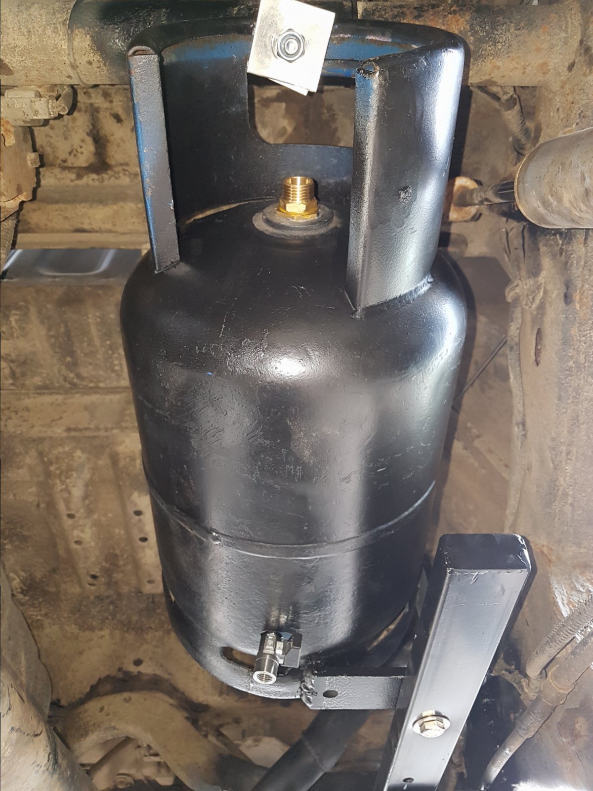

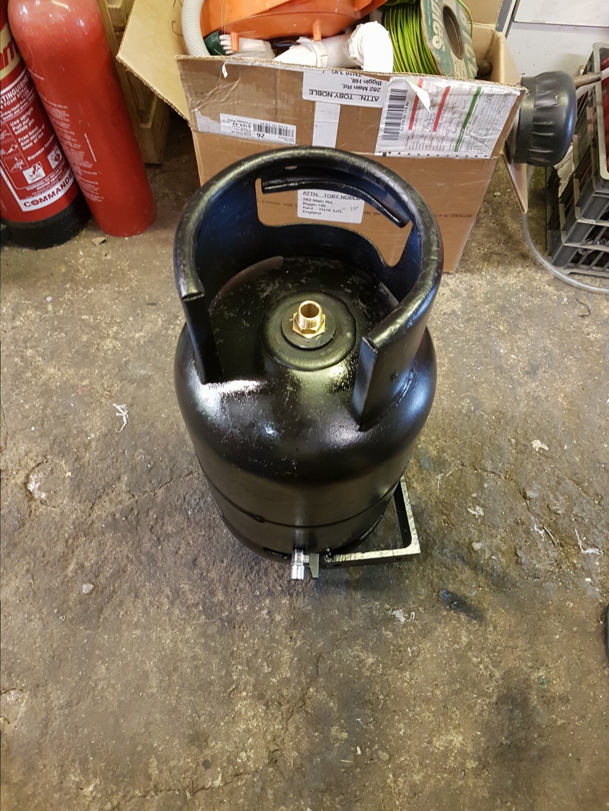

what did you use for a tank in the end?
I acquired a 9kg gas cylinder fits like a glove pics to follow

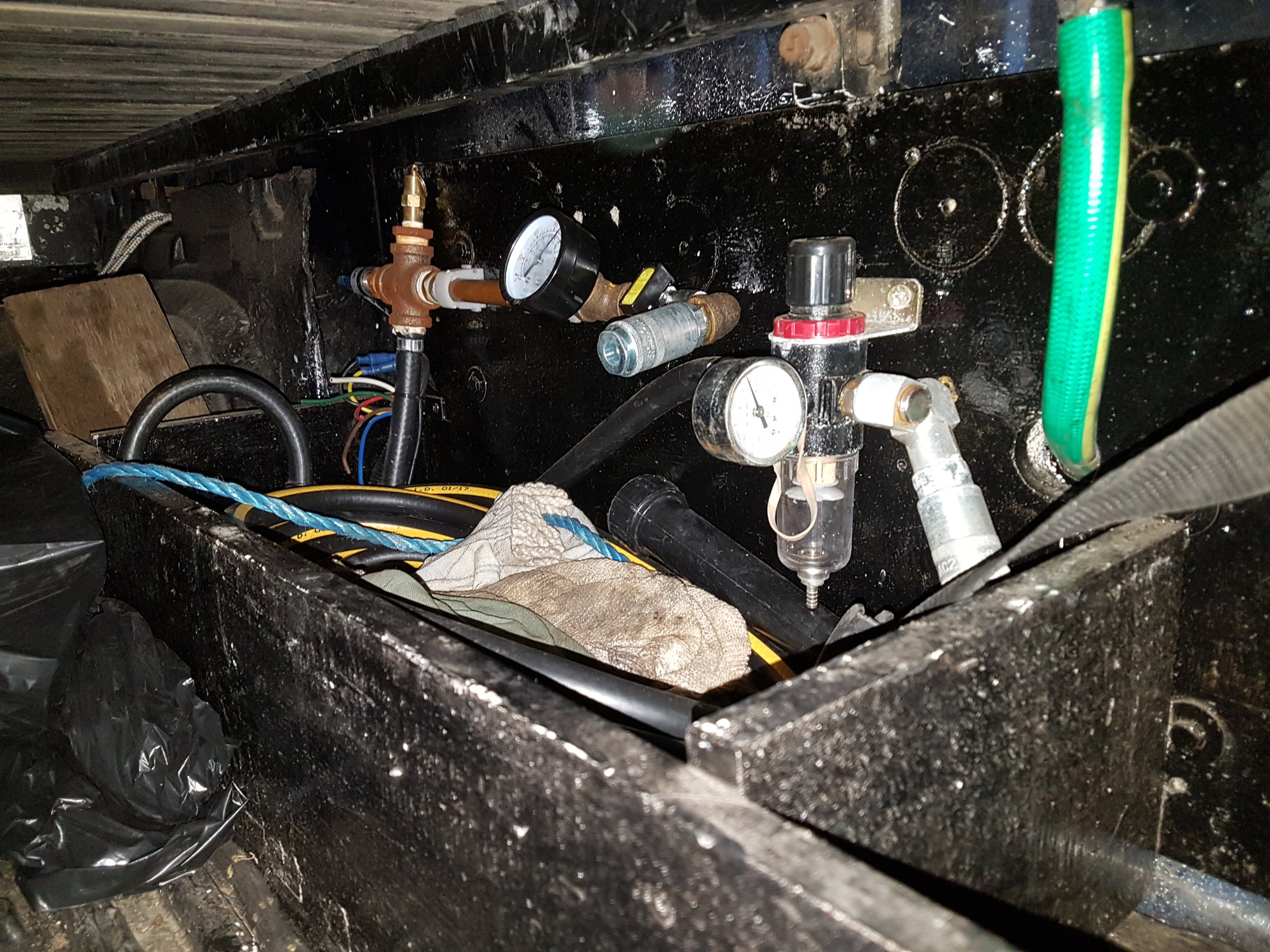

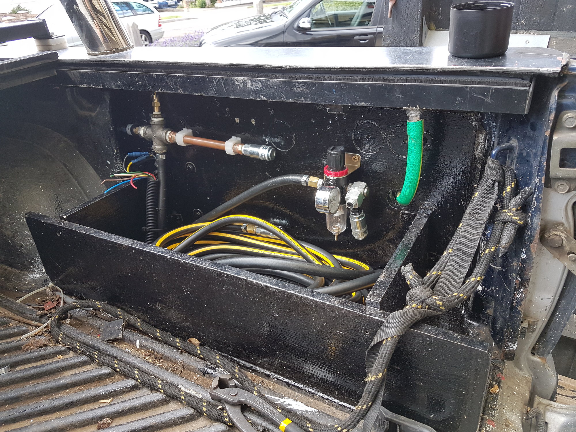

all up and running to fill my 25L tank 0-150psi in 30 seconds
